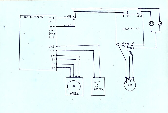

**Diagram of wiring connection's**
 ![IMG_3294](https://europe1.discourse-cdn.com/arduino/original/4X/c/6/b/c6b0e50bdad9ea780b91ca862c8f8a7fb93af2fc.jpeg)
All hardwares are connected as per this diagram.

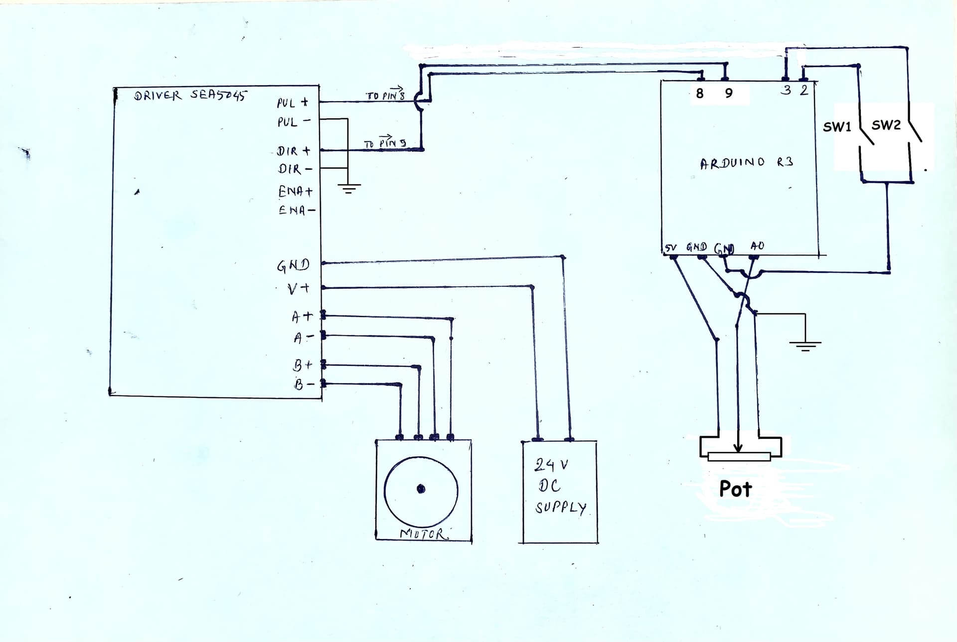

Thanks for the diagram
I have edited you diag, you need gnd connections to the two inputs on the stepper driver.
 ![IMG_3294edit](https://europe1.discourse-cdn.com/arduino/original/4X/d/8/0/d804b4b2cb6793593cee449eaf6077ed2e5abdbe.jpeg)

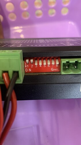

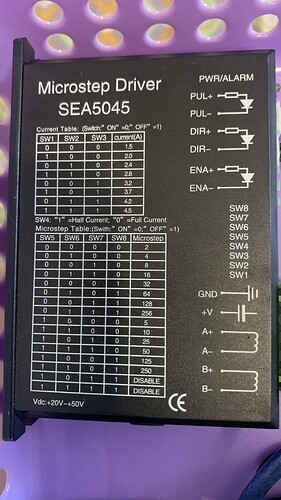

Hi TomGeorge & gcjr,
This is my micro step driver settings. Pls check the dip switch (SW1 ~ SW8) settings. Is it correct?
 ![IMG_3299](https://europe1.discourse-cdn.com/arduino/original/4X/f/e/8/fe873f4015f44cc60898b66ea07f12341437bcfe.jpeg)
 ![IMG_3300](https://europe1.discourse-cdn.com/arduino/original/4X/f/4/3/f43fd3f41f5fbfa712a173a561f62b4540c8ed56.jpeg)
I am using GT3 belt and pulley. And the head has to move from one side to another by 1500mm

> [@shenolkar](#):
The motor current is set to 2.8 Amps, microsteps to 2 or 400 steps per revolution (for a 200 step motor).
Assuming GT3 means the tooth pitch is 3mm, how many teeth on the pully?
