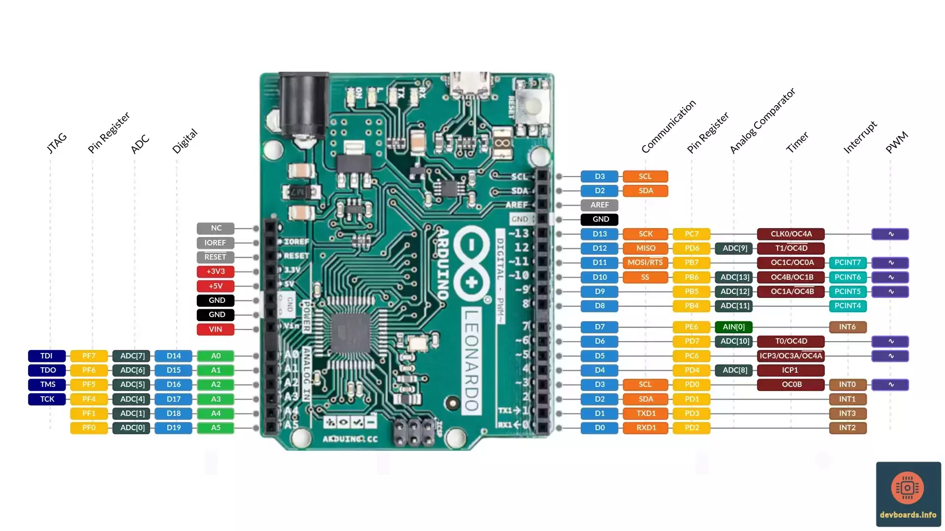

> [@thissiteisstupid](#):
> Speaking of which why do projects use A4 A5?)
On Uno R3, A4 & A5 are the i2c pins because Uno has an ATmega328 chip, and on that chip, they are dual function. They can be used as either A4 & A5 analog inputs, or they can be used as SCL & SDA i2c pins. But not both at the same time.
 ![Pinout-UNOrev3_latest (1)](https://europe1.discourse-cdn.com/arduino/original/4X/3/6/8/368f104d5fae3c6ec4fc11f2d10194357a7217db.png)
On other Arduino boards which use other chips, things will be different. Look at Leonardo, for example. That uses an ATmega32u4 chip. On that chip, the i2c pins are completely different.
 ![arduino-leonardo-pinout](https://europe1.discourse-cdn.com/arduino/original/4X/9/0/a/90a145533fcd121b3b9a16da6a86db8304ec6a96.webp)
But both Uno R3 and Leonardo can share the same shields, at least for the ones that use i2c. It works because those 2 pins, at the top-right of the board, are always i2c regardless of the chip used.
