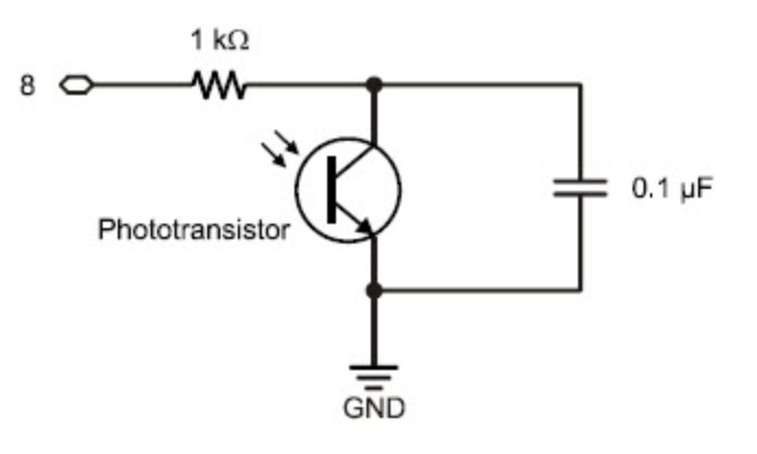

Post the circuit attached to the input output pin.
The code appears to charge a capacitor, then wait while it discharges. The while statement waits until the voltage falls below a threshold. The changing of the pin type, charging and discharging and reading and writing all…
depend on hardware details. What hardware are you running the equivalent Python on, and to what type of I/O port are you hooking you circuitry?
Post the circuit of your experiment.
a7
Below is the circuit:
And yes that is exactly what it does, it charges and discharges the capacitor while counting the time between. The time then corresponds to more and less light. This works very well for me on an Arduino.

There is an internal pullup resistor on the I/0 pin, outputting HIGH to an input port activates the internal pullup, outputting LOW deactivates it.
The capacitor is discharged through the phototransistor, the input port is high-impedance.

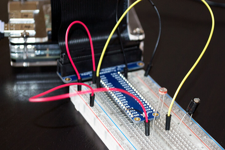

So I tried the code from PiMyLifeUp and it runs, but doesn't give any results that make sense. I think this is mainly due to the fact that I am using a phototransistor and their example uses an LDR. In addition the circuit does not include any type of resistor.
I also tried your guess and I did get different output, but nothing that made any sense. I found this resource online that is pretty helpful on conversion between Arduino and CircuitPython library here. I am going to keep trying a few things, but wanted to give an update.

I did it! Not sure if this will help anyone, but here is the code:
# include CircuitPython libraries
from digitalio import DigitalInOut, Direction
from board import *
import time
port = D17
#Declaring pin 18 as output
sensor = DigitalInOut(port)
while True:
    sensor.direction = Direction.OUTPUT
    #Charging capacitor by setting pin to HIGH
    sensor.value = True
    #Wait for 1 millisecond
    time.sleep(0.001)
    #Declaring pin 18 as input
    sensor.direction = Direction.INPUT
    #mark the time
    now = time.monotonic()
    # wait for value to be False (transition to low input)
    while sensor.value:
        pass
    print('time ' + str(time.monotonic() - now) + ' s')
    time.sleep(1)
