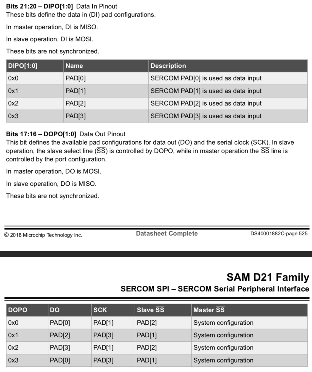

I's setting up my 1st SPI on an Arduino M0. I wish to use SERCOM1 (not alt). I've read table 7.1 from the Atmel datasheet and believe I understand it.
I think I understand all the SPI initialization/creation parameters except for "PAD_SPI_TX" and "PAD_SPI_RX"
I've read the SERCOM.h for this board and see the enums (shown below) but for the life of me I cannot extract the meaning of these parameters ( PAD_SPI_TX, PAD_SPI_RX) which makes it hard to select a value to initialize the SPI.
Any help would be appreciated.
Thanks
John

from SERCOM.h
typedef enum
	SERCOM_RX_PAD_0 = 0,
	SERCOM_RX_PAD_1,
	SERCOM_RX_PAD_2,
	SERCOM_RX_PAD_3
} SercomRXPad;
typedef enum
	SPI_PAD_0_SCK_1 = 0,
	SPI_PAD_2_SCK_3,
	SPI_PAD_3_SCK_1,
	SPI_PAD_0_SCK_3
} SercomSpiTXPad;
It's in the SAMD21 datasheet. the values don't seem to have much sense to them, they're just "alternative pinouts", some of which don't seem to make much sense, and none of which have good names :frowning:
Thank you :slight_smile: With the table you referenced I was able to understand the parameters. However I've not yet been able to get the SPI to work.
John
