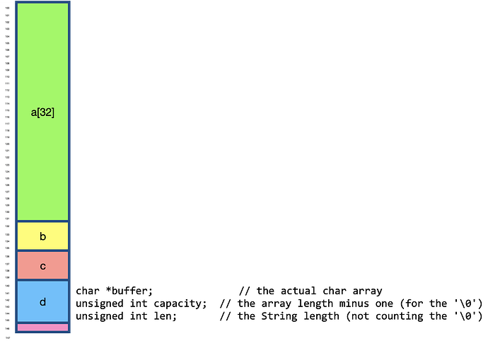

Hello Everybody. I am new.
Can anyone help explain? I am baffled by a section of the code found at [Getting Started with ESP-NOW (ESP8266 NodeMCU with Arduino IDE) | Random Nerd Tutorials](https://randomnerdtutorials.com/esp-now-esp8266-nodemcu-arduino-ide/) The code is run without modification, but not as expected. Just need to enter the mac address and compile.
```arduino
typedef struct struct_message {
  char a[32];
  int b;
  float c;
  String d;
  bool e;
} struct_message;
It defines the above structure. Inside that structure is a String type. a) In use the structure seems to stay the same size, 56 bytes, despite having a dynamically sized member. b) The string may be filled with any number (tried up to 200) of chars and returned with a serial.print(). c) the message is sent as expected and printed by the receiver, only up to 10 chars. 11 or more breaks the receiver and an empty string is printed, even though it was fine on the sender. d) it does not "overrun" the bool after it in the structure.
so, I ask:
1. How does this even work? Wouldn't the structures on both sides need to have defined lengths to line up and unpack properly at the other end?
2. How does the String member get packed into the structure if it is dynamically allocated and expandable? I expanded it with the loop that added a character with every iteration. It works on the sender and can be printed to serial. I can fill it with hundreds of chars and still get 56 bytes from sizeof(myData).
3. As stated, when I access myData.d directly I get all the data. When I send the entire structure (56 bytes??) all data remains intact except for myData.d which behaves properly until 11 chars. At 11 chars it is received blank Try the examples, make the string "12345678901" and it fails to receive. Why? and Why 10 chars specifically? Data placed after it in the structure is unaffected.
I have been at this for to days, so I am reaching out. Hello by the way. It's my first post.
Rick.

Welcome to the forum
In the struct d is an object of the String class. Rather than being the text that holds, d is a container for it and that text is not actually in the struct. As a result the struct itself has a fixed size
Please post your 2 sketches, using code tags when you do

> [@rick3939](#):
> - How does the String member get packed into the structure if it is dynamically allocated and expandable? I expanded it with the loop that added a character with every iteration. It works on the sender and can be printed to serial. I can fill it with hundreds of chars and still get 56 bytes from sizeof(myData).
what gets packed in the struct is the pointer to the dynamic area (on the heap) where the text is kept. Your structure is therefore not flat anymore.
When you send the structure, you just send the pointer address and not the content, and obviously the receiver can't do anything with that pointer.

I can't see how that code is supposed to work, the only way I can see it did in their test is down to luck.
I guess what they did is load the sender sketch, and then load the receiver sketch. Since both sketches use the same variables, the memory allocation is the same for both sketches. So when the receiver sketch de-references the String pointer, it will point to the memory that was initialized when the sender sketch was loaded.

> [@rick3939](#):
> For this to work don't all elements in the structure have to be of fixed size?
Yes, and they are all of a fixed size. However, as has been pointed out the String is held as a pointer to the data and so is more than likely not consistent at both ends of the link
An array of chars is a much better solution even if t0eh String worked

I was unclear. I obviously meant the value of the pointer to the cstring that is held as part of the String class within the struct
if you have
```arduino
  char a[32];
  int b;
  float c;
  String d;
  bool e;
} struct_message;
d is a String instance (on a UNO sizeof(String) is 6)
the memory representation is something like this (assuming packed)
 ![image](https://europe1.discourse-cdn.com/arduino/original/4X/4/7/2/4729c5fafb81c17e2f8af4eaa75219adf337cf3b.png)
and so the first entry is actually a pointer (the address of some other region in memory) to the Heap where the data actually lives.
 ![image](https://europe1.discourse-cdn.com/arduino/original/4X/f/5/2/f52ee5f97f5517e8df46796fa8c81731dc1be30b.png)
> [@rick3939](#):
> It did send the actual string data, not a pointer, up until 11 chars was too much. Then nothing in the string.
There was something else at play that tricked you into believing it was working.

> [@horace](#):
> ```arduino
> struct __attribute__ ((packed)) Data {
> int16_t seq; // sequence number
> int32_t distance;
> float voltage;
> char text[50];
> } data = { 0, 56, 3.14159, "hello test" }; // sample data
this is flat in memory (consecutive bytes) so there is no problem
the issue is when you have a non trivial data type with the actual values not being stored in the same place.
Sending such structures requires serialising and unserializing the data
