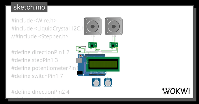

Help with 2 steppermotors controlled by potentiometers
Hi forummembers,
I'm new here on the forum. I have some experience with Arduino. I have the following problem. Maybe someone can help me. I have a controller with 2 stepper motors. They each have their TB6600 as a driver. Each motor has its own on/off switch and its own 10K potentiometer to control the speed. The speed of the motors is displayed on the screen from 0-100%. The system works very well except that the 2 potentiometers affect each other. If I adjust one, then both motors accelerate or decelerate. When I work with only one motor, everything is as it should be. The connections have been checked multiple times and I can't find any errors in them. Can someone help me figure out how to fix this problem? Thank you for any input!!

Your code looks ok. See in the simulator.
Works for me.

We really need to see your circuit and how the pots are connected.

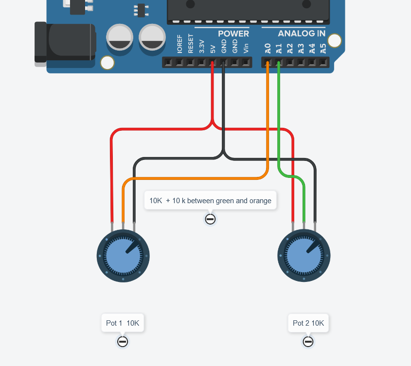

Hello forum members,
I think I have found a solution.
The issue was with the potentiometers.
The values of the 2 wipers were being summed together.
If one potentiometer was at, for example, 7k and the other at 5k, then there would be 12k between the 2 wipers. In that manner, they were influencing each other.
Naturally, the Arduino would react incorrectly to this.
This was due to the way they were connected to the Arduino.
Tomorrow, back at the workshop, I will connect them only between the Vcc and the wipers.
Hopefully, this should work.
Regards, Michel

Do you have your pots wired up just like that Wokwi sim? With nothing but the wipers connected?
If that's the case, they are just floating inputs and will give random results.
The GNDs on the pots should be connected to the GND pin and their VCCs should be connected to the 5V pin. Like this:

your diagram doesnt show the motors and drivers. We are still guessing.
Hi forummembers,
I managed to get my project working. The goal was to control 2 stepper motors separately using potentiometers.
On the display, I needed to see the speed of both motors, ranging from 0-100%.
The speed wasn't crucial. The idea was for motor 2 to spin faster than motor 1 (to stretch a synthetic thread).
In the attachment, you can find my code as well as a link to Wokwi.

// motor 2
#define directionPin2 2
#define stepPin2 3
#define enPin2 4
#define switchPin1 6  //toggle switch motor 2  on   oranje
#define switchPin2 5  //toggle switch motor 2  off  Bruin
#define potentiometerPin2 A1
AccelStepper stepper2(AccelStepper::DRIVER, stepPin2, directionPin2);
// MOTOR 1
#define directionPin1 7
#define stepPin1 9
#define enPin1 8
#define switchPin3 11  // toggle switch motor 1 on  Blauw
#define switchPin4 10  // toggle switch motor 1 off  Groen
#define potentiometerPin1 A0
AccelStepper stepper1(AccelStepper::DRIVER, stepPin1, directionPin1);
int previousPotValue1 = 0;
int previousPotValue2 = 0;
bool motor1Running = false;
bool motor2Running = false;
  lcd.init();
  lcd.backlight();
  lcd.clear();
  lcd.setCursor(0, 0);
  lcd.print("    Stretcher  ");
  lcd.setCursor(0, 1 );
  lcd.print("Made WE62 Ugent");
  delay(6000);
  lcd.clear();
  lcd.print("Speed M1: ");
  lcd.setCursor(13, 0);
  lcd.print("  % ");
  lcd.setCursor(0, 1);
  lcd.print("Speed M2: ");
  lcd.setCursor(13, 1);
  lcd.print("  % ");
  pinMode(switchPin1, INPUT);  // Schakelaar 1 heeft een pull-up weerstand
  pinMode(switchPin2, INPUT);  // Schakelaar 2 heeft een pull-up weerstand
  pinMode(switchPin3, INPUT);  // Schakelaar 3 heeft een pull-up weerstand
  pinMode(switchPin4, INPUT);  // Schakelaar 4 heeft een pull-up weerstand
  pinMode(directionPin1, OUTPUT);
  pinMode(stepPin1, OUTPUT);
  pinMode(enPin1, OUTPUT);
  digitalWrite(directionPin1, HIGH);
  digitalWrite(enPin1, HIGH);
  pinMode(directionPin2, OUTPUT);
  pinMode(stepPin2, OUTPUT);
  pinMode(enPin2, OUTPUT);
  digitalWrite(directionPin2, LOW);
  digitalWrite(enPin2, HIGH);
  digitalWrite(switchPin1, LOW);  // Schakelaar 1 heeft een pull-up weerstand
  digitalWrite(switchPin2, LOW);  // Schakelaar 1 heeft een pull-up weerstand
  digitalWrite(switchPin3, LOW);  // Schakelaar 1 heeft een pull-up weerstand
  digitalWrite(switchPin4, LOW);  // Schakelaar 1 heeft een pull-up weerstand
  stepper1.setMaxSpeed(4000);  // Set max speed in steps per second
  stepper2.setMaxSpeed(4000);
  stepper1.setAcceleration(500);  // Set acceleration in steps per second^2
  stepper2.setAcceleration(500);
  stepper1.setCurrentPosition(0);
  stepper2.setCurrentPosition(0);
void updateLCD(float speedPercent, int motor) {
  lcd.setCursor(10, motor);
  lcd.print(speedPercent, 0);
  lcd.print(" ");
  // Controleer de status van de toggle switches voor motor 2
  if (digitalRead(switchPin1) == HIGH) {  // start motor 2
    motor2Running = true;
    digitalWrite(enPin2, LOW);
  } else if (digitalRead(switchPin2) == HIGH) {  // start motor 2
    Serial.println(switchPin2);
  // Controleer de status van de toggle switches voor motor 1
  if (digitalRead(switchPin3) == HIGH) {  // start motor 1
    motor1Running = true;
    digitalWrite(enPin1, LOW);
  } else if (digitalRead(switchPin4) == HIGH) {  // stop motor 1
  // Steppermotor 1
  if (motor1Running) {
    int potValue1 = analogRead(potentiometerPin1);
    float speedPercent1 = map(potValue1, 0, 1023, 100, 1);
    if (abs(potValue1 - previousPotValue1) > 10) {
      updateLCD(speedPercent1, 0);
      previousPotValue1 = potValue1;
    int speed1 = map(potValue1, 1023, 0, 0, 4000);  // Map potentiometer value to speed
    stepper1.setSpeed(speed1);
    stepper1.runSpeed();
    stepper1.stop();
  // Stepper motor 2
  if (digitalRead(switchPin2) == LOW) {
    int potValue2 = analogRead(potentiometerPin2);
    float speedPercent2 = map(potValue2, 0, 1023, 100, 1);
    if (abs(potValue2 - previousPotValue2) > 10) {
      updateLCD(speedPercent2, 1);
      previousPotValue2 = potValue2;
    int speed2 = map(potValue2, 1023, 0, 0, 4000);  // Map potentiometer value to speed
    stepper2.setSpeed(speed2);
    stepper2.runSpeed();
    stepper2.stop();
