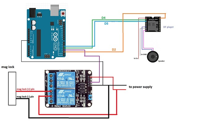

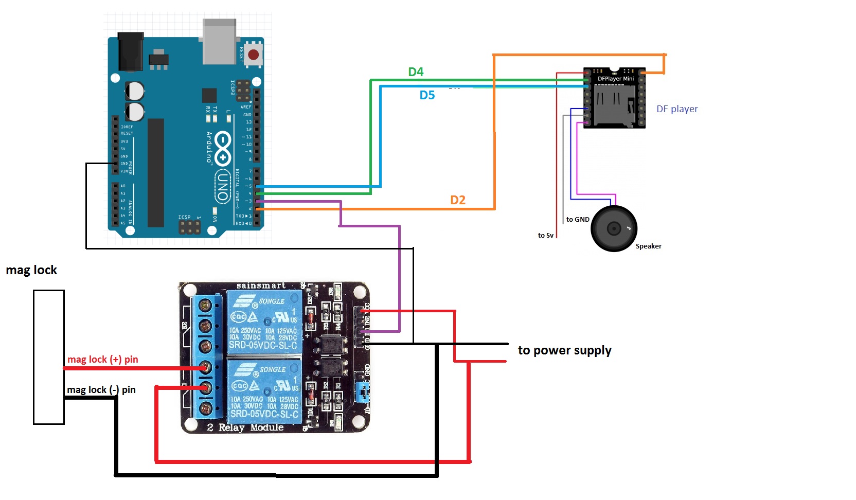

Hi everyone,
I was hoping to not have to resort to this, as I really like to figure stuff out on my own, but I am embarrassed to say that my coding skills are slim to none at this point and still very much in development! I am not new to electrical and electronics in general, but I do not have much experience with coding the arduino. That being said, I have a project that someone (who is definitely more versed than I am) helped me write. With a 4x3 matrix keypad and DFPlayer Mini connected as per the attached diagrams, the final code (which I have also attached) is supposed to allow someone to enter a 4-digit code to activate a relay for 2.5 seconds (this part of the code works fine) and also, if a DIFFERENT 3-digit code is entered, play an mp3 from the DFPlayer Mini (this is the part I am having trouble with). When the final code is uploaded to the board, the serial monitor displays:
i 255

My goal was to have the mp3 track play ONCE for every time the correct 3-digit activation code was entered. Can anyone help me to identify the troublesome or missing element?? Thank you in advance for your help!
final_code.ino (5.61 KB)
SoftwareSerial secondarySerial(5, 4); // RX, TX
Can you post a picture of the secondarySerial that you have attached to the Arduino? If what you have attached isn't a "secondarySerial", explain the dumb name.
