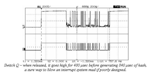

From your code, I have understood that you are triggering INTO interrupt at the falling edge of the incoming interrupting signal. If it would be my project, I would think to employ a hardware non-retriggerable one shot circuit instead of time delay to over come the bouncing times of the interrupting device.
Figure-1: Hardware debounce circuit
Functional Description: When K1 is closed at time t1, the signal-A goes LOW and then after a while the bouncing of the button begins which lasts for about 25 ms before the button makes the final sit. At the very first low-going edge of signal-A (at time t1), the signal-B assumes HIGH state and remains HIGH during the whole bouncing times of K1 (because 74LS221 is a non-retriggering one shot, it does not respond to the bouncing transitions of K1). At time t2, the signal-B makes a transition from HIGH to LOW; as a result, the MCU is interrupted only once. The pulse width of signal-B (tw) is about: 0.7R1C1 = 0.7*4.7x1031010-6 ~= 33 ms (>25 ms).
Reference: (extracted from here)
Figure-2: Bouncing phenomenon
