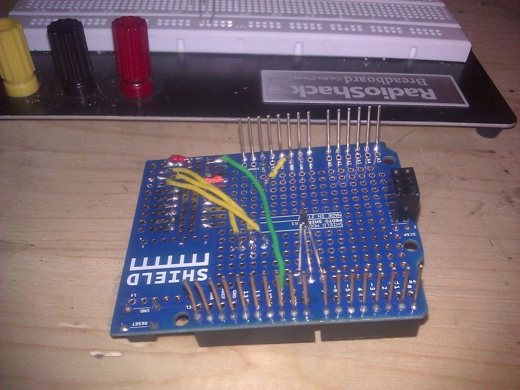

This may or may not work:
The funk behind the curtain:
I think I would have been better off orienting the 85 the other way to keep wires from crossing. Maybe it won't be a problem. I ganged the LED's to ground with a single resistor which is something I've been doing, May not be such a good idea though...
Yea, it was fun to make no matter the outcome :)
This is my first "hard wired" arduino project. I'll post back about how it works.
Still a few hiccups...
When I hit the reset button on the board I get a light sequence from the LEDs installed on the protoshield. Each flash quickly in turn so something seems to be working.
I went through the same sequence as before and now I get a red blink when uploading and some synch errors. I got some of the "nuisance" errors before but it doesn't seem to be working.
I was trying a different chip this time though and I had tried to do the bootload on it without success before and it doesn't seem to be working now either.
I may try loading a sketch onto the chip I had working earlier and see how it goes.
I did the usual continuity checks, etc. plus triple, triple checked the wiring and all seems OK. I have a sneaky feeling I'm forgetting to do something that I did right before but d@mned if I can figure out what it is :roll_eyes:
Seems like I used the sketch from post 39 : http://arduino.cc/forum/index.php/topic,108797.30.html
Strange, I went back to the breadboard with my original setup and I can't duplicate earlier success... I'm getting the "avrdude PAGEL BS2" and "protocol error" errors after burn bootloader and uploading the blink sketch which I believe are just nuisance errors but no blink...
One thing I'm not sure about is if the capacitor is needed for "burn bootloader"? And will it damage the chip if I burn it more than once. Earlier I managed to load several different sketches onto the 85 without any problems but after putting this shield together things are a little wonky...
I suppose I need to troubleshoot the pins on the arduino which are used to program the 85. I may have damaged them. I figure if I can get pins 11, 12 and 13 to blink an LED then all is well on that front.
Thanks again for all the help. It's just a little frustrating that I can't get it to work again...
Well, the pins seem to be working. I can still blink LEDs on 11, 12 and 13.
Triple checked the wiring again:
Pin 10 on Arduino to pin 1 on 85 :blush:
All is well again... Looks like my oscillator or something is screwy because it blinks every 7 seconds or so. I'm pretty sure I loaded 8mhz but I was pretty sure I had it wired correctly too...

From my shield, the connections are: Uno D7 - activity LED Uno D8 - error LED Uno D9 - pulse LED Uno D10 - ATtiny85 pin 1 (reset) Uno D11 - ATtiny85 pin 5 Uno D12 - ATtiny85 pin 6 Uno D13 - ATtiny85 pin 7 5V - ATtiny85 pin 8 GND - ATtiny85 pin 4 And that 10uF cap between 5V and the Uno reset.
Sounds like you've got it all setup that way though.
