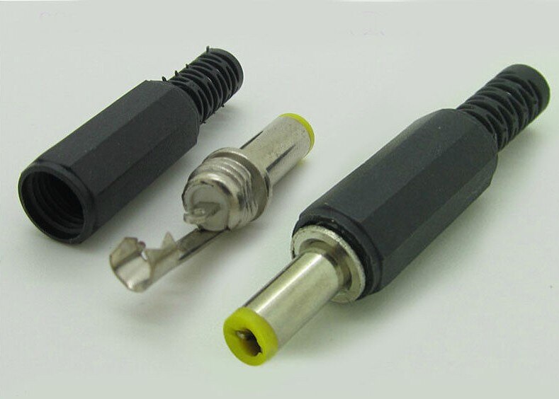

These small DC barrel connectors are only specd/ reliable for about 2A+ in a long term installation.
Hi! Thanks for your reply. In that case how do you recommend I connect a power supply to my servo? Is there a power supply that I could wire directly to my servo with out a jack adapter?
Soldering is one solution. Screw block connector is another.
For example, do you think a power supply like this that comes with a female terminal connector would work?
I can’t see your US product page, but if it’s the same one I can find, the DC output is still running through a small 2.x mm barrel jack.
That’s what you have to get rid of.
Cut it off, or buy a real closed-frame regulated DC power supply like MeanWell, Lambda or similar.
They don’t have flimsy plugs, you have to strip wires and screw them in.
You will have a lot more success if You drop the plug and play thinking. Learn soldering or how to connect thick wires on Your own.
Female terminal connectors uses a number of different dimensions and very often they don't fit. And, as already told, they are not designed for currents higher than a few amps.

So why do they sell power supplies rated for 6 or 7 Amps using these connectors as found on virtually all PCs in the USFF)? :astonished:
Good question. In sales brochures, they're rated from 1A to 10A (!)
I wouldn't be happy selling them for anything over 2A, but some 'good' ones might hold up. Get a bit of corrosion or contact resistance - and keep the extinguisher nearby !
Take a look at the connector data sheets for the actual connector you're using.
Most laptops don't use 2.x mm jacks, they're a slightly different product (don't know the brand / model)
(I bought a new i7 HP SFF 19V @ 4A) literally yesterday, and it has a barrel connector - not a 2.xx mil version. I do admit, I wasn't thrilled. My previous Lenovo had a much chunkier proprietary barrel)
Go for it if you're keen, I've seen a few cheap laptops with heat damaged 2.xx barrel connectors.
Depending on what the 2.x mm is. Laptops - the small ones at least - use a much smaller jack. :grin:
My old but reliable ACER Veriton USFF machines have the standard sized - 2.1 mm "barrel" jack for their 19 V 7.1 A power "bricks". No problems for a dozen machines in many years as I recall.
One point though - the line socket on the power supply is not a simple sleeve for the positive but is a spring clip.
