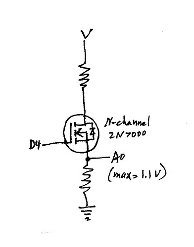

Thank you for the clarification! What I'm specifically looking for is a way to monitor the battery voltage directly to ensure proper battery management, such as checking the charge level or determining when the battery is running low.
I'm considering adding a voltage divider circuit between the battery and an ADC pin on the ESP32-C3 to read the battery voltage. Do you have any suggestions or recommended circuits for this purpose?
Also, any advice on best practices for safely monitoring the battery voltage without significantly draining the battery would be really helpful!

Well, opinions differ on how to do the voltage divider. One school says to just use very high value resistors, with a capacitor on the analog input, and it will work fine for this purpose without drawing enough power to make much of a difference.
The other school says to put in a mosfet that can be switched on only when you need to take a battery reading, but which draws zero current otherwise.
For something like this, you can probably select the internal 1.1V bandgap voltage as the reference, and divide down the maximum battery voltage to 1.1V. Then as the battery discharges, the ADC reading would decline from there. You would need to calibrate it though since the 1.1V actually varies from chip to chip.
In that setup, you could insert an N-channel mosfet between the two divider resistors, with its gate powered from an ESP GPIO, and its source being the tap for the ADC input. Like this:
Even though the mosfet source can be as high as 1.1V, 3.3V at its gate should still be enough to turn it on enough to get a good reading.
