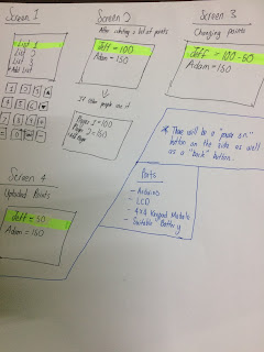

This is my skecth of my project
Since I could not upload the picture here is a link The image

Will the code that I use be the same(from earlier post) or would it be diffrent.IF it is diffrent could you give me a basic image or example of the code.
OP's image from Reply #23. See this Simple Image Guide

It is hard to make sense of your image but it seems to have a screen and a keypad. Is that what you have in mind?
Have you identified the specific screen and keypad that you will be using? If so please post links to their datasheets.
Now that you can see how to post images it would be easier to read them if you post a separate image for each screen display that you have in mind.
