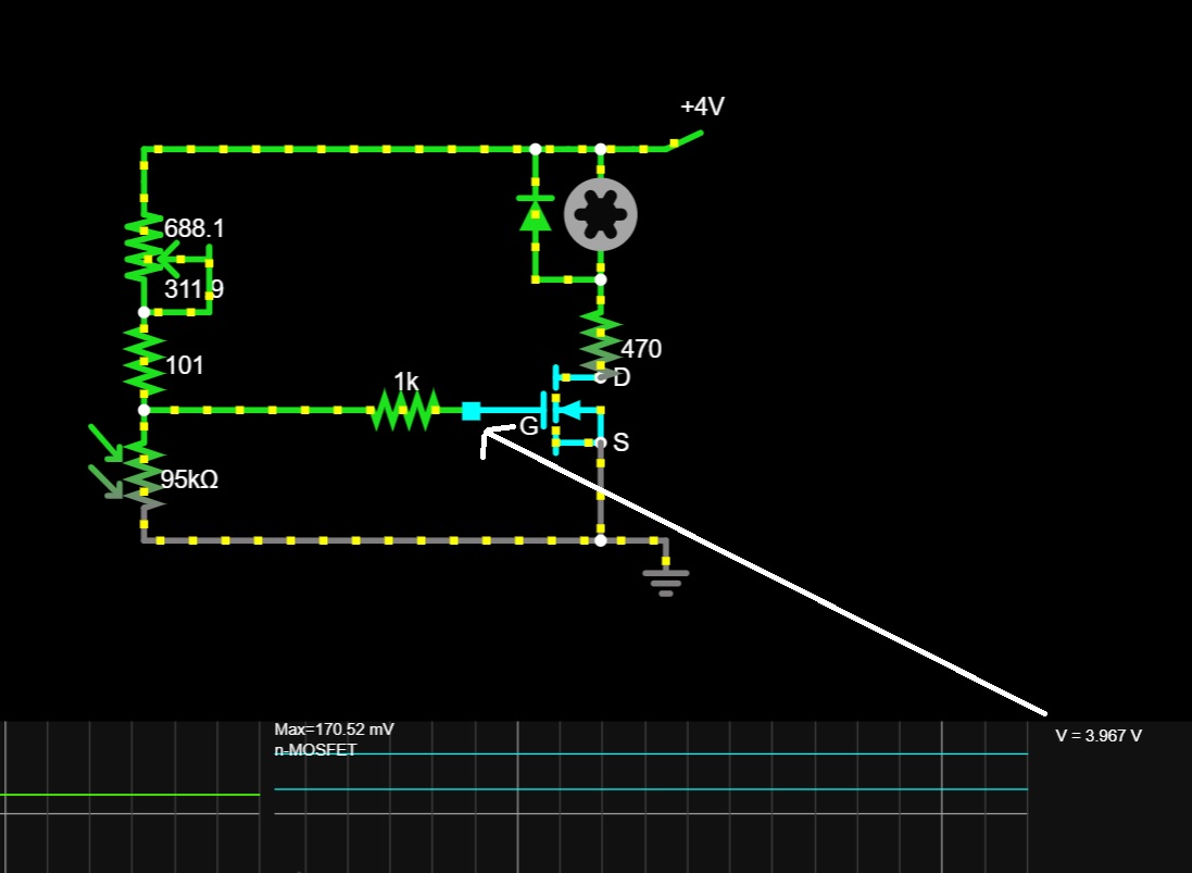

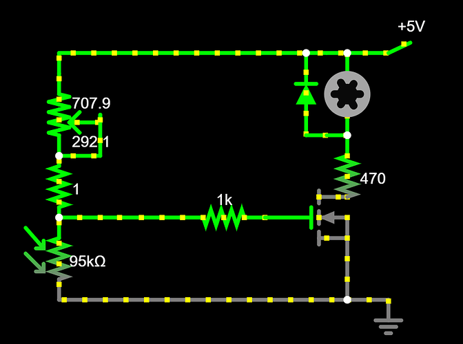

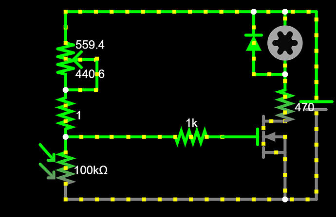

I'm trying to build simple line-following car using mosfet and ldr
in the sim, the drain source is always open, the ldr and vr doesn't affect the gate.
I tried npn transistor and still getting the same problem.
I'm using irf530
the battery is 3-9v

What is this component inside the red circle?
circuit
it's potentiometer
Will the current that feeds the motor pass through this potentiometer?
What is the motor current and what is the dissipation of this potentiometer?

the pot is part of voltage divider to control the gate voltage which control the point that ldr sense the black line,
the motor current is around 1A when it has load on it
Where is ground tied to the circuit?
Or shall I ask, are you sure a ground path is defined?
What voltage are you applying? IRF530 Vgs th is 4V.

Where are your gnd and 5V supply points?
this is the link to the sim in falstad : https://tinyurl.com/2gulmwwd
What do you expect your circuit to do on the simulation.
Put the mouse cursor on the Gate and read the voltage, do the same on the Drain and the Source
In this case Gate voltage is 3.96Vdc
Your circuit is running, you can see the current flowing down through the MOSFET and the MOTOR, it is faster than the current going down through the LDR and associated resistors.
Change the values around the pot to see what effect it has.
The motor is in series with 470R which will limit the current to about 10mA even if there is no resistance in the other components. I doubt if that is enough to make the motor turn.
