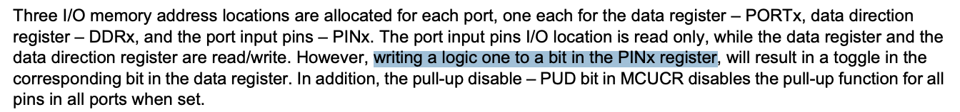

PINx toggles bits:
or
? will first variant toggle only one pin too?
Yes, but it takes more instructions, and a temporary register.
(Because the compiler will produce a single "Set Bit in IO register" instruction for the "|=" version, but the first needs to load 1<<4 into a register and then use an OUTput instruction.)
OTOH, PINB = 0xFF; will toggle ALL the pins in PORTB.

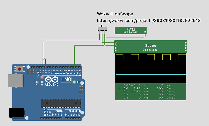

Disabling the TCNT2 = 0; and dropping it into UnoScope - Wokwi ESP32, STM32, Arduino Simulator (and shorting pins 12&13) gives 892 Hz:

See the message #53 - @DaveX already done that. He obtained a right frequency result without your TCNT2 =0; line in the interrupt.
I also did it, not on simulator - but on real Nano board.
I'm sure that this line in the interrupt handler is not needed. I removed it and ran the code with OCR2A = 140 and got the frequency of 887Hz, as it should be.
Then I set OCR2A = 14 and ran the code again - the frequency changes to 8.33 kHz.
Conclusion - if this did not work for you - the reason is not that the CTC does not reset the counter. You probably made a mistake somewhere else - in the code or in the connections
No clear of TCNT needed.
(The previous behavior was all due to the ISR taking too long.)

OK, well I’ll plead ignorance in this case,… I didn’t understand what he was trying to say…
The image shows a Uno board, the caption says it is a simulation program, and he’s shorting together pins 12 and 13… why ?
Once I saw it was a Uno board ( which I am not familiar with ) I pretty much ignored the post, thinking it was not relevant to me.
The Uno and Nano has the same MCU on board - Atmega328, and fully compatible in matter the code.
