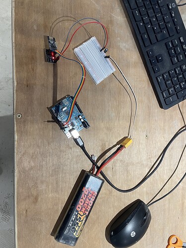

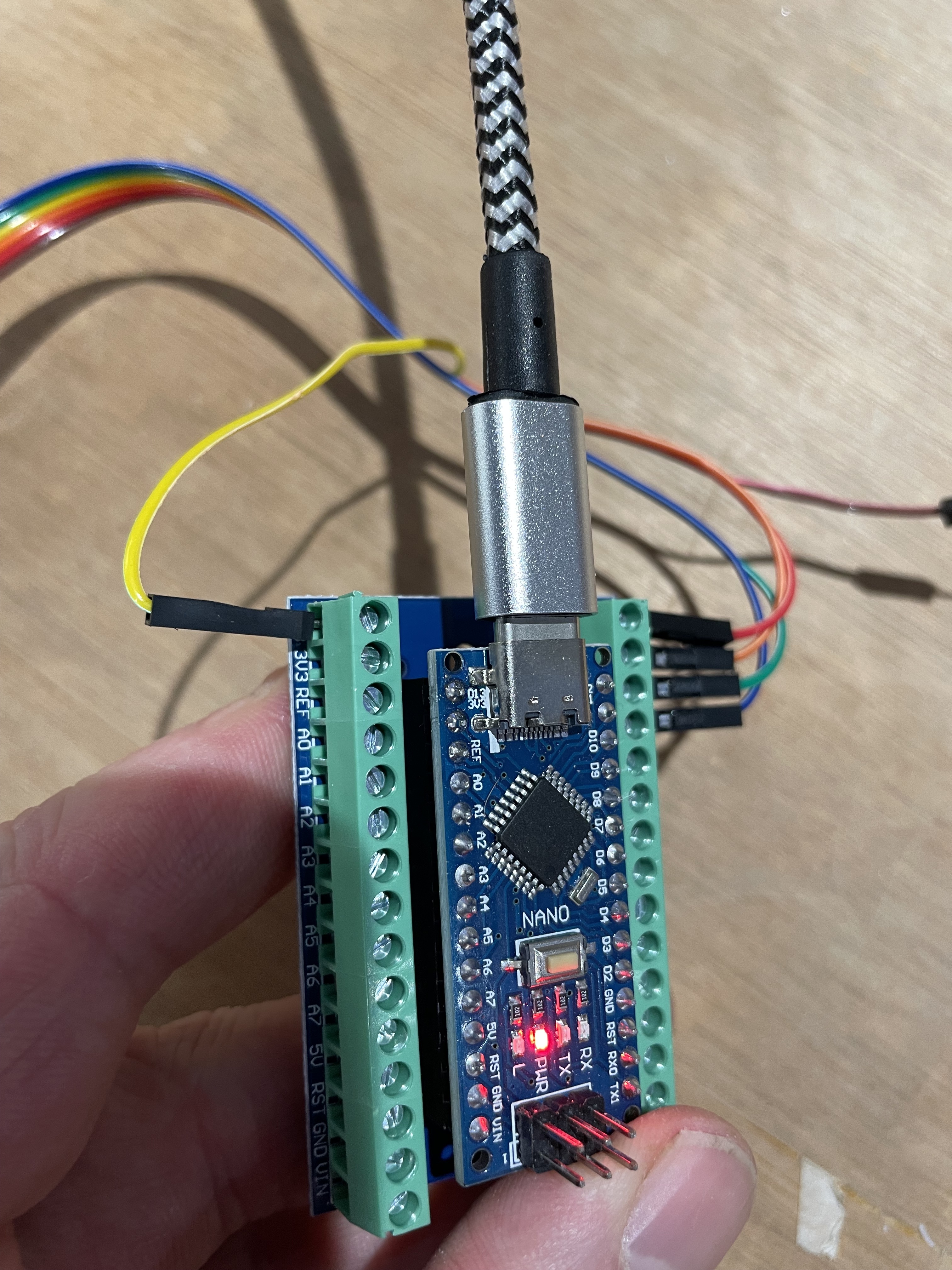

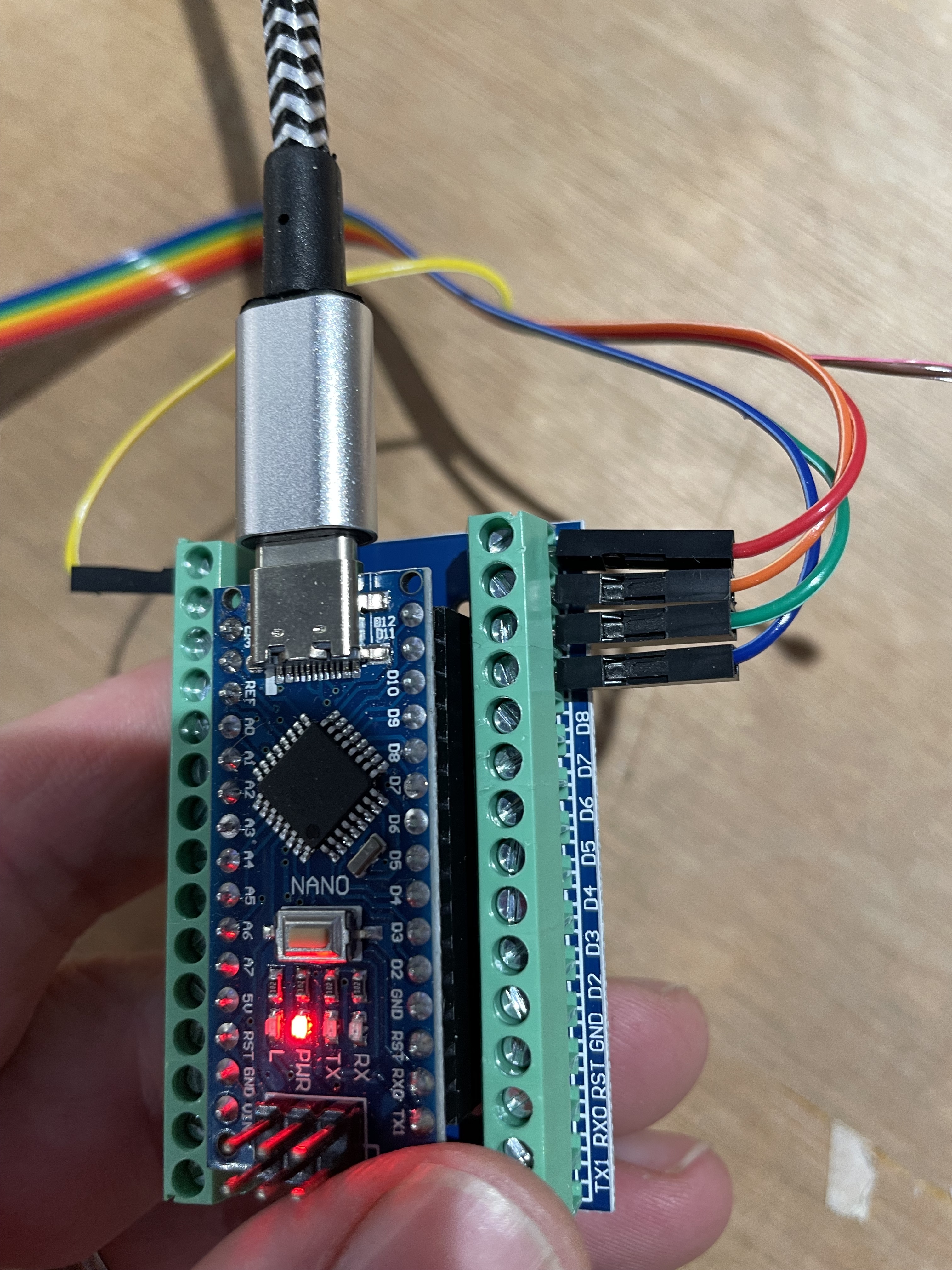

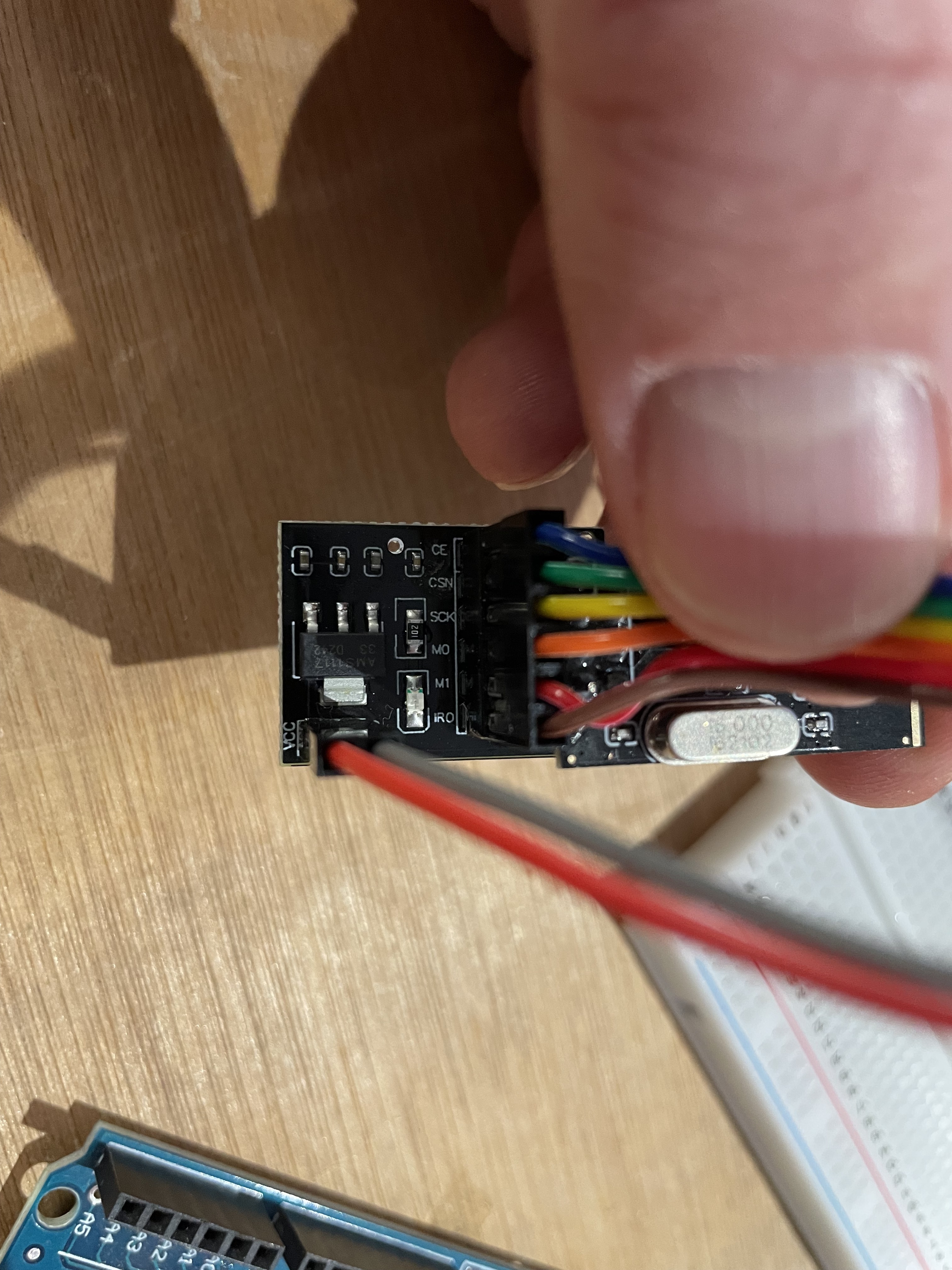

I’ve been trying to get two Nanos with RF24 transceivers to talk to each other.
I’m using the code from Robin2’s post:
When I run the communication test code I only get zeros
Is there anything wrong with my setup? Checked continuity through the wires, tried with Unos and nanos and a combination of both, and I’m stuck. Please help
In the bottom left picture; where's the common ground between your battery pack and the Arduino?
There isn’t one. Arduino is powered by the USB-c cable and the RF24 by the power pack.
Should there be a common ground?
Circuit: an unbroken path that returns to its starting point.
Electrical circuits are the same: electrons flowing out of a particular point need an unbroken path to return to that starting point.
When a signal is sent out any of your SPI pins, there's no path for them to return on.
No circuit, nothing works.
That makes complete sense! Would I be okay powering everything from the battery pack and still having it plugged into the usbc to read the serial monitor?
You run the risk of back feeding your USB port from the battery. There's circuitry on the Uno that's supposed to prevent that, but often it doesn't work due to an incorrect choice of parts.
Just add a connection between the battery's ground and the Uno's ground.

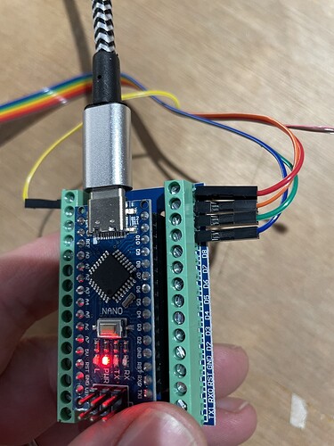

Thanks for your help van_der_decken. I have tried your suggestion and still not getting communication between the two boards, the result of the RF24 test is slightly different but i have no idea what it means

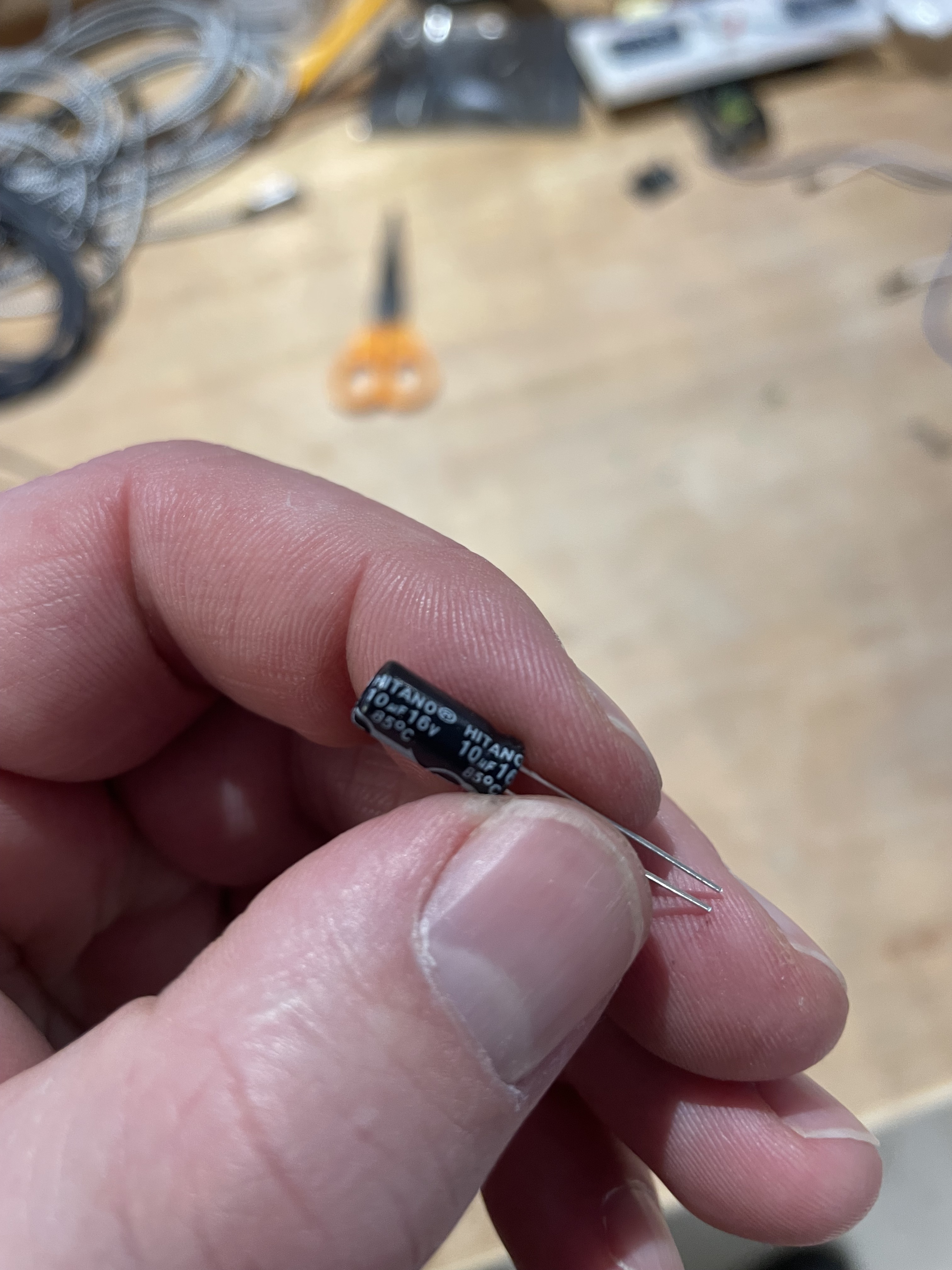

I've also tried removing the power boards from the RF24s and powering direct from the 3.3v pin on the nano (still using the capacitor) but still no luck
any other ideas? the results of the RF24:
