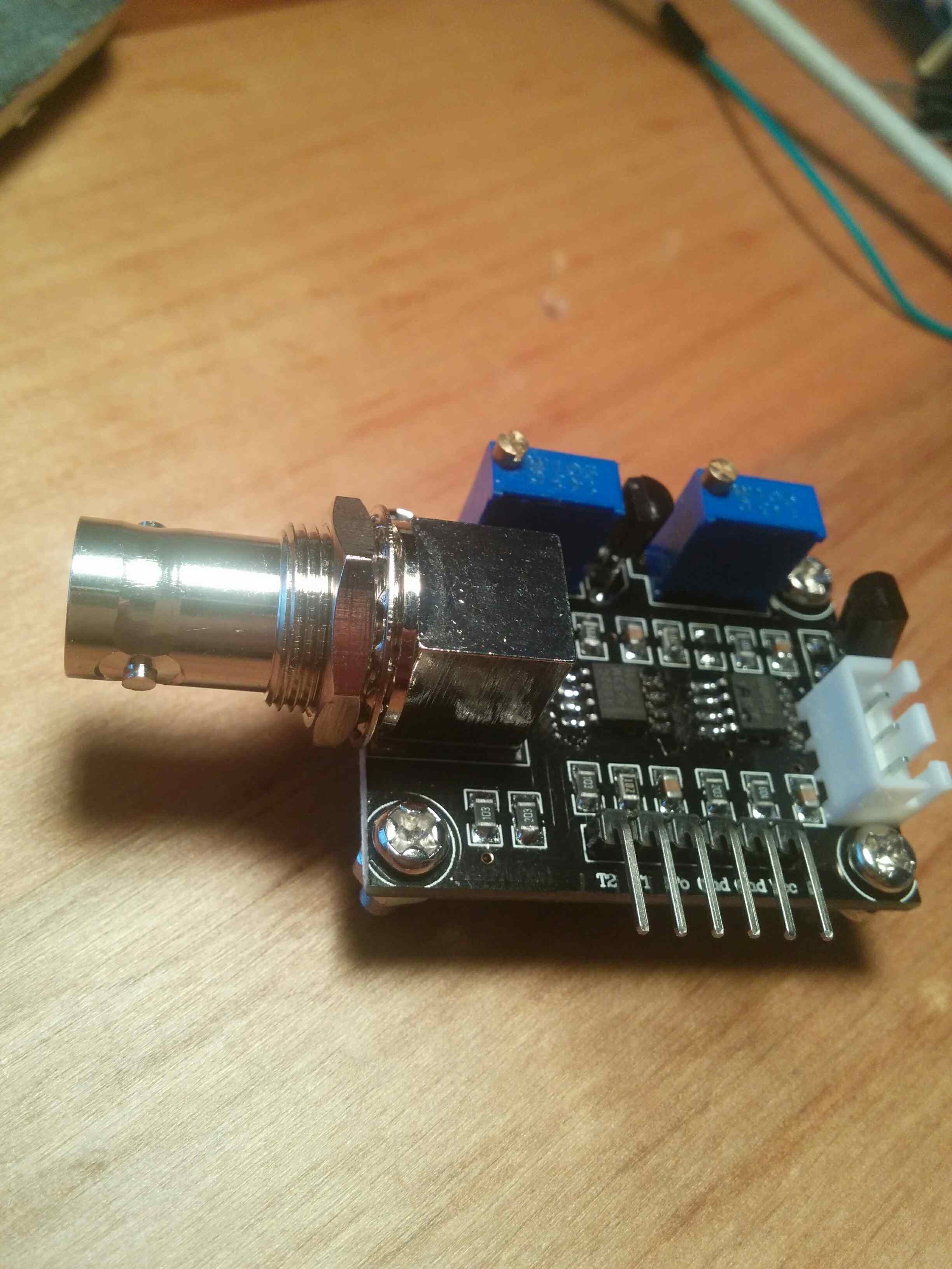

I bought a ph shield for arduino from china and i couldn't find the schematic online. The leads coming out have the following symbols. What do they stand for? I know the second G is ground and v+ is 5 volts. Not sure what the others stand for. Thanks
"To" - "Do" - "Po" - "G" - "G" - "V+"

If the sensor module has an IC on it, look at the datasheet for the IC and try and trace the signals from the IC to the connector. There is usually a direct link, and the IC datasheet will have a full explanation of the signals. If you are lucky they have just called them the same thing.
It also helps if you can include a picture or a part number for the thing you are asking about.

Here is a picture

Please try to decipher the IC IDs yourself, they are unreadable on the photo.
I'd guess that "o" means output, T might stand for temperature, P for Ph.

hello kwood:
As you also buy the same ph sensor module, have spent much time searching the Internet and connect to Arduino without much luck, I managed to locate the manual for this module but the Chinese language, all you have achieved is what econtrar referred to pin:
To temperature 1
Sun: Temperature 2
Po: PH
G: ground data
G: negative or ground voltage
V +: voltage or 5V
It can be connected to analog signal card, will try to SKU #: sen0161 to see if it works I'll be posting more information to be my breakthrough.

Hi all,
First of all, I'm only speaking about the board labelled "[www.auto-crtl.com](http://www.auto-crtl.com)" and "Logo\_PHsensor v1.1". The one with only 6 pins in front of the BNC plug (not on the side) as you can see in image _Pinout1.jpg_.
I also bought this little board from China and it is difficult to make it working. Most topics are related to other boards (Atlas, Sparkfun, Sparky's Widgets, etc.) and nothing is working. And when the subject is speaking about the correct card, the information is incorrect or computation are made with random numbers coming from the sky.
Some words are in italic to avoid "experts" saying it's incorrect (because it is incorrect) but for our small projects and for understanding I intentionaly use those "simple" terms.
General info about pH to know
The pH is a value between 0 (acid) and 14 (basic) with a neutral value of 7.
The curve (log10) of the pH is a mix between linear and exponential as you can see in _pH\_curve.png_. It means that you can _almost_ measure a linear value between 4 and 9 pH. Less than 2 and more than 12 is _almost_ impossible to determine something (too acid or too basic).
The probe is like a (tiny) battery when placed in a liquid. Depending the pH it output a positive or negative voltage of a couple of millivolts. This value is too small and other tech stuff like impedance make it unusable directly with an Arduino that's why you need an "op amp". The op amp board _just convert_ the millivolts of the probe into to something acceptable for Arduino (positive between 0 and 5v).
There are 3 common buffer solutions used for pH measurement: pH 4.01, pH 6.86 and pH 9.18 (7.0 and 10.0 exists). I suggest the powder instead the liquid because it's cheaper, expire after longer and the powder can't be contamined (vs bottle). You should read the product instructions but usually you have to put the content of the bag into 250ml of water and stir. You can use any water with an average pH (6-8) because the powder will _saturate_ the water at the correct pH level. I personnaly use tap water (pH 7.4) and didn't see any difference between distilled, osmosed and demineralized water. Buffers are not stable in the time, this means that you cannot keep the solution for weeks or months.
Board description
- BNC plug: Where you put the probe. It seems to work with any probe with a calibration difference. I tested 3 models (cheap blue, cheap black and a short black from a EC+pH kit).
- Pin To: Should be the temperature but I can't make it works.
- Pin Do: High/Low 3.3v adjustable limit.
- Pin G/GND: Probe ground. It is useful when the ground is not the same as your Arduino. In some circumstances the ground voltage of the liquid to measure can be different.
- Pin G/GND: Power ground (direct from Arduino).
- Pin V+/VCC: Input power 5V DC (direct from Arduino).
- Blue potentiometer close to BNC: pH offset.
- Blue potentiometer close to pins: limit adjustment.
- Black component with 103 printed (not the one between potentiometers): thermistor for temperature compensation.

**Author:** ![JoseAngelRet](https://avatars.discourse-cdn.com/v4/letter/j/2bfe46/32.png) [@JoseAngelRet](https://forum.arduino.cc/u/JoseAngelRet)\
**Post date:** [May 18, 2016, 7:20pm UTC](https://forum.arduino.cc/t/help-with-ph-sensor-pin-abbreviations/323936/18 "2016-05-18T19:20:17Z")
</div>
Hi there,
I bought a ph & temperature shield (E-201-C) from [lei-ci.com](http://lei-ci.com), for arduino from china and i couldn't find the schematic online.
The leads coming out have the following symbols: T2, T1, Po, Gnd, Gnd, Vcc
I Need help to conect to Mega 2560 or Uno r3 shield.
Tal for help.
Compre un sensor de PH y temperatura con placa E-201-C desde [lei-ci.com](http://lei-ci.com).
No puedo encontrar el esquema eléctrico de la placa que tiene 6 pines en el lateral.
necesito ayuda para poder conectar a placa Mega 2560 o UNO R3.
MUCHAS GRACIAS

@JoseAngelRet: Scroll to the description here [Arduino PH Meter Board Only](http://www.mini-kossel.com/Arduino-PH-Board)
