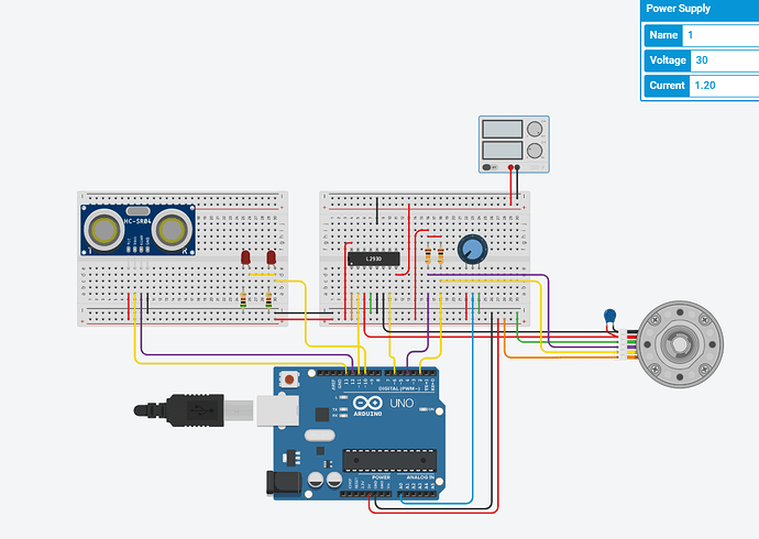

Help with programming. Autonomous Car
Hello, I have written this code as I am simulating an autonomous car(on TINKERCAD) that will stop when it detects a person crossing the road with the HC-SR04 Ultrasonic sensor. I expected this code to stop the car when a duration of 1164 was registered and to start moving again once the person had moved out of the way. I am unsure of how to add hysteresis so when the duration is close to the 1164 value the car doesn't keep braking and accelerating. I was also wondering if there is a way to add a range of values of duration for the car so for example if the duration was between 1164 and 2328 the car would reduce speed instead of moving. I have tried but failed to do this so any pointers in the right direction would be greatly appreciated.

Thank you for properly posting your code !
I don't understand this. Maybe you intended "stopping" instead of "moving".
If 1164 is your threshold, then brake if the car is accelerating AND the duration is under, say 1154 (1164 - 10). Don't accelerate unless you are braking AND the duration is over, say 1174 (1164 + 10). There are some details to work out (such as how to get started) but this is the general idea behind hysteresis. The threshold to be used varies depending upon what the car is doing.
I don't want to provide too much detail in case this is homework or a class project.
Thank you for your reply. I have sorted this problem now, I was adding a much larger difference between the values which resulted in the simulation giving me some error when the object was placed between the thresholds. Thank you again, I really appreciate your help. :slight_smile:
