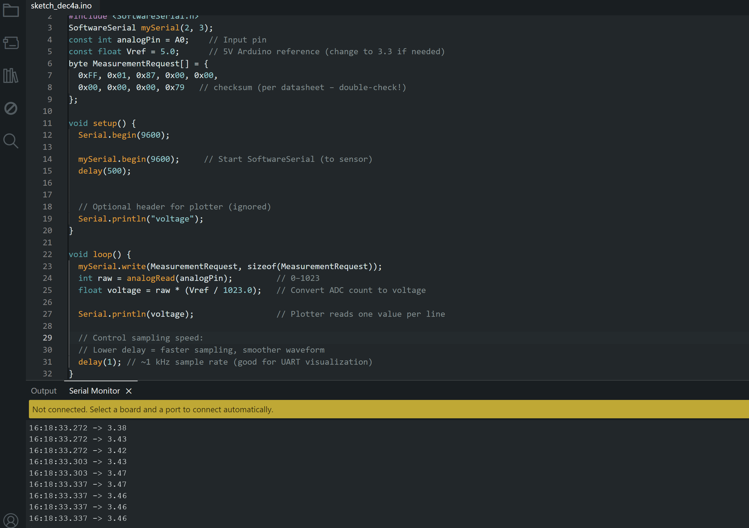

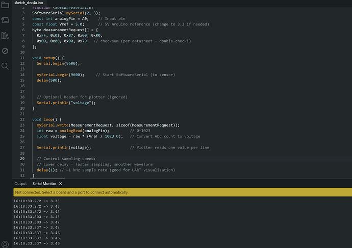

Hi, I have an arduino UNO and a sensor. The sensor operates in 3.3 V logic and the arduino on 5v logic. I use a level converter. The sensor has a passive response, when it is sent a 9 byte string over uart it responds with a 13 byte string containing oxygen level, temperature level, and humidity level.
When I connect the arduino using the diagram below and run the script, nothing is outputted to the serial monitor. I tried running the output from the logic converter to an analog port on the arduino and the signal shows 3.3 volt constant. This seems like the signal is not being sent, but I’m not sure if it because of the way I am testing it. I plan to test the same method tommorow using an oscilloscope instead of the analog port but thought I would ask for advice in the meantime. I have attached the datasheet of the sensor, an image of the setup, and the arduino script. Please note the setup is not the same as the diagram because I took the picture after trying to trouble shoot. My main thought is if the way I’m trying to send the serial data request signal correct? Please let me know if any more data is needed. [Sensor datasheet](https://sgxsensortech.com/uploads/f_note/DS-0458-PS1-O2-25per-MOD.pdf) thanks for any and all help.

You **never read from myserial** and do you have a data sheet for the sensor

One question: do you expect us to type the code if we want to try it? Please post the code according to the Forum Rules, enclosed in `<CODE/>` tags.
On the other hand, code #1 is useless; it makes an analog reading of a pin whose connection does not exist in the schematic.

@GolamMostafa
 ![IMG_2633](https://europe1.discourse-cdn.com/arduino/original/4X/2/f/a/2fa354f1b81a4109505235f24064a8dc34b20e44.jpeg)
 ![IMG_2632](https://europe1.discourse-cdn.com/arduino/original/4X/a/6/5/a65154e6465b46696e4a36fcb8efcf79119d2e8f.jpeg)
 ![IMG_2631](https://europe1.discourse-cdn.com/arduino/original/4X/6/4/4/644de247d974d954b7dcc1b723ac6bc627d1ce1e.jpeg)
 ![IMG_2630](https://europe1.discourse-cdn.com/arduino/original/4X/6/6/6/666bf14e62a1ae4f4a4b23d4b404193062c50e32.jpeg)
Hi I think I’m messing up something really stupid. When no ground or 5 volt lines connected, I messed the correct resistance values. When I plug arduino in (unpowered) I get a resistance of 1.5 kohm over the first resistor as if there is a resistor in parallel. I thought maybe there is some connection between the arduino (ground and 5v) when powered off.i tried with power on and measure only 1.6 V on the right power line where I should have 3.3. What am I doing wrong?

And now it is not working again ;(. Any ideas why I might have the 1.6v instead of 3.3? None of the resistors are physically touching
<div class="post-metadata">
**Author:** ![GolamMostafa](https://dub1.discourse-cdn.com/arduino/user_avatar/forum.arduino.cc/golammostafa/32/239011_2.png) [@GolamMostafa](https://forum.arduino.cc/u/GolamMostafa)\
**Post date:** [December 5, 2025, 4:06pm UTC](https://forum.arduino.cc/t/help-with-serial-uart-communication-between-arduino-and-a-sensor/1418045/20 "2025-12-05T16:06:13Z")
</div>
What resistors do you have? Tell me their values.
