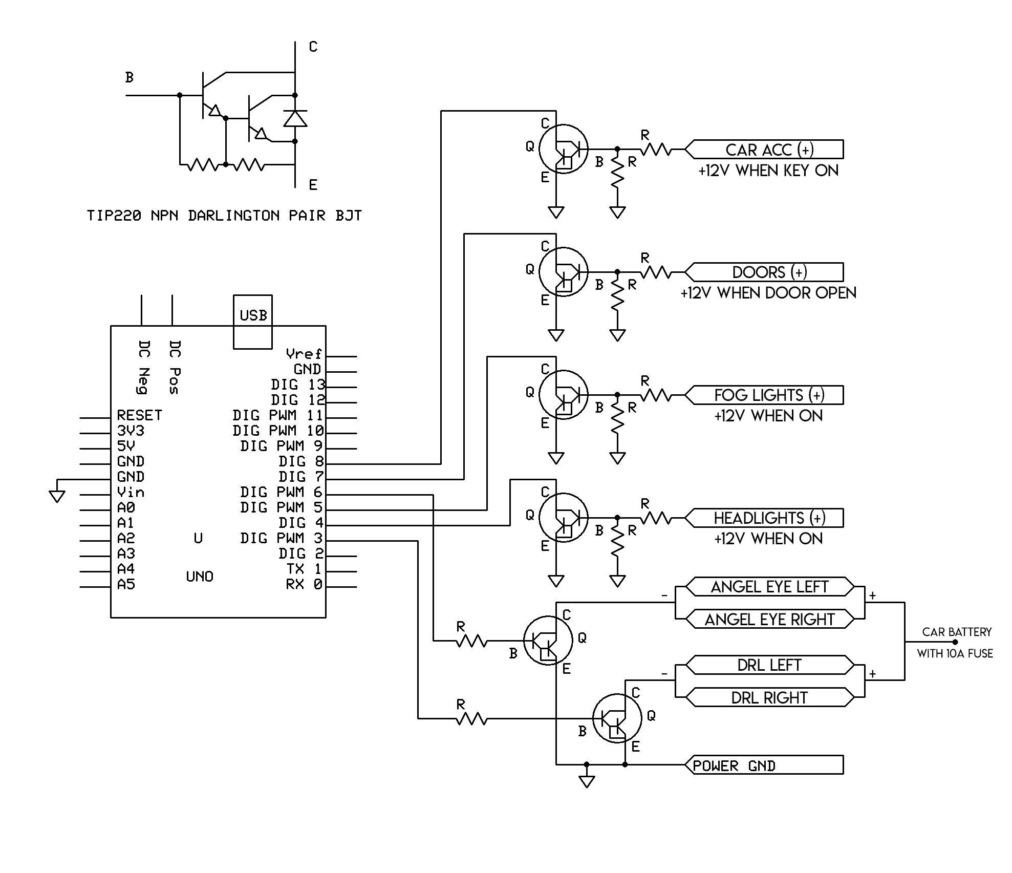

Hello everyone, this is a long post but i need someone to help me!
I'm doing a project in my car to put daylight running lights and control them with arduino. The working is simple, the project and code works perfect, but i'm having some issues with transistors and/or some sort of current leak that i can't figure out.
Let me go through my whole process. I made a simulation on tinkercad and everything works fine there.
I'm not going into code details and similar because that's not what i need help for, but basic functionality:
the lights represent each a couple of led lights, DRL and Angel Eyes (AE), which i already installed in the car. Gray is fog lights (AE need to be off when they are on), white is low beam (DRL need to be off when they are on), brown is ignition, green is doors (power when doors are open).
Lights turn on when doors are open (then turn off after X time). Lights are on when ignition is on and each pair turns off only if fog lights/low beam are on. Orange and blue are connected to the lights negative and are grounded only when arduino "says" it to the transistor.
So as i said everything works as expected, in the simulation....

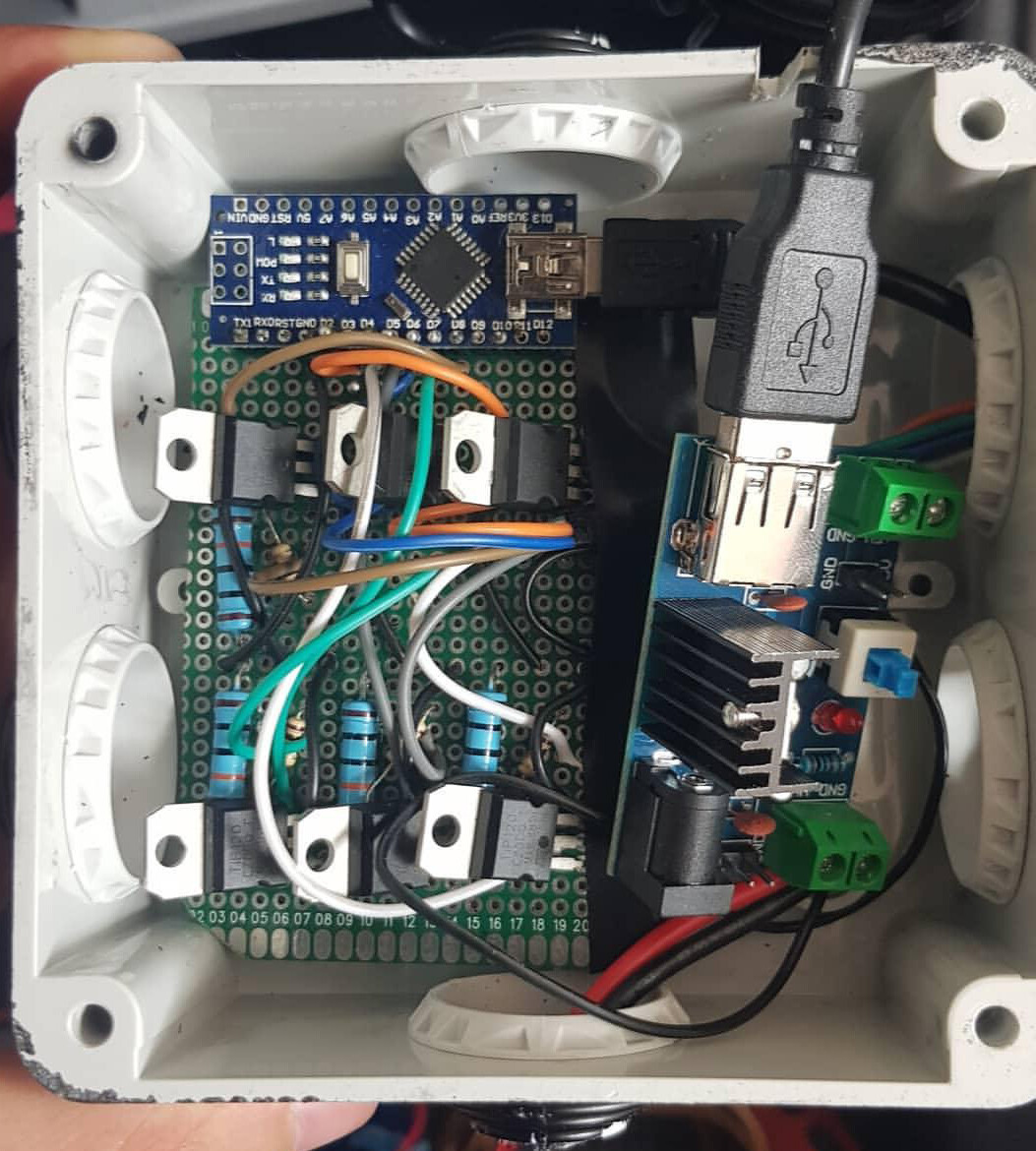

Then i made this
And it worked good for a couple of weeks, then i started having problems with the poorly made connections (or as i suspected after some tests) so ultimately i made a custom pcb (colors name are in italian)
And it like.. never worked? I mean i tested it at home and i worked then i put it in his position and the lights turn slightly on.

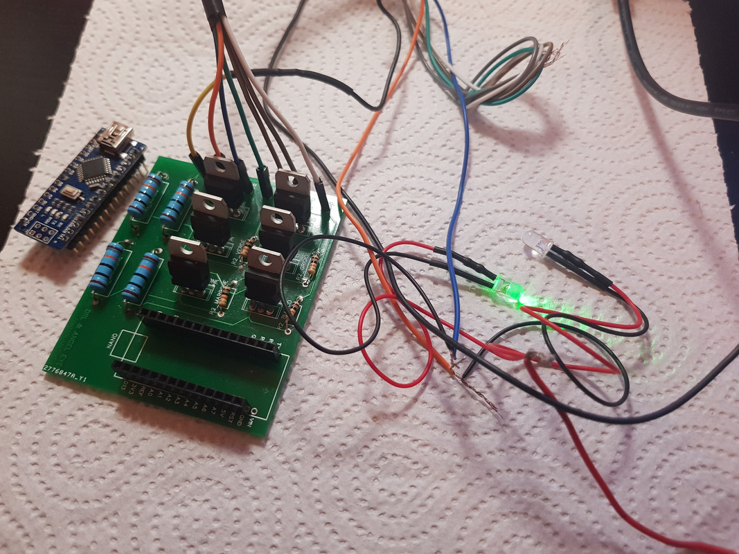

I did some testing at home with a couple of leds and 5v and as you can see in the following picture with ONLY the main GND connected to ground and the blue/orange wires connected to the leds negative, the green led (blue wire) somehow goes to ground and turns on with about 2V and also the white led (orange wire) very slightly turn on with less than 1V (voltage doesn't change if i disconnect one of the two).
I know i'm probably doing something wrong but i can't explain why it works good in the simulation and also worked on multiple real tests i did before. I even replaced the blue wire transistor and it looked like it worked for a little bit then again the same problem.
I tried to explain everything to give you a better picture of the problem, i'm not an expert so this might be a stupid mistake, but i hope you will be able to help me figure it out!
Thanks!
There is something you did not mention, that is the inrush of the headlights. They can surge at 50 or more times there running current (extremely difficult to measure). The colder the bulb the worse the inrush. This typically manifests itself over a period of time as failed MOSFET. There is also the slim possibility of an arc fault where the filaments will electrically connect together causing the MOSFET to carry the load of two filaments. The ARC fault becomes very prevalent when PWMing headlights from a 42V source. Light bulbs have always been a problem with semiconductors because of the inrush. Do the MOSFETs get hot? You must fully enhance them as fast as you can. Use a scope to validate this. There is a lot of information available online covering this. Use a MOSFET rated at least 50 Amps and drive it correctly!

The mosfet should run a lot cooler depending on what you chose. The TIP 120 is a darlington transistor with a VCE(sat) = 2.0 Vdc (Max) @ IC= 3.0 Adc. With 3 amps you will have 6 watts of heat. Thermal Resistance, Junction−to−Ambient RJA 62.5 °C/W that tells me 3 amps without a heatsink at 25C the case will reach (3 * 62,5) = 187.5C then add the ambient 24C you get a tab temperature of 212.5C, a bit on the warm side. Looking at a IRL520 Logic level TO220 N channel MOSFET it turns on at about 2V gs. Using Ohm's law you will get a 0.6 Volt drop across the MOSFET then at 3 amps you will get 1.8 Watts (I assumed it will not fully enhance at 5V so I used 0,2 ohm for the RDS(on). You then get 111,6C temperature rise, add the 25C ambient and you get 136.6C real hot but well below its 175C rating. Using a lower RDS(on) FET will run cooler as will adding a heatsink. The nice part it has a built in protection diode.

You need to go to the link and read the data sheet. It states Vgs 16V. Realize this is a maximum number. If you have a well regulated power supply no problem. However you are driving it with 5 volts it will work very well. Try this link: https://www.alliedelec.com/m/d/d44baf7598a89daf3e53a8ff03cc156e.pdf

Forget Fritzy, it just looks like a mass of coloured wires and is of little use when troubleshooting circuits

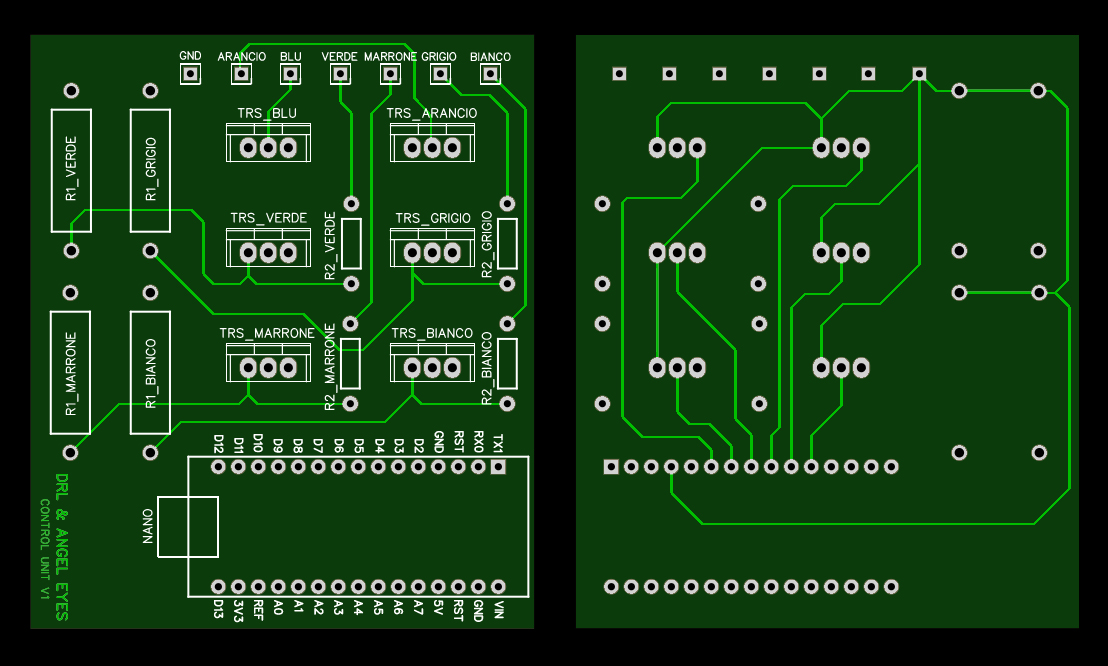

You PCB design, needs the tracks to be made wider, you have quite a lot of PCB with no copper.
[soapbox]
You have purchased a blank PCB, loaded with copper.
You are paying someone to remove that copper, which you purchased.
They are not giving you a discount for the copper they reclaim.
You have plenty of room so keep YOUR copper and use it to help provide strong solder points and good current carrying capacity.

Don't forget if you use TIP220 or MOSFETs the top tab will be at battery potential when the loads are switched ON.
So you need to physically stabilise them.
Hint, lay them down on the PCB and bolt them in, you are at the moment relying on the leads to support the devices in a vibration environment.

In the original Fritzing diagram TIP120's are being used without base resistors. So the Arduino is severely overloaded on those pins and will likely fail.
The diagram doesn't show it, but do you have current limit resistors in the base circuit between the outputs of the Arduino and the base of the two TIP220 that you are controlling?
Without these resistors you will be drawing current probably more than the 40mA (The Absolute Maximum) that the Arduino is rated at.
The output does not regulate the output current, but has a maximum rated load, if you overload the output you can damage the output circuitry.

Transistor base voltage is tied to the emitter voltage plus a small offset, you must use base resistors to avoid burning things up.
This is why we need a proper circuit diagram.
The kicad picture tells us nothing in the way of what the hardware actually is.

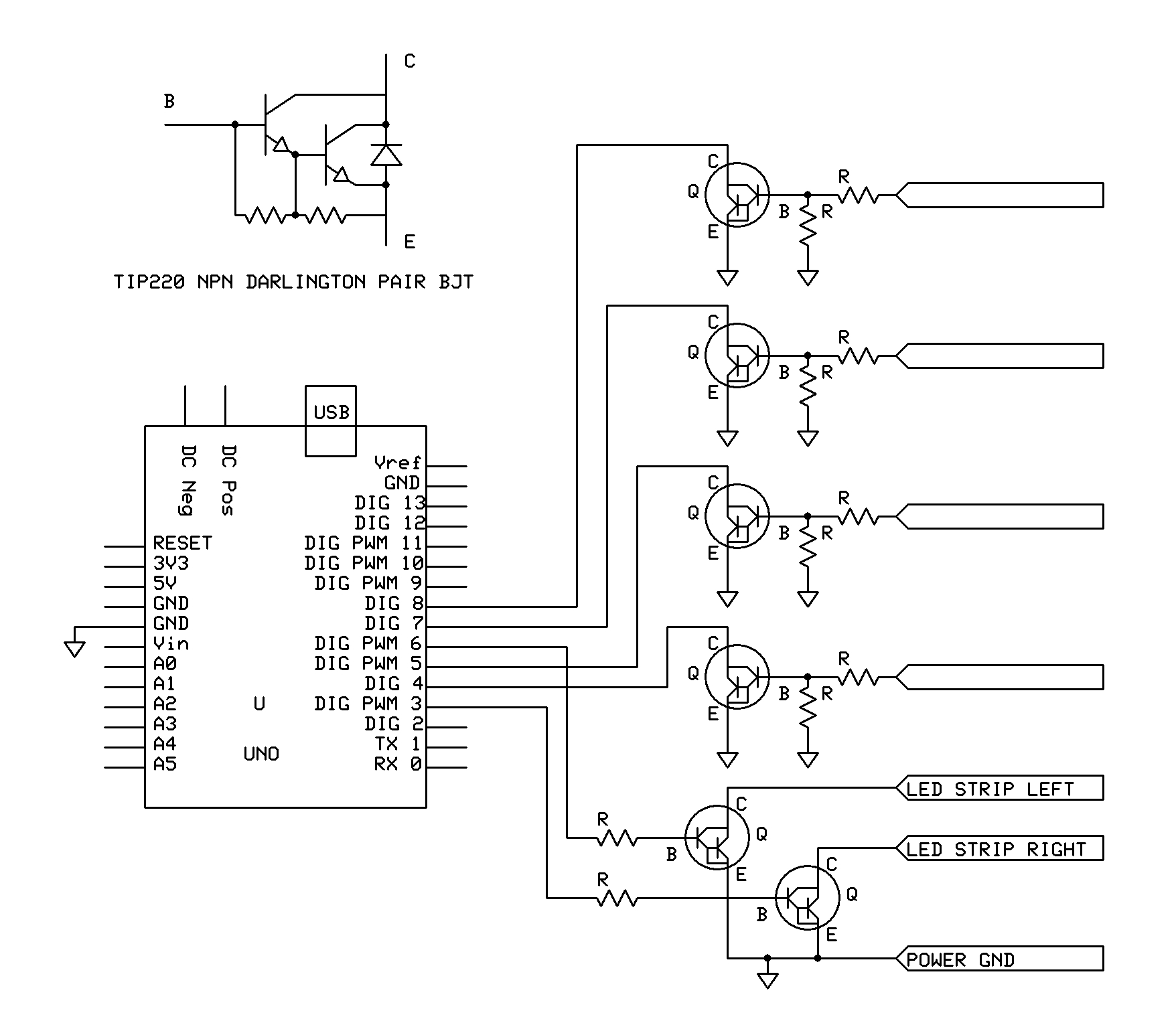

This may help.
The only load is the LED strip, how long/many LEDs is it?
All the other TIP220s are between the Arduino and the input sources.
Tom... :slight_smile:

Hey Tom, i adjusted your circuit diagram in photoshop with all the correct inputs and outputs connections and added comments for a better understanding.
Also i'm using an arduino nano for the actual project as you can see in the post. The code works fine, i even set up a debug with the serial monitor and can see when it detects or not the input and give the correct output, but if necessary i can give a better explaination of what it does.

Why oh why would you use a TIP220 as an input device?
