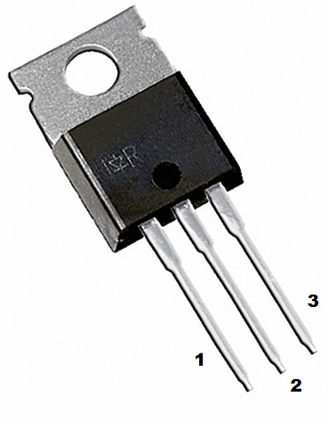

The best option is a module where the MOSFET has logic level (like IRLZ44N) but it can be hard to find.

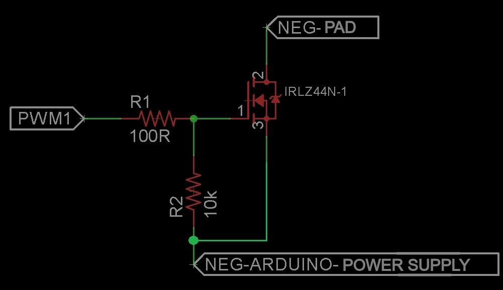

If do you want know how to build the circuit it should be like this:
The positive from PAD is connected directly to 5 V from power supply.
Thank you! How did you determine the resistance values?
Check it:
The 100R will limit the current on gate about 50 mA. Could be a bit higher since Arduino can delivery only 40 mA.
P.S. I think you have marked the wrong post as solution since the answers to your initial questions are on post #2.
The pull down resistor should be connected directly at the PWM pin, not where it is drawn in post #8.
The gate resistor should be between the PWM pin and the gate of the MOSFET, as it is drawn in post #8.

...Then remember that if the gate resistor is placed to the left of the pulldown resistor, you get a voltage divider circuit that will reduce the voltage to the gate.
If you have chosen a gate resistor that is at least 100 times smaller than the pulldown resistor, then the reduction in voltage is so small that it doesn’t matter. But if they are a bit closer in value, the voltage on your gate will be lower than the pin voltage.
With 10k pull down the voltage over the gate will be 4.95 V.
So what? That is an interesting fact and does not change where the pull down resistor shoukd be placed.
Why would you ever throw away anything like that?
The linked article ends up recommending the proper placement. Pull down or, in the case of high side switching, pull up the PWM pin directly. Attach the gate resistor there and run it to the gate.
a7
In this case there's no problem.
The recommendation is to a second case.
The solution? Switch places between the two so that the pulldown resistor is connected directly to the output pin.
