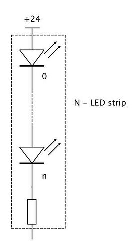

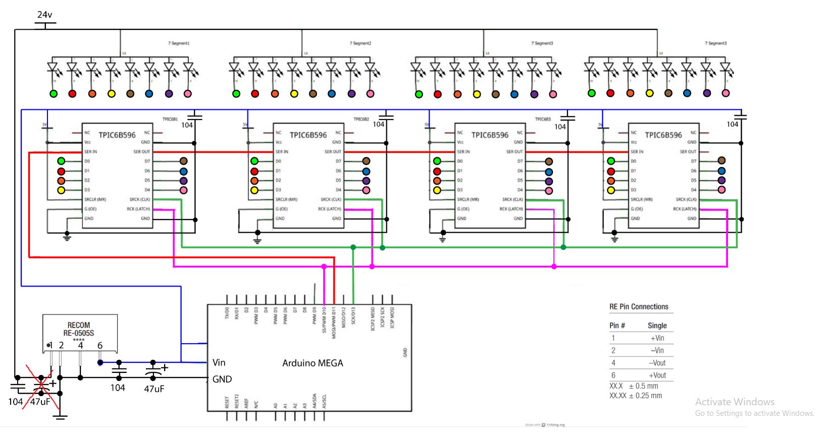

Hi. Control 24V LED strip by Multiplexing. HELP Please!!
Yes a lot better. You have missed the 5V label off the Arduino. The other thing is that the symbol for your LED strip don't show there is a current limiting resistor in the strip.
I am not sure if there is a official symbol for an LED strip. I would propose something like this:-

Now I just need help with the Code that will run this bad boy.
Gave you a hint in post#23.
Leo..
Ok so i am finding this really difficult. And really am butchering things together as i have no idea really.

So i have just run my circuit for the fist time now I have the Chips, I ran it with that code with just one display connected, and the display started to flashing on and off which i supposes means that something is working at least.
how-ever the bad new is one of my 47uF capacitors went BOOM!!! lol
any ideas why this could be?
it had 24v going through it?
The capacitor will go boom if the rating voltage is less than the 24V you are putting across it.
It will also go boom if you connected it the wrong way round.
There is not much of it left to see which one it was.
16v its says on it

16v its says on it
So now you know why it went boom when you connected it to 24V
