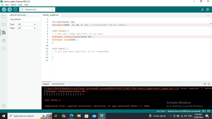

Thanks very much for answering,
 ![Screenshot (244)](https://europe1.discourse-cdn.com/arduino/original/4X/d/b/a/dba689b3f10902dd68bde85789818b8d4bc7b7fe.png)
I'm using a KeyeStudio:
- motor is a 28BYJ-48
- driver ULN2003
<div class="post-metadata">

Your error is pointing to the extra "motorspeed" inside the parenthesis on line 7.

Check answer #8 and the syntax of the line that the compiler highlighed in the screenshot you posted.
What do you expect that line to do?

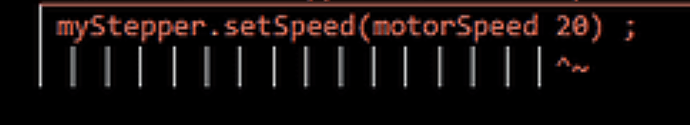

My eyes suck and I can barely read the code and error in your post #8.
If, instead of a screenshot of the code, you cut and pasted the actual code and error message, it would help folks help you.
If I squint hard, it looks like this line is ill formed:
 ![image](https://europe1.discourse-cdn.com/arduino/original/4X/e/7/c/e7c8d6584a30b569c793b4dadf7ff9bbc2206beb.png)
It looks like `myStepper.setSpeed(motorSpeed 20);` is confusing things. I'd try either
```arduino
myStepper.setSpeed(motorSpeed);`
or
```arduino
myStepper.setSpeed(20);`
depending on what you are trying to accomplish.
