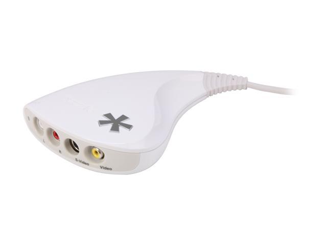

Okay, I was trying to limit myself to a mini screen. I'm considering other options now. What kind of converter and/or cable would I need if I were to record and stream the wireless video on a laptop? The wireless receiver would still have the RCA output.
Do you mean onto a laptop rather than on a laptop?
You need a video adaptor, the sort that you use to transfer video tape onto a computer.
Look at security transmitters for video transmitters. Also have a look at model rocket websites it is the sort of thing they do all the time.
Not sure if I understand your question. I want to watch what is being recorded on the camera that is on the bottle rocket in real-time. Real-time as in when the rocket is 50 feet in the air after 1 second, I want to see this with my own eyes speculating the rocket from a distance as well as seeing what it looks like from what the camera on the bottle rocket that is sending at the same time. I understand that there may be a slight delay in this transmission but I want it to be near the same time (real time, live, stream, or any non-english words that can express what I am envisioning). So I want to watch the bottle rocket move by watching through an lcd screen, laptop or other portable screen and also quickly glance at the rocket with my own eyes as it moves with respect to time. Does this answer your question?
Thanks, I will have to look into security transmitters. I have looked through numerous rocket and remote control hobby sites and forums and a lot of hobbyists use the eye goggles which are fairly pricey. I would like to constrain my project to the mini lcd.
I believe I found a video adapter on NewEgg called the Dazzle:
