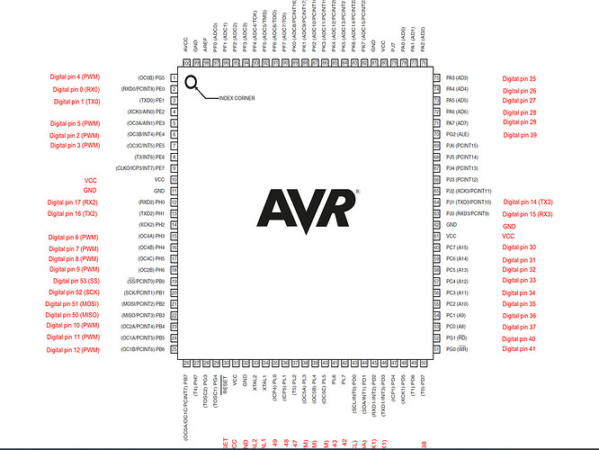

As part of a project I am trying to use a proportional solenoid requiring around 20KHz PWM.
Given the Arduino Mega PWM frequency is around 500Hz I though bit manipulation will be the way to go:
Here is the code i wrote :
/// we will try to use timer4

Mega pin mapping :
as per a email exange I had with someone from the manufacturer : "generating a PWM signal with a current control. If you use a PWM, please set the frequency ideally around 20 kHz but at minimum 3kHz."
