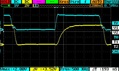

This is what I've measured from the scope:
Rise Delay: 120nS
Fall Delay: 126nS
First Ring Overshoot voltage: 2.24v (Logical high occurs at 1.5v)
First Ring undershoot voltage; -3.2v (This is why I'm glad the IC isn't damaged)

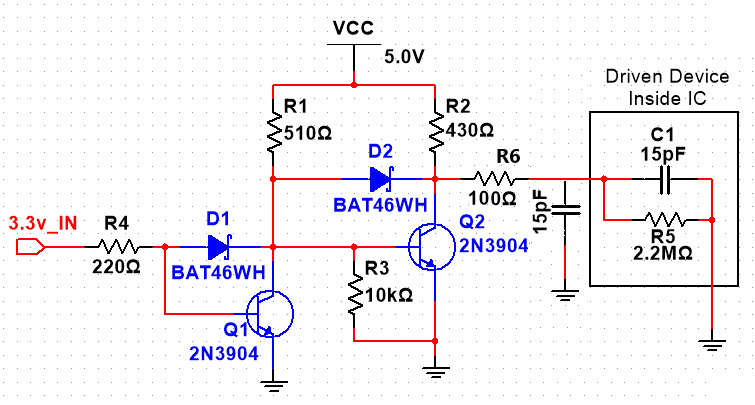

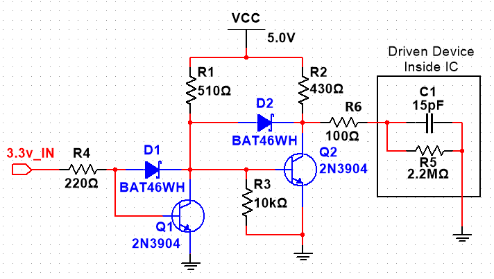

Here is the scope data and the schematic:

Its quite common for SPI and other serial communication to just use a series resistor to reduce or eliminate ringing. Note that when the 2N3904 turns off, the 430 ohm resistor pulls the signal high to 5V. Note the slower rise time, but no ringing. A possible solution might be just to use a 22-220 ohm series resistor from the collector of Q2 to the driven device.
You are simply doing a fast, clean, non-inverting translation of a square wave signal 0 to 3.3 volts to a 0 to 5.0 volt signal? If that is the case, I can’t see that D2 helps.

D2 clamps the gate when the gate gets pulled low. See Schottky diode clamps and baker clamps via google.

Also, due to the timing nature, I've selected a balanced resistor at Q2 for power, matching rise/fall times, and limited propagation delay. The delay times match multi-sim pretty accurately, but multisim didn't anticipate this level of ringing.
I'm not sure what added quiescent current or dissipation you're referring to.
There, I added R6 (no more ringing).
Aaahhhh... I thought you were referring to R2. I misread your comment haha... I'll give it a shot

I tried what you said, however, the slope doesn't scale on the rising/falling edge... ALTHOUGH!!! It has given me some serious insight! I shall try other resistor values and it made me think of something... what about an RL filter? I might just wind me a coil... haha Only thing I'm worried about is flyback
... or RC filter

Are you sure the input sees the ringing? Maybe it is scope artifact due to long GND leads?
EDIT:
Frequency of the oscillations is about 6 MHz; period 160 ns. Interesting fact: the blue trace (MCU output?) is lagging the yellow trace ringing by a tiny bit but consistently. Maybe 5 - 10 ns? I have no idea what that means. Can you make a photo of your setup?

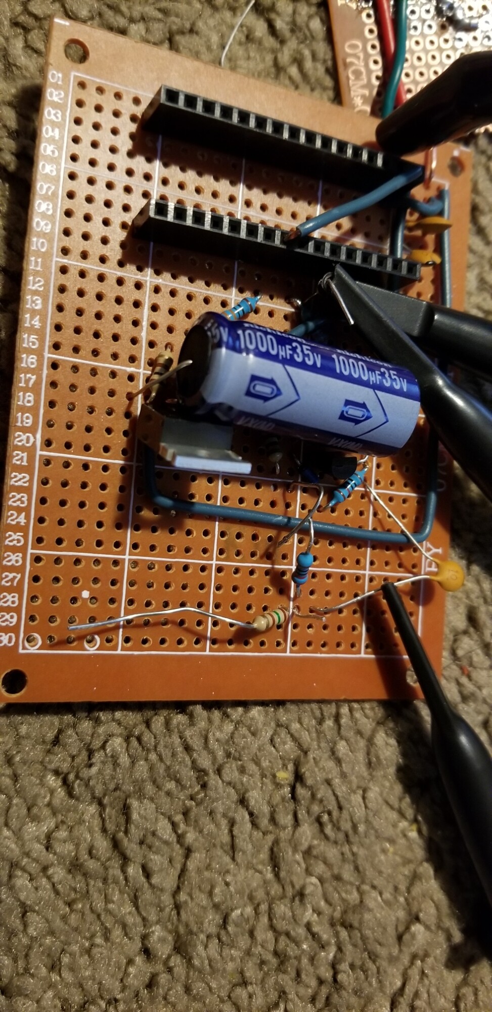

Yes, this is one case where a photo could give us more info than a schematic.
Keep ground wires short ... all going to one point near or at the power source (star grounding scheme is the best.
If using a breadboard, use some caps across the power rails (one large i.e. 10uF+, one small 0.1uF).
It looks to me that the circuit is an inverting level shifter, but the traces look to be nearly in phase, so how is the scope configured, i.e. trigger levels for each channel?
Do your scope probes have x10 switch? If so, give it a try and re-adjust mV/div to compensate. The x1 setting will be lower impedance and could introduce much of the ringing.

I've tried the RC filter, again, it pushes the timing uncomfortably close. Haven't dont the RL or RLC circuit yet, wifey got home from work and it was midnight haha. But yes, I made the same measurement. And I did experiment with some more values after making some calculations. I can critically damp for 12 MHz to get most of the ring out. Just a -600mV undershoot and a 100mv overshoot and no more ring.
I believe that the lagging ring on input is coming from the transition between conduction and the reverse bias of the transistor/diode clamp.
As for ground, I do have the lead connected to power supply ground. The scopes waveform output is driving the input to channel A and the circuit. Ie, 3.3v input is where the signal and channel a are probed to. No ground loops either, the scopes grounds are all the same so the same lead the supplies signal is the scope ground...

I have a 1000uf, 220 pf, and 10 pf capacitor in parallel with VCC and ground for power supply isolation. Also, the driven devices are somewhat power hungry. Also note that I don't have the load hooked up while testing the circuit. I'll follow up in a few minutes with new scope data and an image of the hookup.
Lastly, yes, i did try x10. No difference in wave form. That was the very first thing I tried haha
Not to be picky but I don't see any 'gate'. BJTs have a BASE, not a GATE. (no big deal but just sayin')
What is your physical layout? How did you make the measurements? Probes set to 10x? Where is the probe ground connected? and many other questions. I'll bet there is minimal ringing in simulation (oh, wait, now I see you already know that). You're automatically blaming the components when it could be the wiring.
Note that the transistor output circuit impedance is asymmetrical - "off" current is through a resistance, "on" current through the transistor. This is another reason why I suggest 74HCT logic. It has a mostly symmetrical push-pull output.

Also, here are the wave forms and my current prototype. The 2 resistors near the single probe were for testing different resistances with the RC circuit... Simulation doesn't always port well as I have first hand experience... At least in high speed switching applications haha. Will eventually get thrown on a pcb. I got busy with my little boy :slight_smile:
