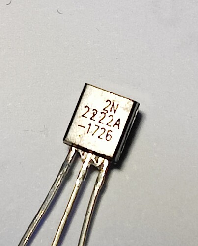

The measurement of 2.7V between base and emitter is impossible. Either you've blown the transistor or you are using the wrong pins. (Or both.)
Go back to basics: read the typenumber of the transistor and find a datasheet (or let me find it for you).
Measure resistors, the colorcodes are not always easy to read.
Some multimeters have a diode setting that may give you the voltage between base and emitter, do some checking. (Outside the circuit.)

Good advice on the transistor check, I didn't know I could do that, google is my friend. The transistor seemed to be fine using the diode function to look for voltage drops from E->B and B->C. I had three NPN transistors and the all seemed OK ( swapped one out just in case). I re-tested the resistors and the values are as expected.

I've found another datasheet as the one I was using had a slightly different version, but I'm happy to see the details look identical and more importantly I believe I have the pins the right way round!
