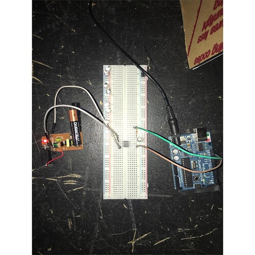

Hi here are the two pictures.

Hi Tom,
I swapped in two resistors in line 69R, unfortunately the flash hasn't triggered yet, but I pulled two leads from the main terminal pins to check their resistence. There is definitely a jump on the other side of the switch when the signal is sent, so I'm wondering if it could be the length of the pulse that's specefic in order to ignite the flash circuit as you said before. I've tried multiple lengths from 1ms to 2seconds without luck and also tried without the LED. I think we're close. I've attached another picture. If you can think of any other ideas please let me know. I'm wondering if using a triac between the optotriac and flash would help. I'll give that a go.
Thanks!
B
You are close, what you have done there is put a 22K in series with a 47R, that makes 22047 Ohms, not 69 Ohms.
Put 2 x 47 Ohm resistors in series and see what happens, 47 + 47 = 94R.
If you have a DMM, measure your series resistance before putting it in circuit.
Tom... :slight_smile:
Aha! I didn't see that, thanks I pulled it from the wrong batch. I just repaced it with a second 47ohm, then with a 'real' 22ohm and the LED turns on but no firing of the light yet.
With the LED OFF measure the voltage across pins 4 and 6 of the opto. That is the flash side, and should be high voltage.
With the LED ON measure it again. It should be close to zero.

Hi Tom,
I measured 215V, over the two terminals 4 and 6 on the opto, when the LED is off and .8V when the LED is on, so it seems to be working. I'm wondering if has something to do with the design of the opto, if it can take the votage spike, but I'd think that it would at least work once before breaking. Do you think a SCR would make any difference, like the C106D?
Thanks!
It would be worth a try.
Strange that the opto triac is not working, the only thing I can think of is it is limiting the current through it and so the mag field in the trigger transformer does not change quick enough.
The SCR should work, as that is what is used in automotive timing lights to trigger the flash, a timing light is just a glorified version of what you have, just being able to flash very quickly.
Tom.... :slight_smile:
Post a series of detailed pictures of the wiring including everything. Find a piece of paper and draw a schematic. Post a photo of that too.
Are you turning off the drive circuit long enough for the flash to recharge?
Hi Tom and Aarg,
The SCR works! Thank goodness, It must have been what you suggested, about the opto triac limiting the current. Thanks so much for your help. I will be using this to shoot some high speed photos. I have attached a drawing and photo of the circuit that is working.
