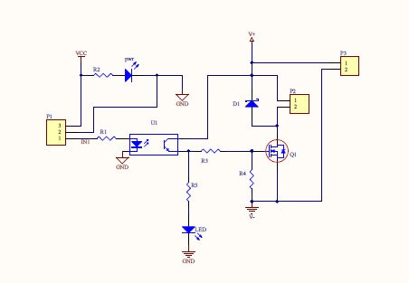

I require a relay which can switch 72VDC.
DC is the important part. As most seem to maxc out a 30VDC as I know its harder to switch.
So my setup is Arduino Leonadro, 5V switching signal to the Relay.
The Relay then switches a 72VDC load on/off. Just for 50ms. The current is also very low as its just moving a solenoid.
This is currently working with an all in one hobby relay board with Songle 30VDC/240VAC relay, but concerned about the longevity.
I'm ideally looking for an all in one solution , so relay already mounted on a board with terminals and optocoupler etc.
Alernatively, will a MOSFET board of some kind do this? Im cluessless about those.

You didn't specify the current.
If you want something reliable for higher currents, go with quality DC SSR.
If you current is low, you can try FR120N mosfet module:
https://aliexpress.com/item/1005008090450050.html
@kmin has a good suggestion, I have used them with great success. Be sure to pick the FR120N-100V 9.4A.

Yep, if you have few amps load that module is good for on/off.

I love this statement. Do you understand that a solenoid is an electric motor and will draw a very large current as the solenoid armature begins to move? Measure the solenoid coil resistance and use Ohm's law to compute the current at 72 volts.
Why do you want to control a solenoid with a relay? A relay is a switch operated by a solenoid, so switching a solenoid with a relay is using a solenoid to control a solenoid. Unless there's a good reason not to, I suggest controlling the solenoid directly with a MOSFET or DC SSR as others have suggested.

I disagree. The steady state current through a solenoid is limited by the DC resistance of the coil according to Ohm's law. The initial current is additionally limited by the EMF generated by the changing magnetic field as the current increases from zero to its steady state value.
A DC motor behaves differently because, once it is running, it behaves as a DC generator with the generator output voltage opposing the supply voltage, the difference between the two becoming the effective supply voltage and the current being that voltage divided by the motor's DC resistance.

The OP want the solenoid to move the armature, hold the armature and then release the armature all in 50 ms. Therefore the resistance must be quite low so the magnetic field can accelerate the armature and move it to it's seat and release it to return to the initial location all in 50ms. The coil must be low resistance to allow this to happen and this would cause an initial high current, a reduced current as the armature moves and produces back EMF, and finally high current when the armature is seated.
There is no requirement for repetition, as I read the spec, so heating is not a problem. If there is a rep rate, then the solenoid has to be designed to handle the heating.
