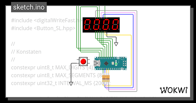

**Author:** ![Kai-R](https://dub1.discourse-cdn.com/arduino/user_avatar/forum.arduino.cc/kai-r/32/801182_2.png) [@Kai-R](https://forum.arduino.cc/u/Kai-R)\
**Post date:** [December 14, 2023, 11:06pm UTC](https://forum.arduino.cc/t/hilfe-bei-erstellung-eines-einfachen-codes/1200454/6 "2023-12-14T23:06:59Z")
</div>
Vielleicht so:
> **[7-Segment LED - Wokwi ESP32, STM32, Arduino Simulator](https://wokwi.com/projects/384123903599973377)**
> Run IoT and embedded projects in your browser: ESP32, STM32, Arduino, Pi Pico, and more. No installation required!
```arduino
#include <digitalWriteFast.h>
#include <Button_SL.hpp>
// Konstanten
constexpr uint8_t MAX_DIGITS {4};
constexpr uint8_t MAX_SEGMENTS {8};
constexpr uint32_t INTERVAL_MS {2000};
constexpr uint8_t decPlacePin[MAX_DIGITS] {A0, A1, A2, A3};
constexpr uint8_t digitPin[MAX_SEGMENTS] {4, 5, 6, 7, 8, 9, 10, 11};
constexpr uint8_t pinBtn {12};
constexpr uint8_t segmentBits[10] = {
    // afbgcDde
    0b11101011, // 0
    0b00101000, // 1
    0b10110011, // 2
    0b10111010, // 3
    0b01111000, // 4
    0b11011010, // 5
    0b11011011, // 6
    0b10101000, // 7
    0b11111011, // 8
    0b11111010, // 9
// globale Variablen/Objkte
Btn::ButtonSL btn {pinBtn};
// Funktionen
void digitsOff() {
  // Clear Digits
  for (auto dPP : decPlacePin) { digitalWriteFast(dPP, HIGH); }
void digit(uint8_t nbr, uint8_t dpPin) {
  digitsOff();
  for (uint8_t i = 0; i < MAX_SEGMENTS; ++i) { digitalWriteFast(digitPin[i], ((segmentBits[nbr] >> i) & 0x01)); }
  digitalWriteFast(decPlacePin[dpPin], LOW);
void setDot(uint8_t pos) {
  if (pos > 0 && pos < MAX_DIGITS) {
    digitsOff();
    for (uint8_t i = 0; i < MAX_SEGMENTS; ++i) { digitalWriteFast(digitPin[i], ((0b00000100 >> i) & 0x01)); }
    digitalWriteFast(decPlacePin[pos], LOW);
void numberToDisplay(uint8_t dgt[], uint8_t dot) {
  static uint8_t activeDigit {0};
  switch (activeDigit) {
    case 0: digit(dgt[0], 0);
    case 1: digit(dgt[1], 1);
    case 2: digit(dgt[2], 2);
    case 3: digit(dgt[3], 3);
    case 4: setDot(dot);
  if (++activeDigit == (MAX_DIGITS + 1)) { activeDigit = 0; }
void breakNumberDown(uint8_t dgt[], uint16_t nbr) {
  dgt[3] = nbr / 1000;
  nbr %= 1000;
  dgt[2] = nbr / 100;
  nbr %= 100;
  dgt[1] = nbr / 10;
  nbr %= 10;
  dgt[0] = nbr;
// Hauptprogramm
  for (auto dP : digitPin) { pinMode(dP, OUTPUT); }
  for (auto dPP : decPlacePin) { pinMode(dPP, OUTPUT); }
  btn.begin();
  randomSeed(638462874);
  static uint8_t digits[MAX_DIGITS];
  static uint16_t dotPos;
  uint16_t number;
  if (btn.tick() == Btn::ButtonState::shortPressed) {
    number = random(1, 10000);
    dotPos = random(0, 4);
    breakNumberDown(digits, number);
  numberToDisplay(digits, dotPos);
