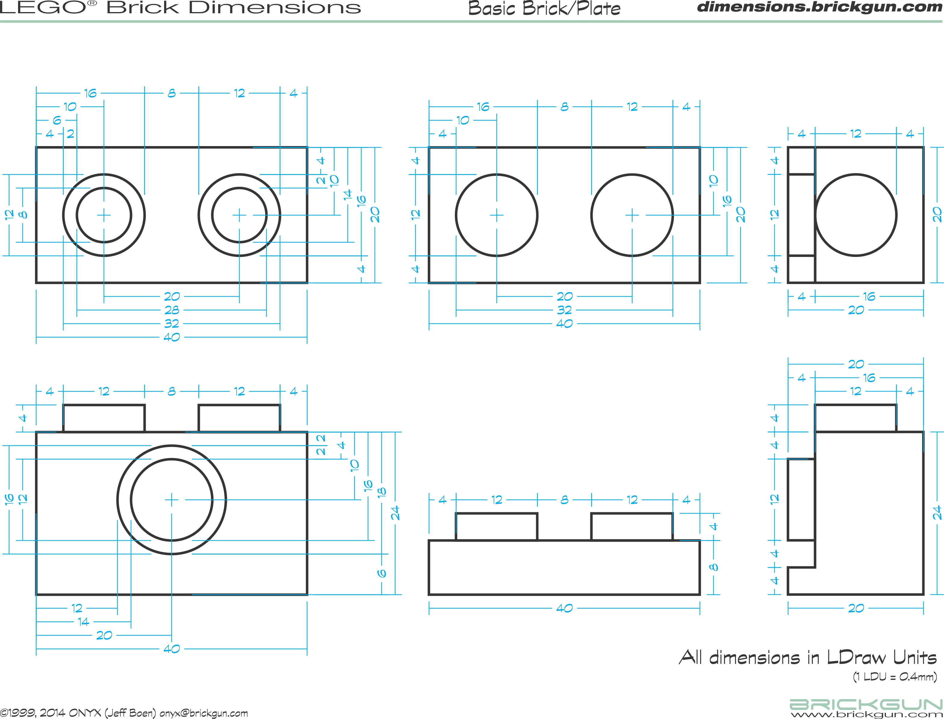

I think it's a really, really bad thing that the breakout boards don't follow any noticable standards. IMO, the hole configuration should follow a standard. Then, Arduino cases could be made to host one or more breakout board easily and safely fastened inside the box. No matter if it's a real time clock, a relay, or any other kind of module.
And, better yet, using a grid of multiples of 8mm c/c, holders with LEGO stud compatible interface could be 3D printed to hold the boards to a LEGO baseplate instead of swinging around randomly and threatening to short against the nearest next board.

I still would find it extremely helpful if I could just snap the different boards on for example a LEGO baseplate, preventing them from accidental collisions.
So ... are you asking for boards that would, say, plug onto a lego base plate as "mounting" (for physical permanence and rigidity), completely separate from their size and electrical connectivity ? Sort of half-Lego pieces that would mount the PCBs by screws on the top, and plug onto Lego blocks on the bottom? Sort of like the free universal construction kit/
That's actually a pretty interesting idea... As you say, the lack of ANY standardization for mounting holes makes it difficult to create a universal version of such a gadget, but something that converted the typical 0.1inch grid of prototype boards to the 8mm grid of lego studs would be a start...
I've always wondered if there were good reasons ways to pick where mounting holes are placed. Aside from obvious "matches the mounting holes in a particular box", Lego's 8mm grid is one of the first guidelines I've seen...

There are already a number of Arduino holders you can attach to a Lego baseplate, to either buy or 3D print. It woud have been a lot easier (and cheaper!) to make if the Arduino Uno and so on had had a more Lego-ish mounting hole pattern. But, of course, this standard is set a long time ago so we just have to live with it. But, as said earlier, I think it would be wonderful to be able to mount other boards to a Lego plate, too. I was thinking of four identical legs, or pillars, to begin with. Either a snapping system on top or just a screw hole.

I looked at this a bit more. LEGO is really huge compared to a lot of the breakout boards that we'd be talking about :frowning:
I generally try to stick m2 (2mm) holes in the corners of my boards, but have to leave out a corner now and then because I have too many components. Lego needs 4.8mm holes, and probably more than one in a group, if you want anything remotely sturdy :frowning:
I'll try to keep the spacing and hole size in mind on projects, but it looks a bit unlikely.
(The big problem is that the "sweet spot" for having PCBs made is (was?) 50x50mm, which is pretty small. You generally like to fill that up with parts. The area taken up by 4 2x1 Lego-brick hole patterns exceeds 20% of the board area, without including the space you lose by having to awkwardly route around the holes...)
