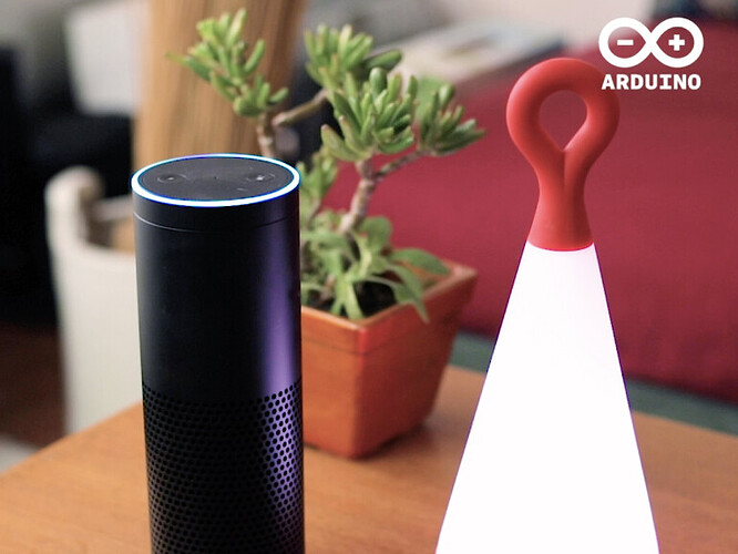

have a look at this about the alexa part..
