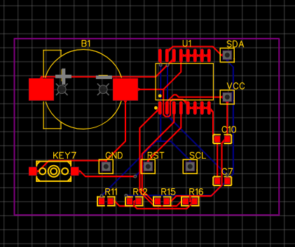

![ds3231](https://europe1.discourse-cdn.com/arduino/original/4X/6/6/a/66ab9ec1a38c3cd57c46392e4f90cf54b3442646.png)
![ds3231pcb](https://europe1.discourse-cdn.com/arduino/original/4X/c/b/f/cbf48e2c320e798a7b1c1cee74f6d348fb5bef5a.png)
I made a ds3231 circuit as the following circuit, I followed the code for a regular ds3231 module for arduino and I got the following result:
I made a ds3231 RTC circuit following its datasheet. The circuit is in the following chart. I followed the code online for a regular ds3231 module and the time I have got is:

Other i2c devices on the same i2c wires are working fine.
I found there is an eeprom chip in a regular ds3231 module, but didn;t find one in the example circuit in the datasheet of ds3231, is that part necessary?
The chip is functional (swaped with a commercial ds3231 module).
Is there any suggestions?

Show us a good schematic of your complete circuit.
Show us a good image of your ‘actual’ wiring.
Give links to components.

The circuit is complete, because it is a module. I just uploaded the pcb of it. It is used as a regular arduino module, just like any other i2c module. When I used it, I connect it with a mega2560 with an eeprom module, too. The eeprom works fine, but not this ds3231 one.

There are a lot of traces that are closer than is normally acceptable.
Below are the "standard" steps to verify a new board.
Do you have a blank (unbuilt) left over? If so measure the traces that are close to verify there are not shorts.
With a magnifying glass, verify you have not solder shorts on the board.
I would then power the circuit (without battery). If you can verify the expected current draw that would be good.
With a voltmeter I would measure every input and verify it is what you expect.
Yes, suggest you take out a DMM and confirm no shorts to adjacent pads or traces.

The traces on R12, R16, C7 and C10 are much closer to the adjacent pad then is necessary for the space you have on the board. Let us know what you find I am doing one of these myself at the moment, but only using the SDA, SCL lines and the battery.

The next time you design a board you might consider increasing the trace width. Unfortunately many board design software defaults to what most board houses consider a minimum trace width their process is capable of.

The OP's board has plenty of room for alternate trace paths. I'm sure once he gets more experience he will do fine. After all, these new folks are going from zero to a full PCB design capability. We (or at least me) learned at my first job out of college, not the same.

Thanks, I am doing that. I just used automatic wiring in the eda and the result is like this. I have checked the board, there is no short. Is there any special requirment for these i2c wires? They are quite slow so should be fine anyway, right?

Can you post a good picture of the actual board?

> [@joedodo](#):
That's never a good idea. There are lots of issues with the routing; while I'm confident it will work Okish if manufactured well, it's far from ideal. But let's skip over this for a second.
Why 10k pullups on I2C? What happens if you use a bit stronger ones, like 4k7?

You don't have to think what could be wrong. Something is very wrong. Either the DS3231 is broken or there is a shortcut or something else. Do you have another DS3231 ? or perhaps an other pcb ? Check everything once more. If you can not find the problem, then put the pcb away and start all over.

I have 10 of the pcb and tried two of them. I tested three chips one of this was verified functional in a premade ds3231 module. I think it is the resistors.

No pullup resistors or 4k7 or 10k does not cause such big troubles. You have to think about a shortcut or something damaged or a missing connection or a unpowered DS3231. I checked your schematic, but I can not see a problem there. Can you upload a detailed photo ?
