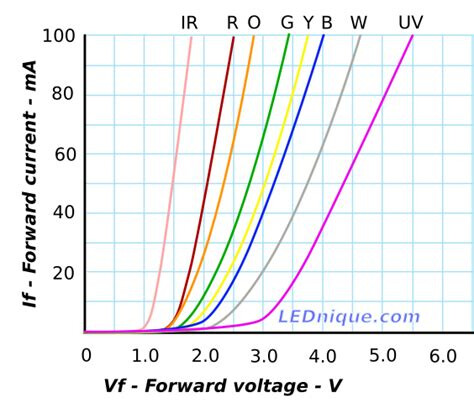

This shows the voltage needed to light the LED at the current you are passing through it.
