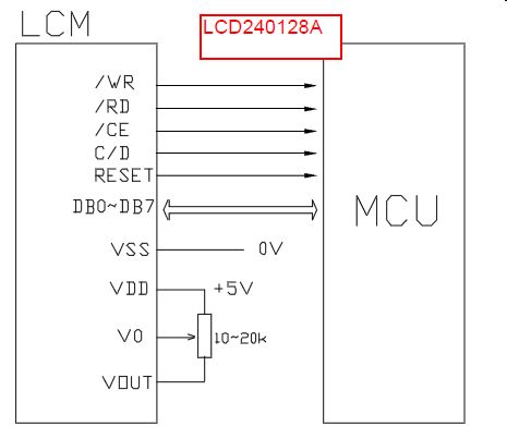

V0 is required for the contrast adjustment:
(Source: https://www.mikrocontroller.net/attachment/69907/Zwischenablage02.jpg)
Oliver

Ok after reading few threads I connected pot of 50K between VCC and VEE(-12V) to VO but now on hello world program I am only getting a black line for 1/2 sec and it gets disappear again same for the rotation example!
I dont understand where I am doing wrong!
What happens, if you move the pot. You should be able to turn on and off all pixels just by moving the wiper.
Oliver
Ok thanks I got it it is just to set pot to proper position thats all!

Random line? Sounds like the negative LCD voltage is missing.
Oliver
