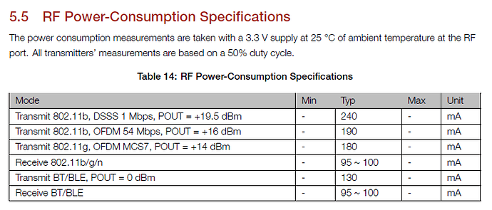

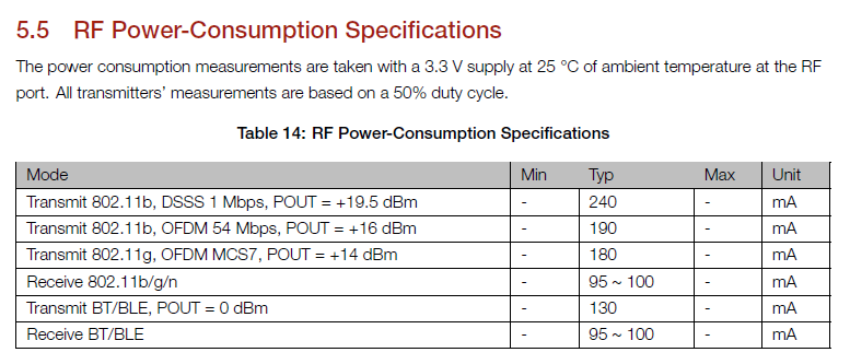

Thing is I've seen the ESP32 pull a lot (which I can't recall well enough to quantify) of power for Wifi connect. I almost need to measure the load or assume worst case but cannot find a reasonable worst case guess!
When the transmitter is active power consumption is surely higher but it us not a parrot, talking all the time I suppose.
The 50-60mA I estimated comes from a powerdraw of about 120mA from the ESP-32 (educated guess).
The buck converter only draws 50-60 mA to deliver that 120mA for the regulator that makes 3.3volt for the ESP.
Leo..

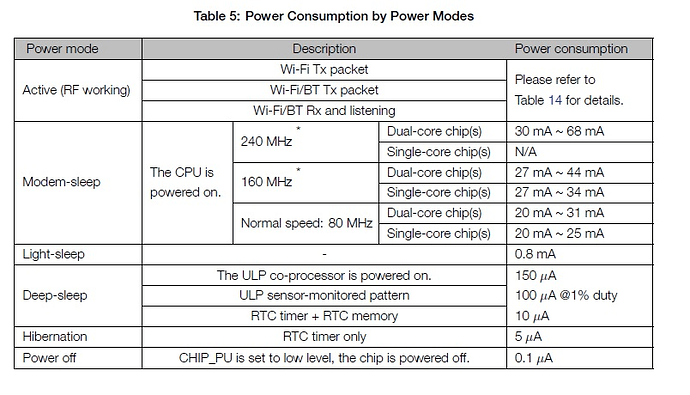

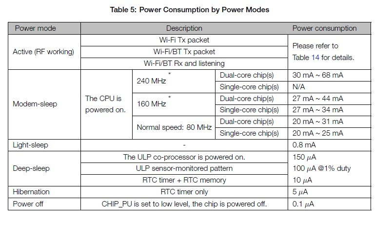

The current consumption can be found in the ESP32 Datasheet.
It is to be found in tables 5 and 14.
