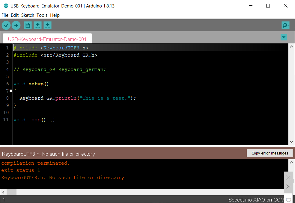

just now I tried the new KeyboardUTF8-library from @johnwasser
I'm pretty sure that I installed the ZIP-library correct.

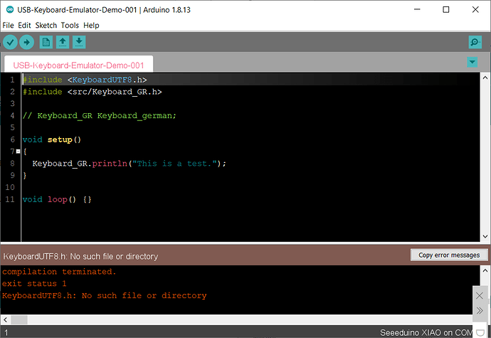

But I get the error-message
KeyboardUTF8.h: No such file or directory
This is the full compiler-report
F:\MyPortable-PRgs\arduino1.8.13\arduino-builder -dump-prefs -logger=machine -hardware F:\MyPortable-PRgs\arduino1.8.13\hardware -hardware F:\MyPortable-PRgs\arduino1.8.13\portable\packages -hardware F:\MyPortable-PRgs\arduino1.8.13\portable\sketchbook\hardware -tools F:\MyPortable-PRgs\arduino1.8.13\tools-builder -tools F:\MyPortable-PRgs\arduino1.8.13\hardware\tools\avr -tools F:\MyPortable-PRgs\arduino1.8.13\portable\packages -built-in-libraries F:\MyPortable-PRgs\arduino1.8.13\libraries -libraries F:\MyPortable-PRgs\arduino1.8.13\portable\sketchbook\libraries -fqbn=Seeeduino:samd:seeed_XIAO_m0:usbstack=arduino,debug=off -vid-pid=2886_802F -ide-version=10813 -build-path C:\Users\dipl-\AppData\Local\Temp\arduino_build_779855 -warnings=none -build-cache C:\Users\dipl-\AppData\Local\Temp\arduino_cache_108076 -prefs=build.warn_data_percentage=75 -prefs=runtime.tools.arm-none-eabi-gcc.path=F:\MyPortable-PRgs\arduino1.8.13\portable\packages\Seeeduino\tools\arm-none-eabi-gcc\7-2017q4 -prefs=runtime.tools.arm-none-eabi-gcc-7-2017q4.path=F:\MyPortable-PRgs\arduino1.8.13\portable\packages\Seeeduino\tools\arm-none-eabi-gcc\7-2017q4 -prefs=runtime.tools.bossac.path=F:\MyPortable-PRgs\arduino1.8.13\portable\packages\Seeeduino\tools\bossac\1.8.0-48-gb176eee -prefs=runtime.tools.bossac-1.7.0-arduino3.path=F:\MyPortable-PRgs\arduino1.8.13\portable\packages\Seeeduino\tools\bossac\1.7.0-arduino3 -prefs=runtime.tools.bossac-1.8.0-48-gb176eee.path=F:\MyPortable-PRgs\arduino1.8.13\portable\packages\Seeeduino\tools\bossac\1.8.0-48-gb176eee -prefs=runtime.tools.CMSIS.path=F:\MyPortable-PRgs\arduino1.8.13\portable\packages\Seeeduino\tools\CMSIS\5.4.0 -prefs=runtime.tools.CMSIS-5.4.0.path=F:\MyPortable-PRgs\arduino1.8.13\portable\packages\Seeeduino\tools\CMSIS\5.4.0 -prefs=runtime.tools.arduinoOTA.path=F:\MyPortable-PRgs\arduino1.8.13\portable\packages\Seeeduino\tools\arduinoOTA\1.2.1 -prefs=runtime.tools.arduinoOTA-1.2.1.path=F:\MyPortable-PRgs\arduino1.8.13\portable\packages\Seeeduino\tools\arduinoOTA\1.2.1 -prefs=runtime.tools.CMSIS-Atmel.path=F:\MyPortable-PRgs\arduino1.8.13\portable\packages\Seeeduino\tools\CMSIS-Atmel\1.2.1 -prefs=runtime.tools.CMSIS-Atmel-1.2.1.path=F:\MyPortable-PRgs\arduino1.8.13\portable\packages\Seeeduino\tools\CMSIS-Atmel\1.2.1 -prefs=runtime.tools.openocd.path=F:\MyPortable-PRgs\arduino1.8.13\portable\packages\arduino\tools\openocd\0.10.0-arduino7 -prefs=runtime.tools.openocd-0.10.0-arduino7.path=F:\MyPortable-PRgs\arduino1.8.13\portable\packages\arduino\tools\openocd\0.10.0-arduino7 -verbose F:\MyPortable-PRgs\arduino-1.8.16\portable\sketchbook\USB-Keyboard-Emulator-Demo-001\USB-Keyboard-Emulator-Demo-001.ino
F:\MyPortable-PRgs\arduino1.8.13\arduino-builder -compile -logger=machine -hardware F:\MyPortable-PRgs\arduino1.8.13\hardware -hardware F:\MyPortable-PRgs\arduino1.8.13\portable\packages -hardware F:\MyPortable-PRgs\arduino1.8.13\portable\sketchbook\hardware -tools F:\MyPortable-PRgs\arduino1.8.13\tools-builder -tools F:\MyPortable-PRgs\arduino1.8.13\hardware\tools\avr -tools F:\MyPortable-PRgs\arduino1.8.13\portable\packages -built-in-libraries F:\MyPortable-PRgs\arduino1.8.13\libraries -libraries F:\MyPortable-PRgs\arduino1.8.13\portable\sketchbook\libraries -fqbn=Seeeduino:samd:seeed_XIAO_m0:usbstack=arduino,debug=off -vid-pid=2886_802F -ide-version=10813 -build-path C:\Users\dipl-\AppData\Local\Temp\arduino_build_779855 -warnings=none -build-cache C:\Users\dipl-\AppData\Local\Temp\arduino_cache_108076 -prefs=build.warn_data_percentage=75 -prefs=runtime.tools.arm-none-eabi-gcc.path=F:\MyPortable-PRgs\arduino1.8.13\portable\packages\Seeeduino\tools\arm-none-eabi-gcc\7-2017q4 -prefs=runtime.tools.arm-none-eabi-gcc-7-2017q4.path=F:\MyPortable-PRgs\arduino1.8.13\portable\packages\Seeeduino\tools\arm-none-eabi-gcc\7-2017q4 -prefs=runtime.tools.bossac.path=F:\MyPortable-PRgs\arduino1.8.13\portable\packages\Seeeduino\tools\bossac\1.8.0-48-gb176eee -prefs=runtime.tools.bossac-1.7.0-arduino3.path=F:\MyPortable-PRgs\arduino1.8.13\portable\packages\Seeeduino\tools\bossac\1.7.0-arduino3 -prefs=runtime.tools.bossac-1.8.0-48-gb176eee.path=F:\MyPortable-PRgs\arduino1.8.13\portable\packages\Seeeduino\tools\bossac\1.8.0-48-gb176eee -prefs=runtime.tools.CMSIS.path=F:\MyPortable-PRgs\arduino1.8.13\portable\packages\Seeeduino\tools\CMSIS\5.4.0 -prefs=runtime.tools.CMSIS-5.4.0.path=F:\MyPortable-PRgs\arduino1.8.13\portable\packages\Seeeduino\tools\CMSIS\5.4.0 -prefs=runtime.tools.arduinoOTA.path=F:\MyPortable-PRgs\arduino1.8.13\portable\packages\Seeeduino\tools\arduinoOTA\1.2.1 -prefs=runtime.tools.arduinoOTA-1.2.1.path=F:\MyPortable-PRgs\arduino1.8.13\portable\packages\Seeeduino\tools\arduinoOTA\1.2.1 -prefs=runtime.tools.CMSIS-Atmel.path=F:\MyPortable-PRgs\arduino1.8.13\portable\packages\Seeeduino\tools\CMSIS-Atmel\1.2.1 -prefs=runtime.tools.CMSIS-Atmel-1.2.1.path=F:\MyPortable-PRgs\arduino1.8.13\portable\packages\Seeeduino\tools\CMSIS-Atmel\1.2.1 -prefs=runtime.tools.openocd.path=F:\MyPortable-PRgs\arduino1.8.13\portable\packages\arduino\tools\openocd\0.10.0-arduino7 -prefs=runtime.tools.openocd-0.10.0-arduino7.path=F:\MyPortable-PRgs\arduino1.8.13\portable\packages\arduino\tools\openocd\0.10.0-arduino7 -verbose F:\MyPortable-PRgs\arduino-1.8.16\portable\sketchbook\USB-Keyboard-Emulator-Demo-001\USB-Keyboard-Emulator-Demo-001.ino
Using board 'seeed_XIAO_m0' from platform in folder: F:\MyPortable-PRgs\arduino1.8.13\portable\packages\Seeeduino\hardware\samd\1.8.1
Using core 'arduino' from platform in folder: F:\MyPortable-PRgs\arduino1.8.13\portable\packages\Seeeduino\hardware\samd\1.8.1
Detecting libraries used...
"F:\\MyPortable-PRgs\\arduino1.8.13\\portable\\packages\\Seeeduino\\tools\\arm-none-eabi-gcc\\7-2017q4/bin/arm-none-eabi-g++" -mcpu=cortex-m0plus -mthumb -c -g -Os -w -std=gnu++14 -ffunction-sections -fdata-sections -fno-threadsafe-statics -nostdlib --param max-inline-insns-single=500 -fno-rtti -fno-exceptions "-D__SKETCH_NAME__=\"\"\"USB-Keyboard-Emulator-Demo-001.ino\"\"\"" -w -x c++ -E -CC -DF_CPU=48000000L -DARDUINO=10813 -DARDUINO_SEEED_XIAO_M0 -DARDUINO_ARCH_SAMD -DARDUINO_SAMD_ZERO -D__SAMD21__ -D__SAMD21G18A__ -DARM_MATH_CM0PLUS -DSEEED_XIAO_M0 -DUSB_VID=0x2886 -DUSB_PID=0x802F -DUSBCON -DUSB_CONFIG_POWER=100 "-DUSB_MANUFACTURER=\"Seeed\"" "-DUSB_PRODUCT=\"Seeed XIAO M0\"" "-IF:\\MyPortable-PRgs\\arduino1.8.13\\portable\\packages\\Seeeduino\\hardware\\samd\\1.8.1\\cores\\arduino/TinyUSB" "-IF:\\MyPortable-PRgs\\arduino1.8.13\\portable\\packages\\Seeeduino\\hardware\\samd\\1.8.1\\cores\\arduino/TinyUSB/Adafruit_TinyUSB_ArduinoCore" "-IF:\\MyPortable-PRgs\\arduino1.8.13\\portable\\packages\\Seeeduino\\hardware\\samd\\1.8.1\\cores\\arduino/TinyUSB/Adafruit_TinyUSB_ArduinoCore/tinyusb/src" -DARDUINO_SAMD_ZERO -D__SAMD21__ -D__SAMD21G18A__ -DARM_MATH_CM0PLUS -DSEEED_XIAO_M0 -DUSB_VID=0x2886 -DUSB_PID=0x802F -DUSBCON -DUSB_CONFIG_POWER=100 "-DUSB_MANUFACTURER=\"Seeed\"" "-DUSB_PRODUCT=\"Seeed XIAO M0\"" "-IF:\\MyPortable-PRgs\\arduino1.8.13\\portable\\packages\\Seeeduino\\hardware\\samd\\1.8.1\\cores\\arduino/TinyUSB" "-IF:\\MyPortable-PRgs\\arduino1.8.13\\portable\\packages\\Seeeduino\\hardware\\samd\\1.8.1\\cores\\arduino/TinyUSB/Adafruit_TinyUSB_ArduinoCore" "-IF:\\MyPortable-PRgs\\arduino1.8.13\\portable\\packages\\Seeeduino\\hardware\\samd\\1.8.1\\cores\\arduino/TinyUSB/Adafruit_TinyUSB_ArduinoCore/tinyusb/src" "-IF:\\MyPortable-PRgs\\arduino1.8.13\\portable\\packages\\Seeeduino\\tools\\CMSIS\\5.4.0/CMSIS/Core/Include/" "-IF:\\MyPortable-PRgs\\arduino1.8.13\\portable\\packages\\Seeeduino\\tools\\CMSIS\\5.4.0/CMSIS/DSP/Include/" "-IF:\\MyPortable-PRgs\\arduino1.8.13\\portable\\packages\\Seeeduino\\tools\\CMSIS-Atmel\\1.2.1/CMSIS-Atmel/CMSIS/Device/ATMEL/" "-IF:\\MyPortable-PRgs\\arduino1.8.13\\portable\\packages\\Seeeduino\\hardware\\samd\\1.8.1\\cores\\arduino" "-IF:\\MyPortable-PRgs\\arduino1.8.13\\portable\\packages\\Seeeduino\\hardware\\samd\\1.8.1\\variants\\XIAO_m0" "C:\\Users\\dipl-\\AppData\\Local\\Temp\\arduino_build_779855\\sketch\\USB-Keyboard-Emulator-Demo-001.ino.cpp" -o nul -DARDUINO_LIB_DISCOVERY_PHASE
Alternatives for KeyboardUTF8.h: []
ResolveLibrary(KeyboardUTF8.h):1:10: fatal error: KeyboardUTF8.h: No such file or directory
  -> candidates: []
 #include <KeyboardUTF8.h>
compilation terminated.
exit status 1

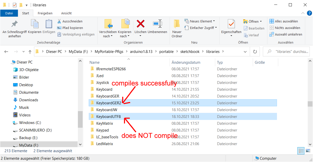

My self-created library KeyboardGER2 is in the same filestructure and does compile for the Seeeduino-Board I'm using.
There the correct "candidate" is found
"F:\\MyPortable-PRgs\\arduino1.8.13\\portable\\packages\\Seeeduino\\tools\\arm-none-eabi-gcc\\7-2017q4/bin/arm-none-eabi-g++" -mcpu=cortex-m0plus -mthumb -c -g -Os -w -std=gnu++14 -ffunction-sections -fdata-sections -fno-threadsafe-statics -nostdlib --param max-inline-insns-single=500 -fno-rtti -fno-exceptions "-D__SKETCH_NAME__=\"\"\"Seeeduino-XIAO-011-SerInKeyB-GER-SndReturn.ino\"\"\"" -w -x c++ -E -CC -DF_CPU=48000000L -DARDUINO=10813 -DARDUINO_SEEED_XIAO_M0 -DARDUINO_ARCH_SAMD -DARDUINO_SAMD_ZERO -D__SAMD21__ -D__SAMD21G18A__ -DARM_MATH_CM0PLUS -DSEEED_XIAO_M0 -DUSB_VID=0x2886 -DUSB_PID=0x802F -DUSBCON -DUSB_CONFIG_POWER=100 "-DUSB_MANUFACTURER=\"Seeed\"" "-DUSB_PRODUCT=\"Seeed XIAO M0\"" "-IF:\\MyPortable-PRgs\\arduino1.8.13\\portable\\packages\\Seeeduino\\hardware\\samd\\1.8.1\\cores\\arduino/TinyUSB" "-IF:\\MyPortable-PRgs\\arduino1.8.13\\portable\\packages\\Seeeduino\\hardware\\samd\\1.8.1\\cores\\arduino/TinyUSB/Adafruit_TinyUSB_ArduinoCore" "-IF:\\MyPortable-PRgs\\arduino1.8.13\\portable\\packages\\Seeeduino\\hardware\\samd\\1.8.1\\cores\\arduino/TinyUSB/Adafruit_TinyUSB_ArduinoCore/tinyusb/src" -DARDUINO_SAMD_ZERO -D__SAMD21__ -D__SAMD21G18A__ -DARM_MATH_CM0PLUS -DSEEED_XIAO_M0 -DUSB_VID=0x2886 -DUSB_PID=0x802F -DUSBCON -DUSB_CONFIG_POWER=100 "-DUSB_MANUFACTURER=\"Seeed\"" "-DUSB_PRODUCT=\"Seeed XIAO M0\"" "-IF:\\MyPortable-PRgs\\arduino1.8.13\\portable\\packages\\Seeeduino\\hardware\\samd\\1.8.1\\cores\\arduino/TinyUSB" "-IF:\\MyPortable-PRgs\\arduino1.8.13\\portable\\packages\\Seeeduino\\hardware\\samd\\1.8.1\\cores\\arduino/TinyUSB/Adafruit_TinyUSB_ArduinoCore" "-IF:\\MyPortable-PRgs\\arduino1.8.13\\portable\\packages\\Seeeduino\\hardware\\samd\\1.8.1\\cores\\arduino/TinyUSB/Adafruit_TinyUSB_ArduinoCore/tinyusb/src" "-IF:\\MyPortable-PRgs\\arduino1.8.13\\portable\\packages\\Seeeduino\\tools\\CMSIS\\5.4.0/CMSIS/Core/Include/" "-IF:\\MyPortable-PRgs\\arduino1.8.13\\portable\\packages\\Seeeduino\\tools\\CMSIS\\5.4.0/CMSIS/DSP/Include/" "-IF:\\MyPortable-PRgs\\arduino1.8.13\\portable\\packages\\Seeeduino\\tools\\CMSIS-Atmel\\1.2.1/CMSIS-Atmel/CMSIS/Device/ATMEL/" "-IF:\\MyPortable-PRgs\\arduino1.8.13\\portable\\packages\\Seeeduino\\hardware\\samd\\1.8.1\\cores\\arduino" "-IF:\\MyPortable-PRgs\\arduino1.8.13\\portable\\packages\\Seeeduino\\hardware\\samd\\1.8.1\\variants\\XIAO_m0" "-IF:\\MyPortable-PRgs\\arduino1.8.13\\portable\\sketchbook\\libraries\\DebugTxtVar" "C:\\Users\\dipl-\\AppData\\Local\\Temp\\arduino_build_377237\\sketch\\Seeeduino-XIAO-011-SerInKeyB-GER-SndReturn.ino.cpp" -o nul -DARDUINO_LIB_DISCOVERY_PHASE
Alternatives for KeyboardGER2.h: [KeyboardGER2]
ResolveLibrary(KeyboardGER2.h)
  -> candidates: [KeyboardGER2]
what causes not finding John Wassers KeyboardUTF8-library???

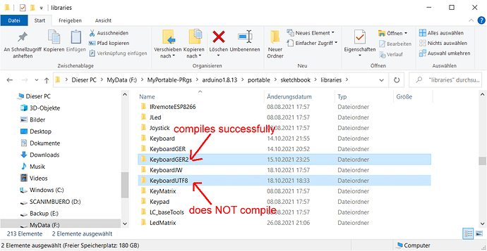

Please explain the steps you took to install it.
I used this method successfully for multiple GiPo-ZIP-libraries.
I downloaded the ZIP-file from GitHub.
On GitHub the filename is
grafik
I renamed this filename to
grafik

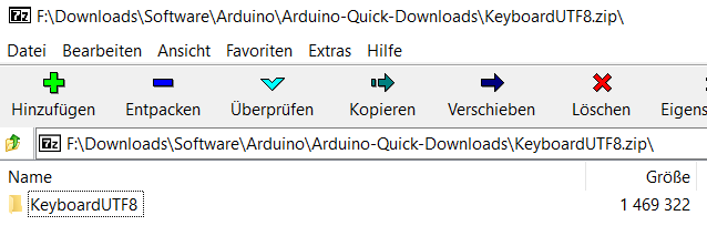

I opened the ZIP-file
renamed the folder inside the ZIP-file to match the Arduino-convention
foldername, *.h-name *.cpp-name and classname all four chall have the same
grafik

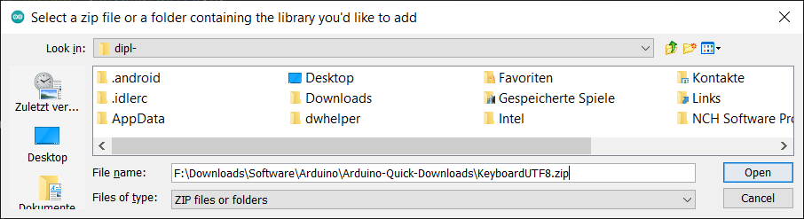

Then imported the ZIP-library
grafik
The Arduino-IDE successfully imported the library. At least shows a message
grafik

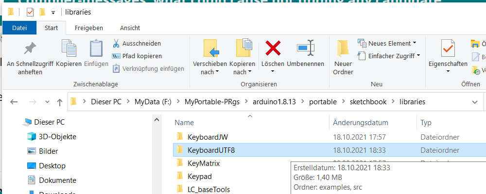

Checking it under include libraries show the matching entry
Checking with the explorer it shows the folder is there
And inside the folder it seems everything is there
Still the compiler complaints that he can't find the file
Now - what's wrong?
best regards Stefan

I narrowed down the problem to be caused by the library.properties-file
Step by step I copied the needed files into the library-folder as soon as I copied the
library.properties-file the error occurs. If I delete this file everything compiles.
Never have done anything with a library.properties-file
Does anybody see something strange what could cause this error?
name=KeyboardUTF8
version=1.0.0
author=JohnWasser
maintainer=JohnWasser <Arduino@John-Wasser.com>
sentence=Allows the Keyboard library to work with non-US keyboard layouts.
paragraph=This library layers over the Keyboard library.  It allows correct typing of strings on systems using non-US keyboards and also adds support for Unicode characters in UTF-8 format.
category=Device Control
url=https://github.com/JohnWasser/Arduino_KeyboardUTF8
architectures=*
best regards Stefan
What happens if you make the architecture specific instead of the *.
architectures = samd
with
architectures=samd
still the same error
with file library.properties error no such file or directory
without the file compiles
without file
So, delete library.properties and move on?
Leave the library.properties as it is.
Move the KeyboardUTF8.h and KeyboardUTF8.cpp files into the src directory of the library.
Apparently the assumption is being made that if there is a src folder, that the library files will be located there.
There is some technical information on this subject in the Arduino Library Specification:
https://arduino.github.io/arduino-cli/dev/library-specification/#source-code
This diagram made the situation more clear in my mind:
So you can see that there are two requirements for a library to be treated as having a "recursive layout":
  • Presence of the library.properties metadata file ("1.5 format" library)
  • Presence of the src subfolder.
If both of those conditions exist then the source files are searched for under the src subfolder of the library. Take either of the two away, and the root of the library folder is instead searched.
