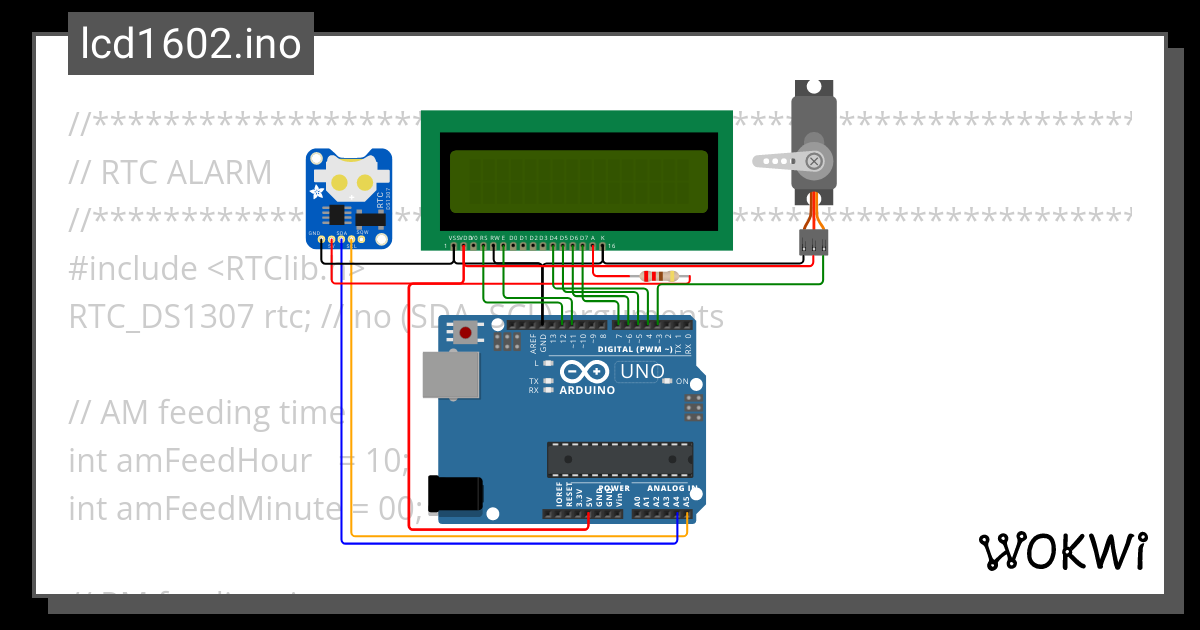

How can I adjust the servo duration?
The code works for 10 seconds or more. 5 seconds 10 seconds 11 seconds 15 second (ok.:slight_smile: )
But "4 seconds, 3 seconds 2 seconds" (nok :frowning: )
Sample : PetFeeder - Wokwi ESP32, STM32, Arduino Simulator
  // AM FEED THE CAT - AM Saatinde Yem Dökülme Zamanı 3 saniye ayarlı
  if ((now.hour() == amFeedHour && now.minute() == amFeedMinute) && now.second() < 15) {
    feedServo(); // feed now
  // PM FEED THE CAT - PM Saatinde Yem Dökülme Zamanı 3 saniye ayarlı
  if ((now.hour() == pmFeedHour && now.minute() == pmFeedMinute) && now.second() < 15) {

Please describe what feedServo() is meant to do.
What do you mean when you say less than a certain time in that expression fails? How does it fail?
Reading the code it looks like you are trying to keep the feeding servo from executing many backs and forths at the two feeding times.
Is that the problem you try to solve by making that time in seconds shorter?
a7
what you do is when you are within the first 15 seconds of a feed time
you call continuously feedServo(); which does this:
you move to 0° wait a bit (3s) and move back to 90°
you keep calling this repetitively until the 15 second window elapsed and as there are just a few microseconds between the myServo.write(90); at the end of the function and the next call to myServo.write(0); you don't see the servo moving back to 90 really - it tries but microseconds later it gets the order to stay at 0°. Then the 15 second window is finished and thus you don't call feedServo() anymore and so the servo has the time to really go back to 90°
➜ this is not a great way to handle things. You should not have to repeat orders to move between 0° and 90°, you should know when it's time to feed and then wait for some time (in an async way if you want the rest of the code to run and not have the time stuck whilst the delay() executes) and then move the servo back to its original position
I want the servo motor to run for only 3 seconds. Let it open and close in 3 seconds.
Should I write where 15 is written?
From there I can't type a number in under 10 seconds. Because it doesn't work.

did you understand what I explained above?
when it's time your code does this (5 iteration roughy for 15 seconds since you have a 3s delay)
write 0°
wait 3s
write 90°
write 0°
wait 3s
write 90°
write 0°
wait 3s
write 90°
write 0°
wait 3s
write 90°
write 0°
wait 3s
write 90°
as those writes in the sequence
write 90°
write 0°
are very close in time, the servo does not have time to move and so what you really see is like that
write 0°
wait 3s
wait 3s
wait 3s
wait 3s
wait 3s
write 90°
this is a crappy approach but if you want shorted feeding time you need to modify the 15s AND the 3s inside the function (the one in the function is the minimum wait time guaranteed)
I am trying to understand. This is for an automatic dog food.
Then how many seconds can I do minimum?
because the dog food will spill too much.
can you review it from here?
please answer
Yes, I understand a bit.
This is ready code but needs editing.
But I guess I can't do this.
Thanks.
You can't, yet, but it can be done.
Does it matter how fast the servo moves? Or just that it move, stay moved for a period, and then move back, however rapidly?
Do you want one such motion (swing from 0 to 90 and back) per feeding?
It is easy to make that happen just once, instead of happening over and over for 15 seconds. Besides which as you wrote it, and @J-M-L tires to make you see, the motion will be unsatisfactory.
Maybe you want a feeding to be
  (servo is at 0 by initial value and the logic)
then
  move servo to 90
  wait three seconds
  move servo back to 0 (leave it back at 0)
a7
Yeah, you have delay of 3 seconds in your feedServo() function.
