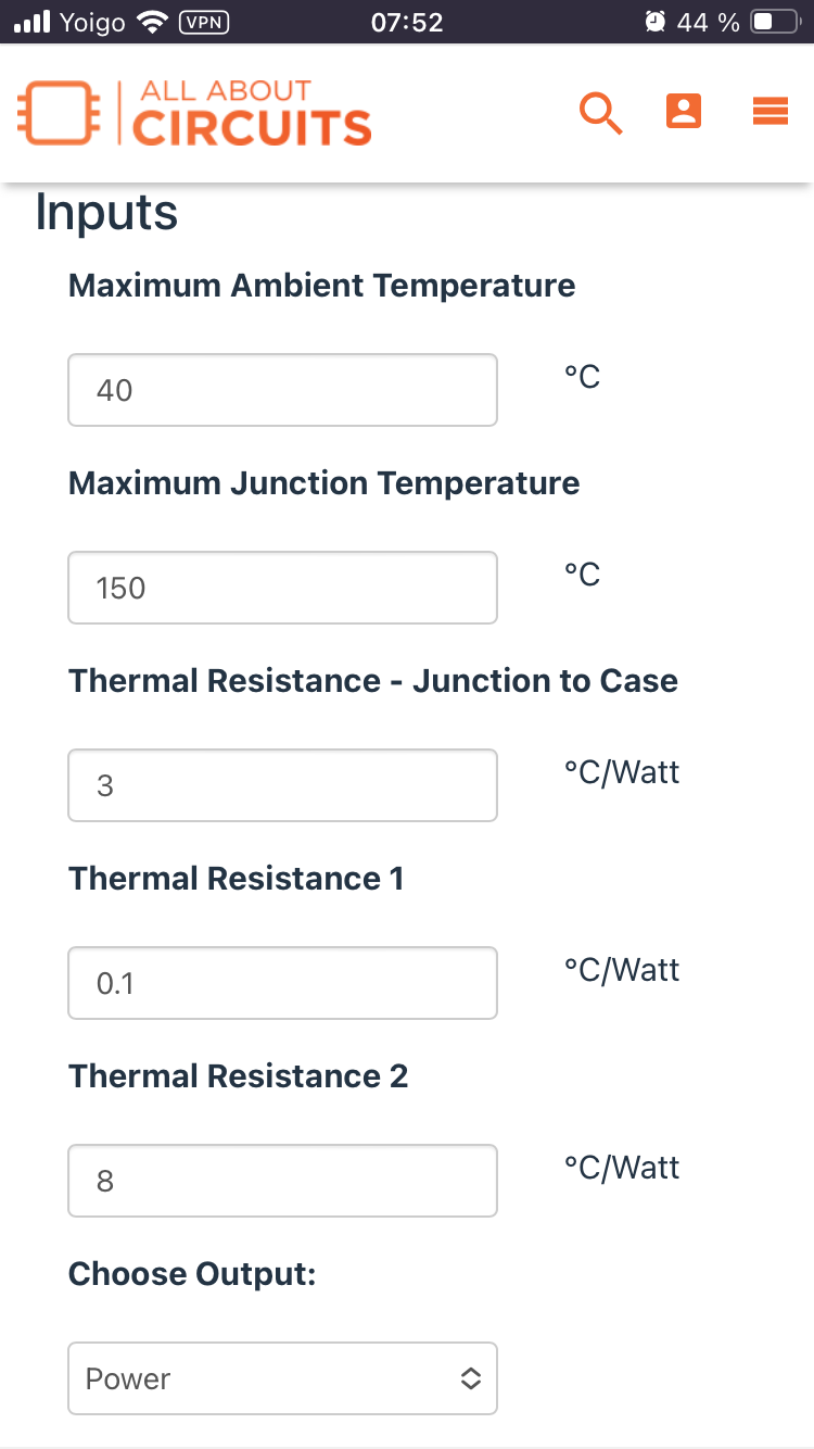

Even though equation somewhat is Fine (three thermal resistances are to consider), neither description nor formular implementation are consistent or correct.
Consider the attached example, for which a negative power is calculated :face_with_monocle:. And even the value itself is wrong
Values are samples following the figure (of the website showing heatsink and semiconductor) despite the fact that the figure is not calling for R1 or R2
Power should be 110/11.1 Watts

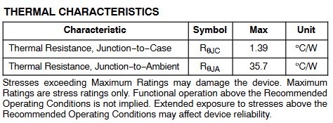

This datasheet?
That would seem sensible

From the data sheet, only Rth,JC is required provided you actually do use a heat sink
If you assume an ambient of 30C, let's say you find a max temp of 60C acceptable for the heatsink. At 4W this means a heatsink of at most 7.5K/W. Be conservative and pick something a little bigger, e.g. 5K/W. Try it out and if things still get too hot, improve airflow in your housing.
