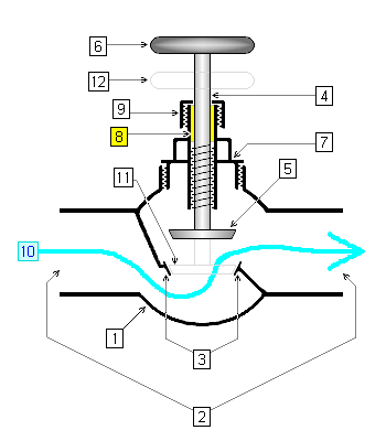

Twirap – The valve you show up above is called a globe valve. >>
Ball valves have a hole through the ball part of valve like this one >>
