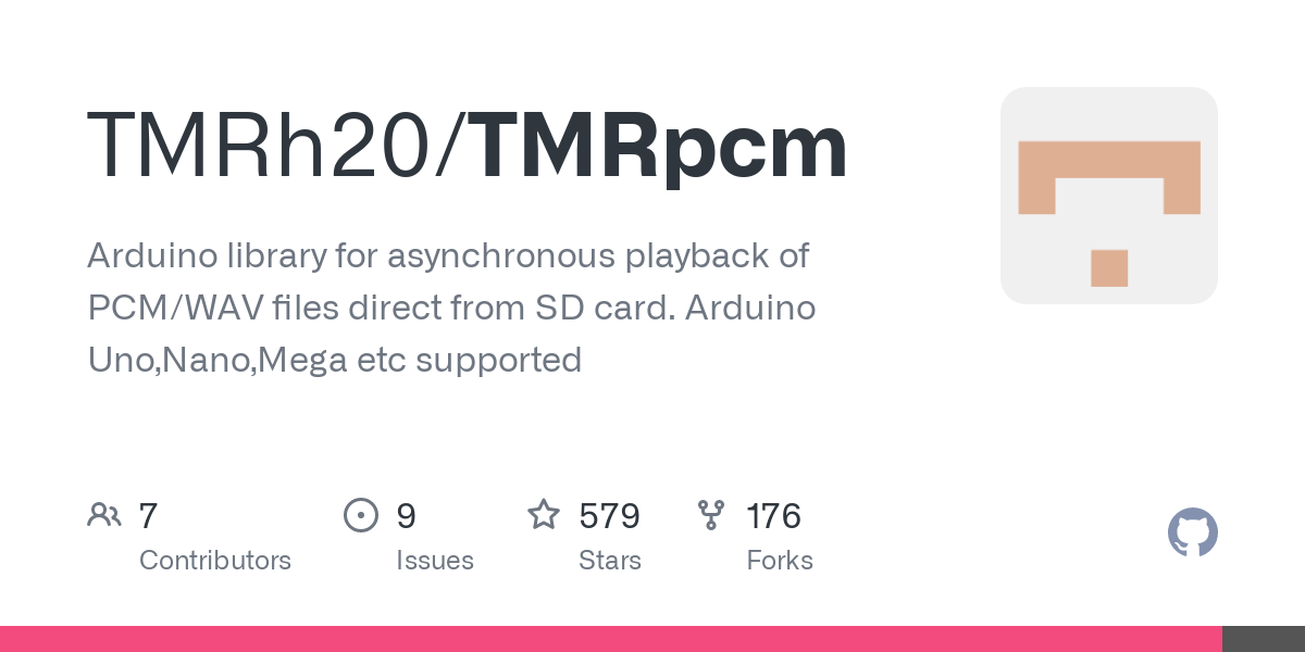

This will play more than one file but not sure if it does three:-
Sound quality is not important right now
I hope it is not important ever because you are not going to improve it.
Grumpy_Mike:
GitHub - TMRh20/TMRpcm: Arduino library for asynchronous playback of PCM/WAV files direct from SD card. Arduino Uno,Nano,Mega etc supported
Does it play more than one file with different speakers ?
No idea look at the code.
