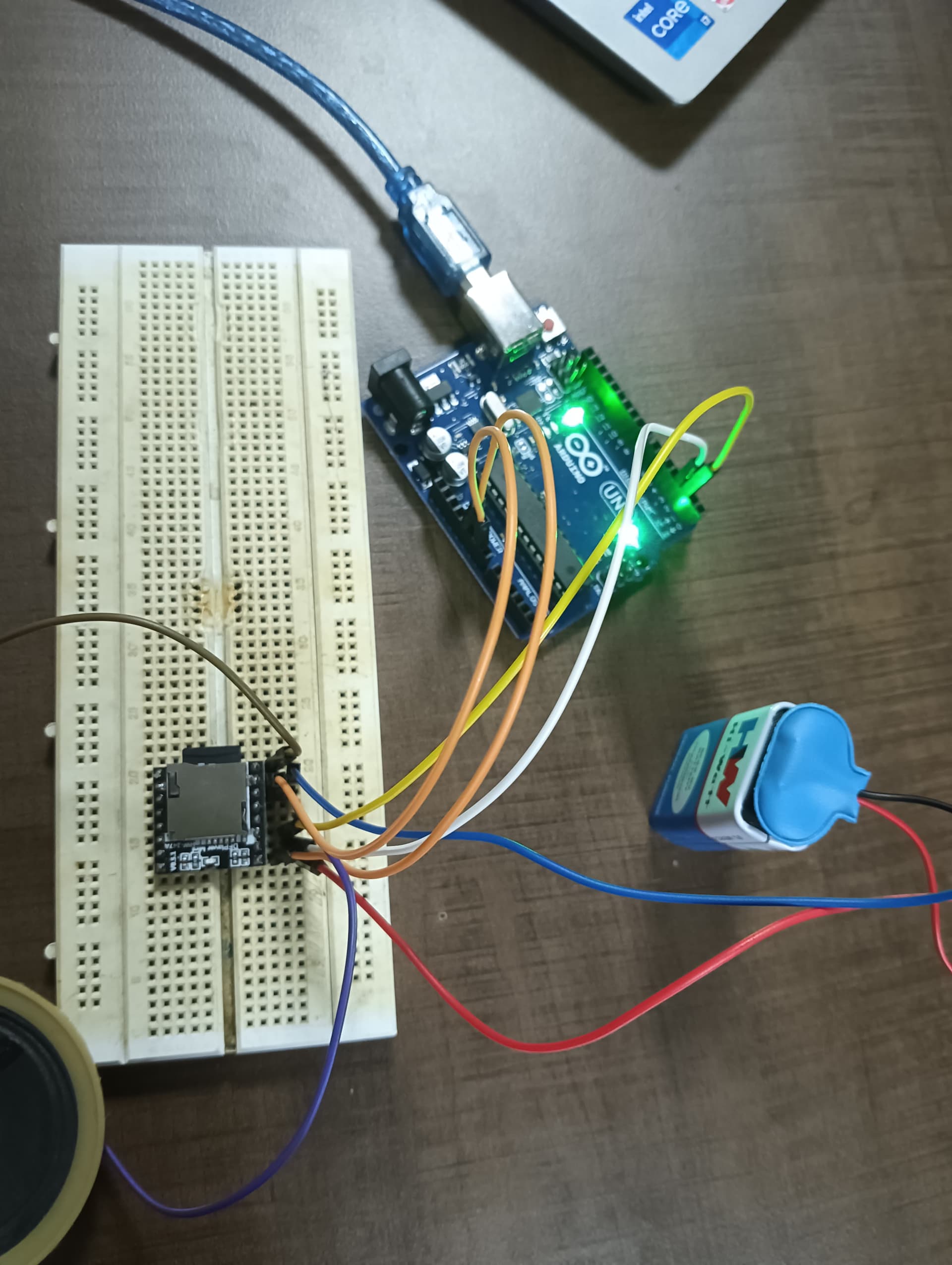

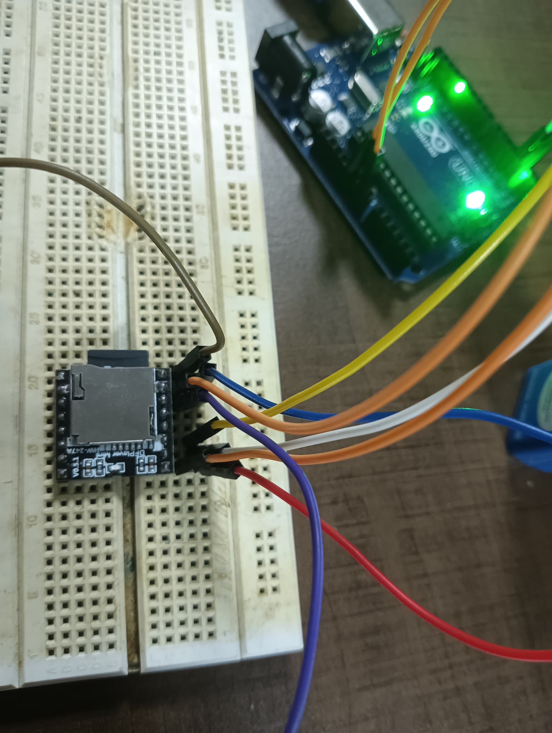

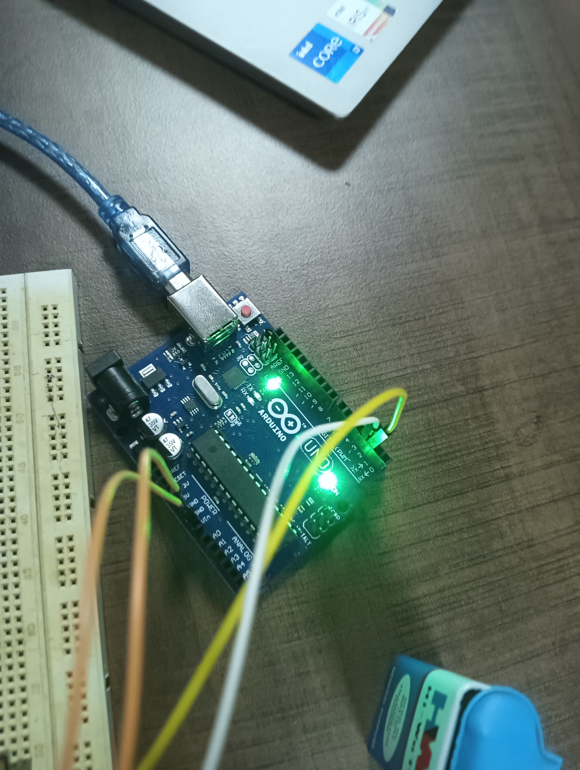

I'm making a project on gesture to speech using arduino uno r3,flex sensors,lcd,dfplayer(first copy)and a 8ohm/0.5w speaker.
Till now i didn't face any problems with connections till lcd but i cannot generate the sound from the speakers.I tried formatting the sd card,we have mp3 files too,added a 9v battery to circuit,checked all connections but still didn't work.It generated some kind of sound from speaker at the beginning but when we tried uploading the code it didn't work.Kindly suggest me some solutions or some alternative that is feasible and easy to use.This is the code-

You need to take another look at that wiring.
And the 9V is another point (in excess of spec.)

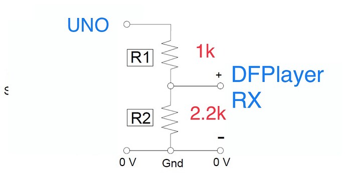

- The RX pin on the DFPlayer needs 5v to 3v3 level translation.

SD card should be formatted to FAT16 or FAT32. DFplayer supports only these formats.

Wire it like this --
 ![image](https://europe1.discourse-cdn.com/arduino/original/4X/9/d/b/9db37f3941bb345a1a093b3df19683b13eb13a45.jpeg)
no deviations.
(No 'amplification' required.)
