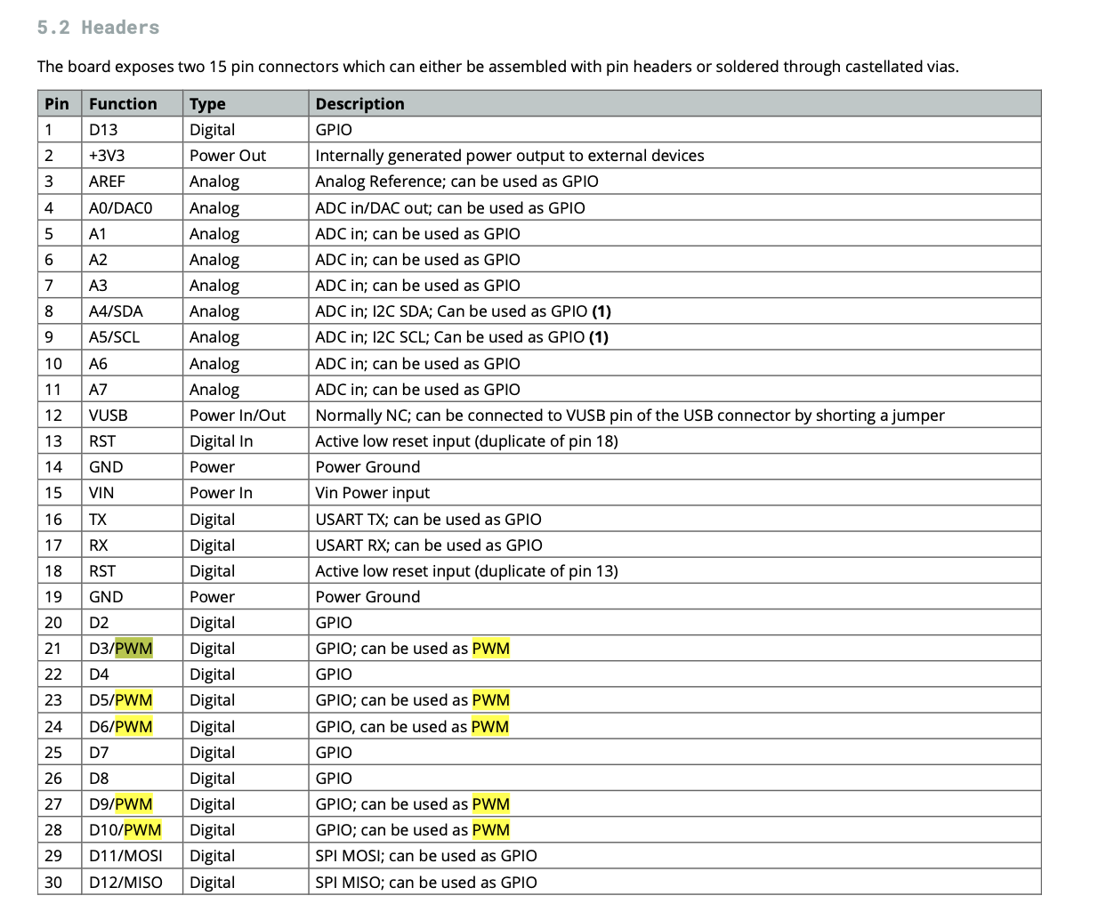

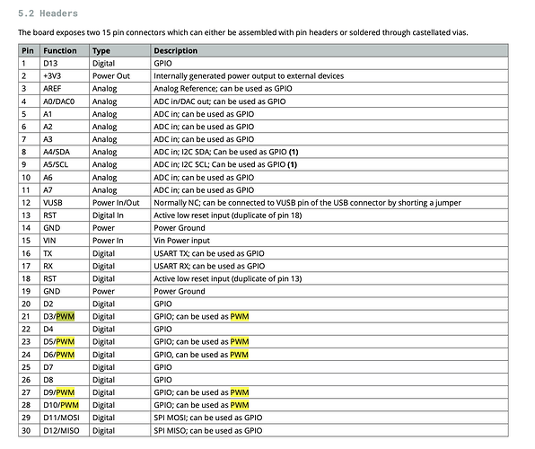

@omar9k I forgot, I also found the following in the documents mentioned on the web page for the board. There is a lot more there, but the link in my previous post does a better job of explaining, I think.
 ![Screenshot 2025-02-24 at 11.30.46](https://europe1.discourse-cdn.com/arduino/original/4X/8/b/d/8bdba48523c06b32c7fde9f0b0eb8c8275d068cc.png)
 ![Screenshot 2025-02-24 at 11.37.22](https://europe1.discourse-cdn.com/arduino/original/4X/d/0/d/d0d8b93c0f24ca29774037888b5557a7e4ef0ce3.png)

Thanks! The copy of the data sheet that I have has that table, but doesn't include the "finding PWM pins" section.
This doesn't help me confirm which pins can be used as interrupts, but at least the mistery of the tilde is solved.
> Here is the link
That discusses symbols for analog pins, `A0` thru `A7` and so on. I can't find definitions for the digital pin symbols you've told me to use, like `D2`
