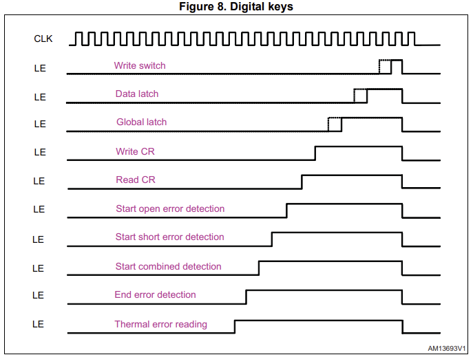

Context
I am working on a project which includes 13 cascaded STMicroelectronics LED1642GWs. These LED drivers are essentially 16bit shift registers, whereby the buffered serial data can be loaded to a number of different registers dependant on the required function.
The function is selected through the use of "digital keys", which is selected by number of CLK cycles for which the LE (CS/SS) pin is HIGH. For example, LE being HIGH for 1-2 CLK cycles will switch the 16 outputs as per the buffered bits, whereas LE being HIGH for 3-4 CLK cycles will load the 16 bits to a brightness register.
Digital Keys
Question
How can I toggle my LE/CS/SS pin for a specific number of SCLK cycles? I had intended to use the SPI Libary, however I'm not sure this can be supported.

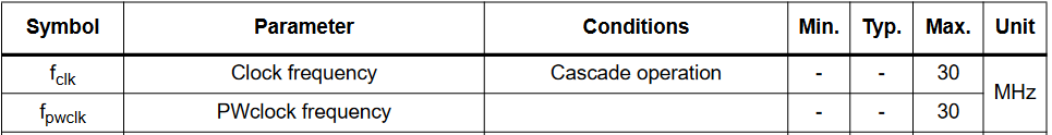

For my application I'll be looking to write out 16 bits, to each of the 16 outputs, on my 13 drivers, at minimum 100Hz so... like 42kBps by my reckoning? As I understand that's well under the 8MHz SPI minimum of most Ardunios?
To be honest I've always assumed that you couldn't be sure on the accuracy of your timings with standard digitalWrite()s etc. Any examples or reference you might recommend?
There's no minimum clock frequency ...

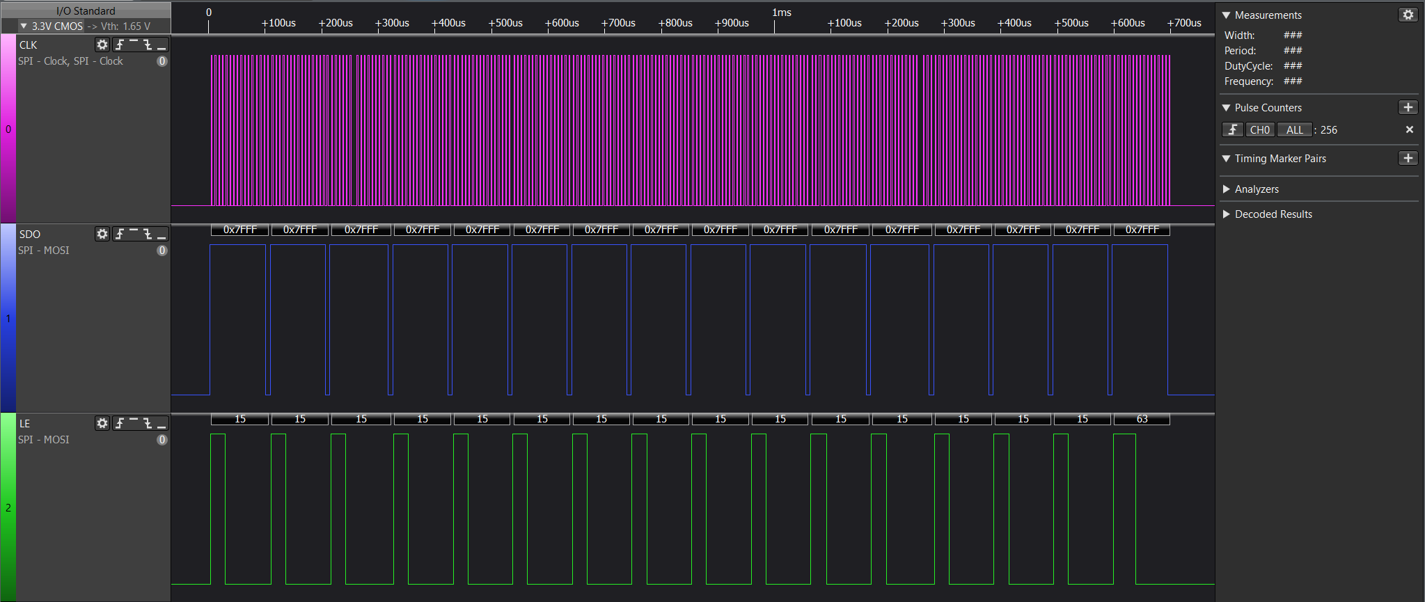

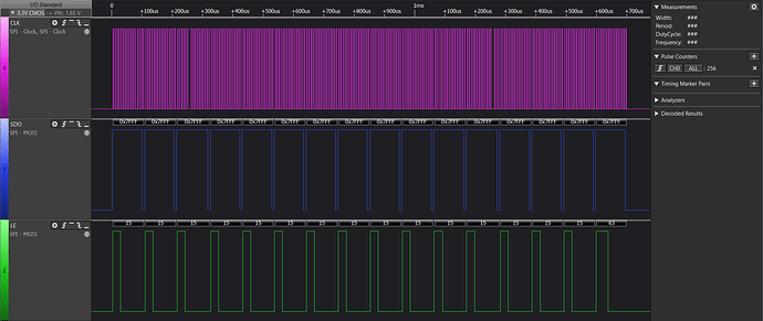

I used this to implement the sequence described within the data sheet (Figure 24. Brightness register setting) to set all of my 16 Brightness Registers to a half setting (0x7FFF) with a timed LE providing the digital key. This scoped out as:
Running on my Arduino Nano 33 IoT this clocked at 150kHz which is more than sufficient for my application.
