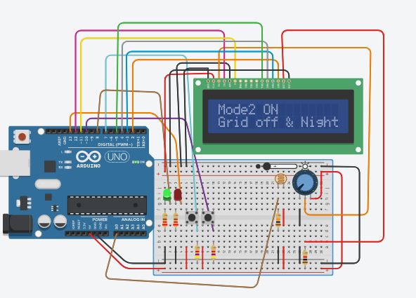

How can I stop messages from overlapping on LCD?
I am trying to save money on my Solar system by using the least amount of batteries possible. The system is for powering a freezer by day and by the Grid (when I want).
My program using an Arduino uno will operate in 2 modes: Mode 1 (Solar only); the load will be connected only if it is sunny. Mode 2 (Solar or Grid); the load will be connected at night if the Grid is present but disconnected if no Grid available.
The first push button will toggle the modes and the second will simulate the presence of the Grid.
My problem is the messages on the lcd are overlapping (Please see diagram). The “Mode2 Grid on and Night” message leaves behind the “t” when the second condition is true.
Any other observation/corrections on the code will be greatly appreciated.
Thanks for your anticipated response.
How about clearing the display before updating the display?
or, in this specific case, ensure that the phrase you write is long enough to clear the relics from the last write operation.
change:
lcd.print("No Grid & Sunny") ;
to:
lcd.print("No Grid & Sunny ") ; // note the trailing space !
See what happens when you change;
lcd.print("No Grid & Sunny");
to
lcd.print("No Grid & Sunny ");
Idahowalker:
I tried to do that but the screen started flickering.
6v6gt:
change:
to:
This did the magic! Thank you very much.

Create a function that accepts the text you want to display and returns a version of that text that is padded with spaces out to the number of characters in your display. That will avoid the flickering that comes with clearing the display between each write to the display.
