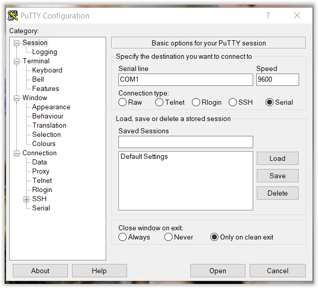

Same for Putty. Start it.
Choose Serial, right com port and right baudrate. Click Open. Then you have a terminal opened.
