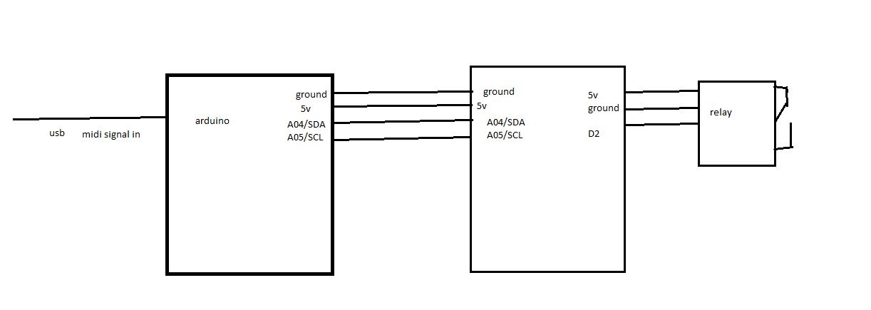

how can i use the midi signals.
i get how to use the "wire" library and the "midi" library seperatly, but when i try to combine the 2 im having issues. please help!
Attach wiring diagram and code.
this is the wiring diagram i have.
i have no idea what im doing lol
please help. HAALLP ![]()

For the moment the. JPG file does not open.
What is the purpose of the project? How is it intended to work? What does actualy happend?
Just asking for help does not tell what the issue us.
beensolo:
Does "I get how to..." mean that you have separate programs one of which successfully gets MIDI input and the other communicates something via Wire? If so then please post them.
And please give more details of what problems your current program has. Just saying you are "having issues" isn't very useful.
Steve
If I remember how that MIDI library works, the note handler function is an interrupt handler.
Try moving the wire.write() calls outside it. Set a flag instead and do the wire.write() in loop()
so i am using midi signal as input from hairless from computer. i posted this on a seperate post but people were saying to use spi and i2c or shift registers. im just totally new at this. i want to be able to control multiple relays and addressable leds with a midi signal either from a midi player or a music program like live or pro tools.

GypsumFantastic:
If I remember how that MIDI library works, the note handler function is an interrupt handler.Try moving the wire.write() calls outside it. Set a flag instead and do the wire.write() in loop()
can you go in to more detail? explain like im a 5 year old ![]()
