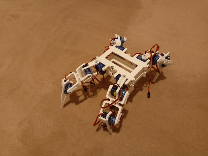

In this project the spider robot is controlled by at least 12x servos SG90 9G, and driven by an arduino nano

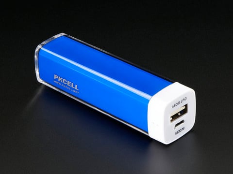

But as you can see the battery used is about like, what, max 3A output ( even 1A output with external power bank on the video I provide ) how is this even possible ?
Like the sg90 9g draw about 10mA at rest but can draw 500mA when stressed so even if we use a battery than can contain 10000mAh it still often provide max 3A at output for like power bank and is still not enough ( can damage the battery ? Even make it explose ? )
Maybe im lacking on power topic but I didnt understand
Also I saw people using 2x18650 battery in a holder ( with a DC - DC to stay at 5V ), is this a better solution to draw more current at time ?
But if yes, why power bank can't?

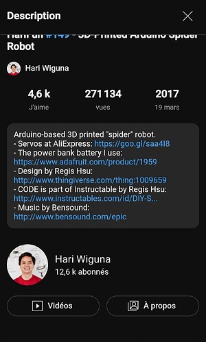

I don't think I confusing in fact in the video i send the Guy use this battery
That is clearly specified as a 1A output battery
Or Maybe I miss something ?

I watched the video and I didn't see him mention that he was using the Adafuit 5V 1A battery pack but maybe I missed it
The instructables webpage for the original design specifies a much more substantial battery
and uses a 3A regulator
Would probably be better to run the servos from a battery pack with the proper voltage for the servos and not use the regulator.
Yes it is in the description, maybe we dont talk about the same video

But actually in this robot the spider standing use current in stale no ?
I already mount it and he can stay stable (without the belly touching the ground ) if I balance the legs well
For now its not powered at all, so this position will consume current known as stale ? Or the servos can be set as off and still standing like that

I'm sorry, I missed that.

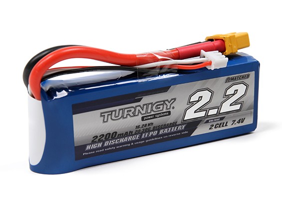

If you want to be sure to have enough current for all 12 servos stalling at the same time

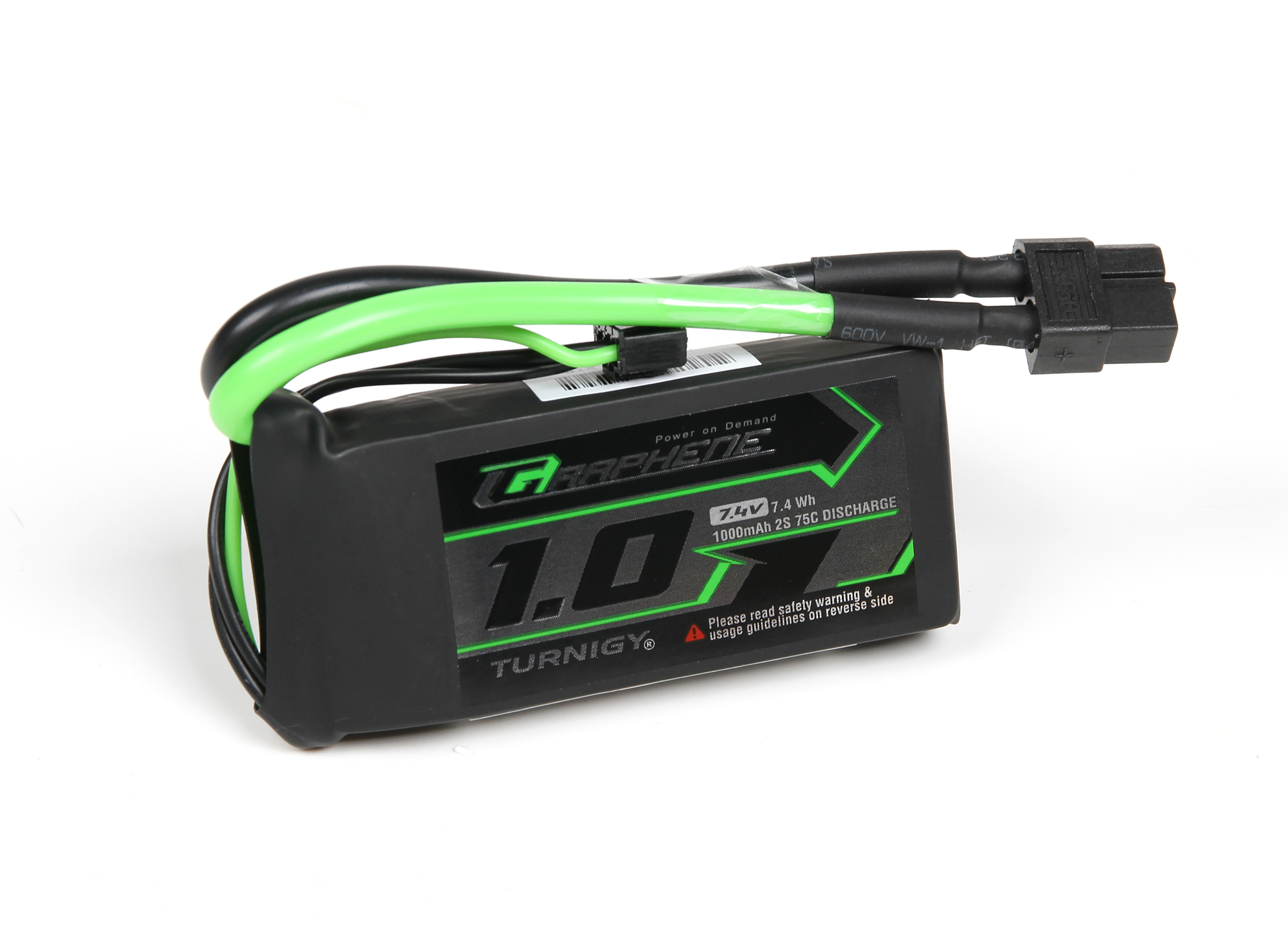

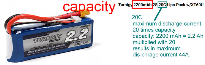

use a 2S Lipo that is optimised for race-drones
75C means the maximum dis-charge current is 1 Ah * 75 1/h = 75A
even a cheaper 1000 mAh Lipo like used in rc-airplanes has 20C which means maximum
dis-charge-current 1 Ah * 20 1/h = 20A
or if you take a 2S 2200 mAh 2.2Ah * 20 1/h = 44 A
So the limit will be the maximum current-rating of the DC-DC-stepdown regulator that transforms the 8.4V (fully charged to 7.7V total dis-charged) down to 5,0V
best regards Stefan

Yeah thats my actual think that it could not run except if all the servos aren't running at the same time ( so I suppose they don't )
But I'm not sure about that regarding the way the spider stay balanced on it legs and the way the belly stay above the ground ( when I say I belly I talk about the main body that will handle the PCB and the Arduino )

Most of the power banks have some kind of current limiting built in. A 1A power bank may turn off if you exceed say 1.25A
Also you don't want to use a big battery that may be too heavy to lift.

My overcurrent reference was only for USB type battery banks/power banks not plain batteries.
You can also use a fuse if you want, it can't hurt.
Personally I wouldn't buy a batery bank if the manufacturer did not specify if it had overcurrent proection.
The output-current is encoded in the nnC-value
The maximum current in in unit A (ampere)
on this RC-model Lipo-batteries is the C-value x capacity
example:
