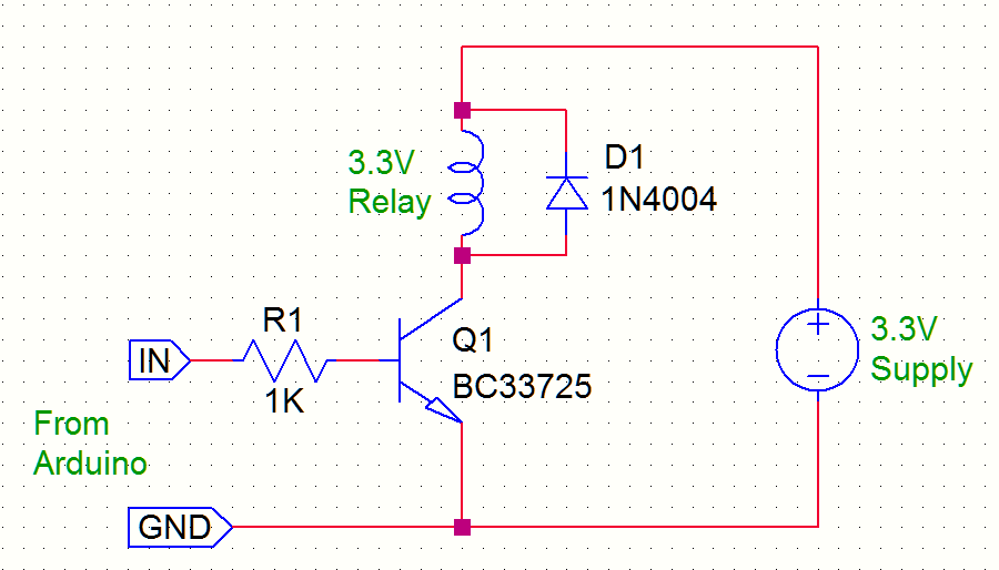

Make sure you buy a 3V relay, such as:
SRD-03VDC-SL-C
Wawa
July 16, 2023, 11:06am
5
Note that a 3volt sugarcube relay draws more current than a 5volt type. About 125mA vs. 75mA.
Don't you have 5volt available.
The 1k base resistor might not fully saturate that transistor when driven with a 3.3volt pin.
I would lower that to 470 ohm.
Leo..

thanks man, that's an important note. Does @jim-p agree with that suggestion (470 OHM) ?

Use the 470 like @Wawa said

you might want to add R2 = 10k , this keeps relay from 'twitching' when system boots
