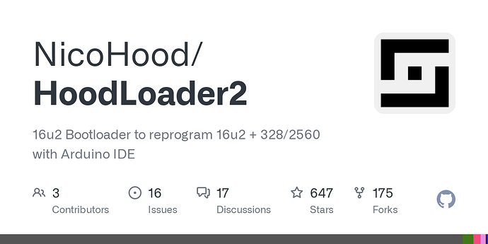

However, there's another problem - as far as I'm aware, there's no arduino core that supports writing a sketch for the atmega16u2... It's also not clear to me which bootloader you intend to write to it.
My first reaction is that you've picked up a project with some serious issues....
Here's the hardware package to add support to the Arduino IDE for ATmega16U2:
I found a bootloader or two but I am not sure how to upload that bootloader and then upload a different sketch (see my question below about that).
