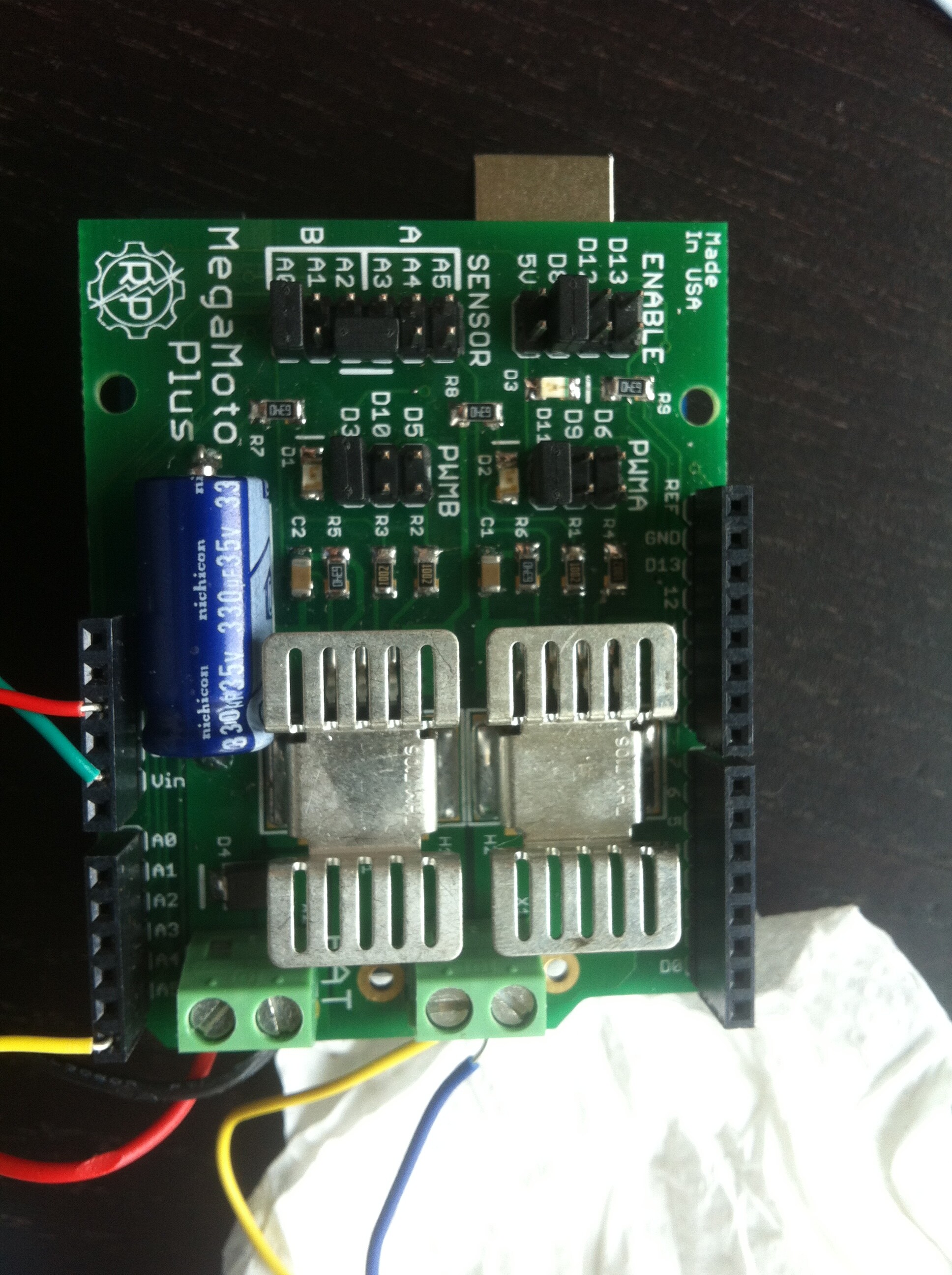

Can you perhaps make a photo of the jumpers and attach it, so we can check the Arduino pins you use.
The normal way for a H-bridge mode seems this:
PWMA to D11
PWMB to D3
ENABLE to D8
SENSOR : jumper between A3 and A2 and A0, see figure 3 and 4 in user manual.
I would write the code like this:
const int pinPWMA 11;
const int pinPWMB 3;
const int pinENABLE 8;
const int pinSENSOR 0;        // analog input
Set the mode of the pins, set one pin high, the other low, and see the motor run.
Change the high and low for the pins, and the motor should run in the opposite direction.

I am using the pins just as in the manual, and as you are describing.

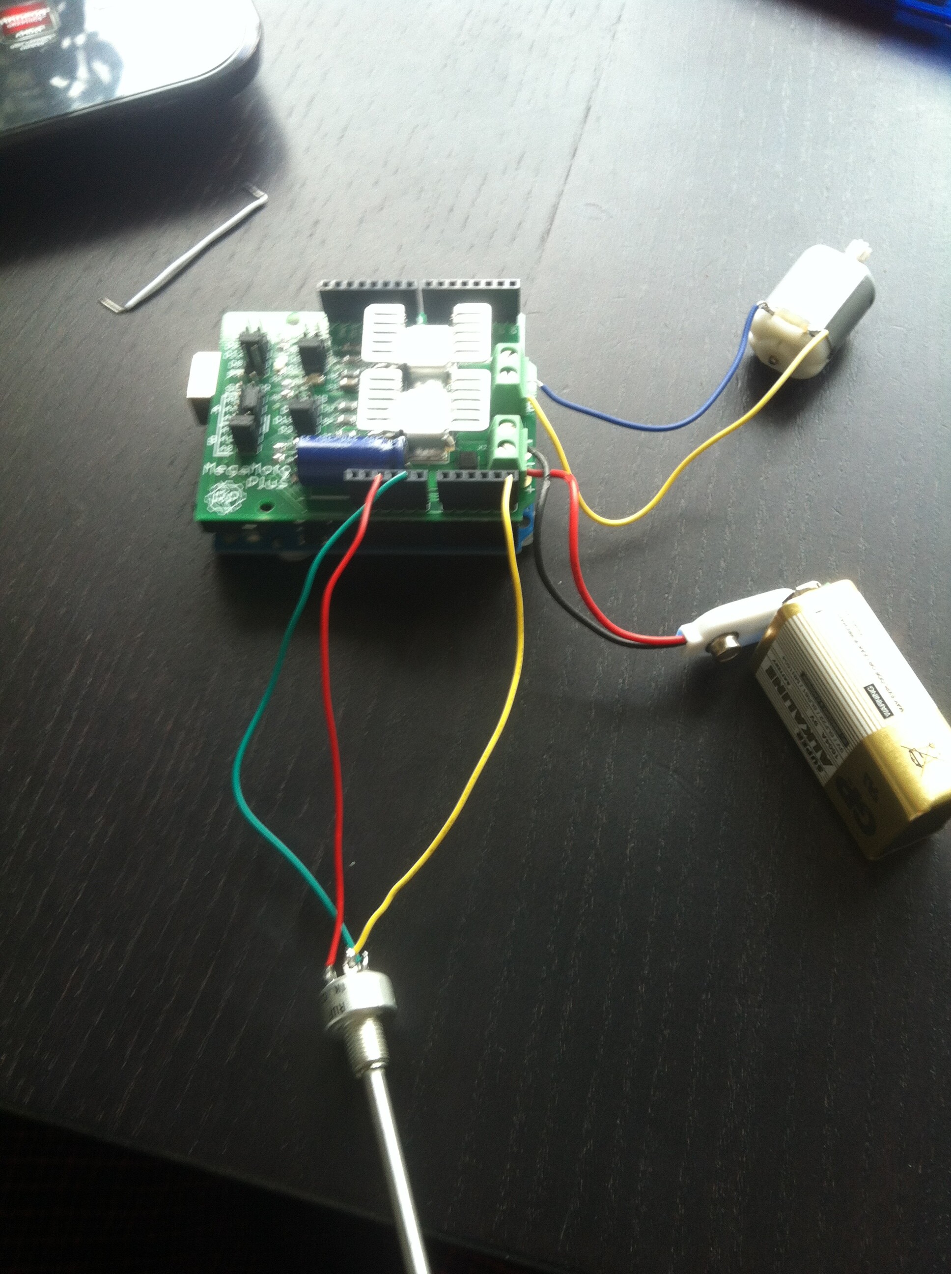

For now i have added a pot as the torque transducer (it easier to test with) and the motor connected is not the one i will be using (see previous post).
Thank you for your explanation.
I suggest to continue with a very small sketch, just to make the motor run in both directions and with PWM.
A function that controls the motor would be needed. Perhaps with an integer parameter from -1000 to +1000. The sign is the direction and '0' would be a 'stop'.
But first you have to get to know the MegaMotor shield. Just try a few things.
I don't know about using the current feedback. A PID and a current feedback will create a torque. So far I understand it, but I don't know how it will be if you actually use it for real.

I am still having problems with the motor switching direction a few times when i connect CW to 3.3V (change direction) before "settling " in the correct direction. as you can see in the sketch i have tried with adjusting the speed and full speed.
Also, when i get close to the pin with my finger, it does the same (switch direction) - do i need to add a pulldown or something to prevent that?
You are doing fine.
But I would like to make smaller steps.
Don't use any input for now.
Can you try this:
Make the motor run; wait some time; run motor in other direction. You have that almost. Perhaps you can make a function for it.
Make a sketch to test the inputs and write strings to the serial monitor like this : Serial.println("Input is now high");
Only after that make a sketch that combines both.
I don't understand how you use the 3 inputs, but if an input is not connected, it can be anything and (barely) touching it has a big influence. The impedance of the inputs is very high.

Of cause - i get it now.
After installing a button everything is working well.
Now i have control of the speed and the direction of the motor.
